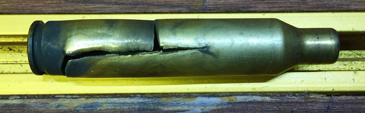

@RoterJager gets it... the specific incident of the rifle blowing up is quite irrelevant... There is an issue with PRS style matches that is very evident. Take a few minutes and watch some video or posted pictures from any major match. If you don’t see people being flagged and people breaking the 120/180 rule then I would be surprised. It didn’t take long to find these surfing the PRS FB video and picture posts. Seasoned PRS shooters are completely numb to it. People coming into this sport from other shooting sports are very surprised by it. I love this sport and the people in it. It’s a truly wonderful thing. Unfortunately I see a major problem that I am trying to correct before someone gets hurt.
Those are great photos.. I could post some as well that I took, even AFTER I told the shooters several times to correct their behavior and a stage later or two they are doing the same. I've seen some stupid shit, but it is just plain disrespectful the way some squads behave when asked to tighten up for safety concerns. I've been the guy asking guys in another squad to get their shit together and always meet with less than a thank you and often mockery. This is NOT PRS specific..
If you look a bit on youtube, you can find video of guys promoting their shooting skills during a match and see some of the same risky behavior or safety violations.
Not often discussed is the reality of an ND, even if someone is not hurt in a match, the club or range could be at risk and shut down because a round clears all berms and ends up 2 miles away in a school or home.
BTW the MD, by NOT actively enforcing risky behavior, could be found at fault.. NOT a good place to put yourself.

Well i felt i should address at least some of the comments made on this thread, number one being the rifle blowing up. This isn't second or third hand information as I was the guy who pulled the trigger. ill give a brief description of the events that transpired and my thought process while working through what i initially thought was a run of the mill malfunction.
Last stage of the day for me, started off with a great day one and a terrible start to day 2, i only say this to further depict my mindset during the aforementioned events.
COF called for 12 shots, 6 positions, 2 shots each, i made it through the first 3 positions skipping the 4th not to get hung up on time, once i knelt down and got behind my rifle on the barricade, i pulled the trigger, and nothing happened, because the rifle was supported on the barricade it stayed in my shoulder pocket and i simultaneously ran the bolt and removed the mag. in doing so i saw a live round fall out of the magazine well area ( later realizing that this live round was stripped from the magazine and not the chamber) I rotated the rifle over 45 degrees and visually inspected the chamber, chamber was clear (obviously i cannot look into the bore from this position) i re-inserted the mag chambered a round which was hard to seat (ill describe lower why i thought this wasnt an issue) got back on target then promptly got blown back 180 degrees on my hands and knees. Initially i thought my face was gone, and RO's and people around me can attest to this because that was the first words out of my mouth, "is my fucking face gone?" was my inital question. Once i Knew that my face was intact i stood up and wiped the blood from my face (gun powder lodged in it), and proceeded to try and understand what had just occurred.
WHY? why did the above happen to me, and why did I act the way that i did?
First and foremost, throughout the match i recall having 6-8 rounds that were hard to chamber, whether it being a headspace issue or a differentiation in bullet seating depth, or variances in bullet length i do not know as those rounds were fired successfully.
Secondly the weather conditions we experienced on day two was on and off rain and gusting winds at time, I like everyone else have experience that in wet and dusty conditions actions will bind and have trouble feeding without any regularity or predictability.
Thirdly in the process of performing a remedial action to get the gun back up and running, i stripped the mag and a live round fell out, at the time i believed this to be the "problem" round and visually inspected the chamber noting nothing as it was clear and free of any debris, obstruction.
After the gun blew up and we started investigating the cause of said anomaly, it was determined that a round without propellant seated the bullet into the lands far enough for me to be able to load another round behind it. it was a squib for sure as both bullets are still in the barrel.
Obviously there's a bunch of lessons learned here and i consider myself very lucky to not be maimed or dead. ill leave you guys to discuss what i've written and answer any questions as best as i can. The only issue i take is anyone saying they could've stopped what occurred to me, you'd have to be some sort of genie to tell me what was about to happen, and if you could of and didn't, We'll have an even bigger issue.
-Luke

Shit happens fast -- the image below was 100% my fault as I grabbed a round next to me while on glass and spotting for others.. The selfie I took about 8 hours later, but at the time hundreds of tiny holes where leaking blood and my face was covered. Luckily I was wearing glasses.
-Luke
-Luke
I still cringe when I remember seeing you on the ground behind the barricade. Thanks for telling it from your perspective here, as it may well save someone in the future from the same thing happening to them.
Not saying I’ve seen everything, but how can a round be chambered after prior bullet got stuck in the lands?
I’ve blown pistols up on the clock by being too focused on next shot to process the definite difference in sound a feel the squib round had, but a bottleneck boltgun cartridge should exihibit a real notable difference if a round is fired that doesn’t leave the barrel.
@LH Gina: I never meant to infer that AZ has slipped standards in any way, actually the opposite.
Primer alone sent it deep enough that the next round's OAL barely had to push on the base of the lodged bullet to go into battery.

I dont know how but it did, i didn't hammer the bolt closed or anything to that affect it was difficult to close but not beyond the norm, handguns are good bit different because well, they are in your hands a 20 pound rifle sitting on a barricade with a 265 pound guy behind it, i neither felt anything, nor heard anything other than a "click" which lead me to believe that it was a dead primer.

All depends on how deep that projectile got into the lands. It can get just the right distance in where the next round hits resistance that can be overcome (bullet shoved deeper in case) without stopping it from chambering entirely.
I wonder if it is possible that, after the squib went it's small distance then you are running the bolt, then when the new bullet hit the squib if was just pushed back into the case.
