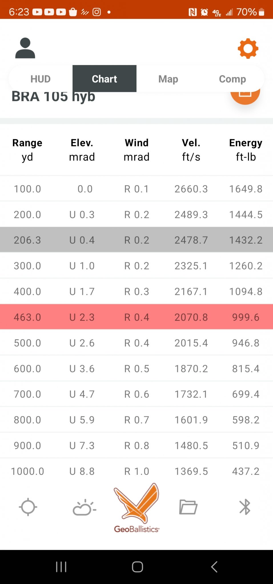

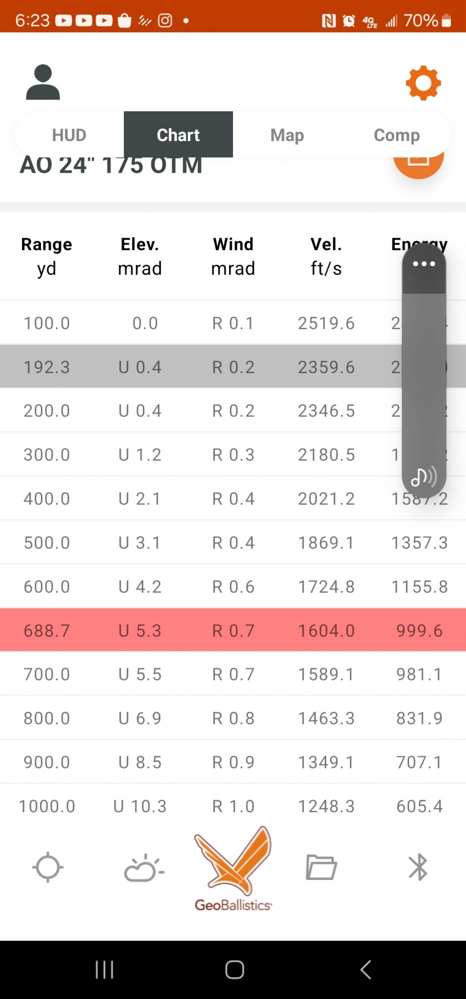

My data between my 105 Hyb at 2850 out of my 6BRA and the Bergers 175 OTM, at like 2700 are crazy close, not as bad as one thinks, this is with a 5mph full value wind.
