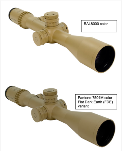

    These illustrate the common question as to differences in color options. Screen Shot 2017-09-17 at 7.51.28 AM.png
    thanks for the support. Happy to help, and good to see the other comments. I was getting confused, as I was seeing multiple types of "MTC" and other, and the actual catalog helped in the descriptions, but unfortunately, the nomenclature did not change between several of the turrets in 2017. I suspect their "VIN" like model numbers take it even further. Leave it to the Germans. I think I see the same sort of "it is understood" when I visit the Mercedes showroom... The cars gon't realize that 5 scopes can buy a nice ride. :(
