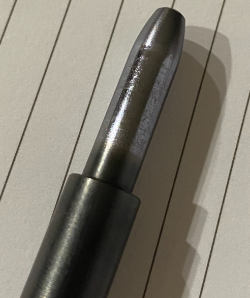

The carbine "black" nitrided one needs lube too. After 100 cases the nitride coating looks like this. Works just fine but I am using the Moly/Media from them.
