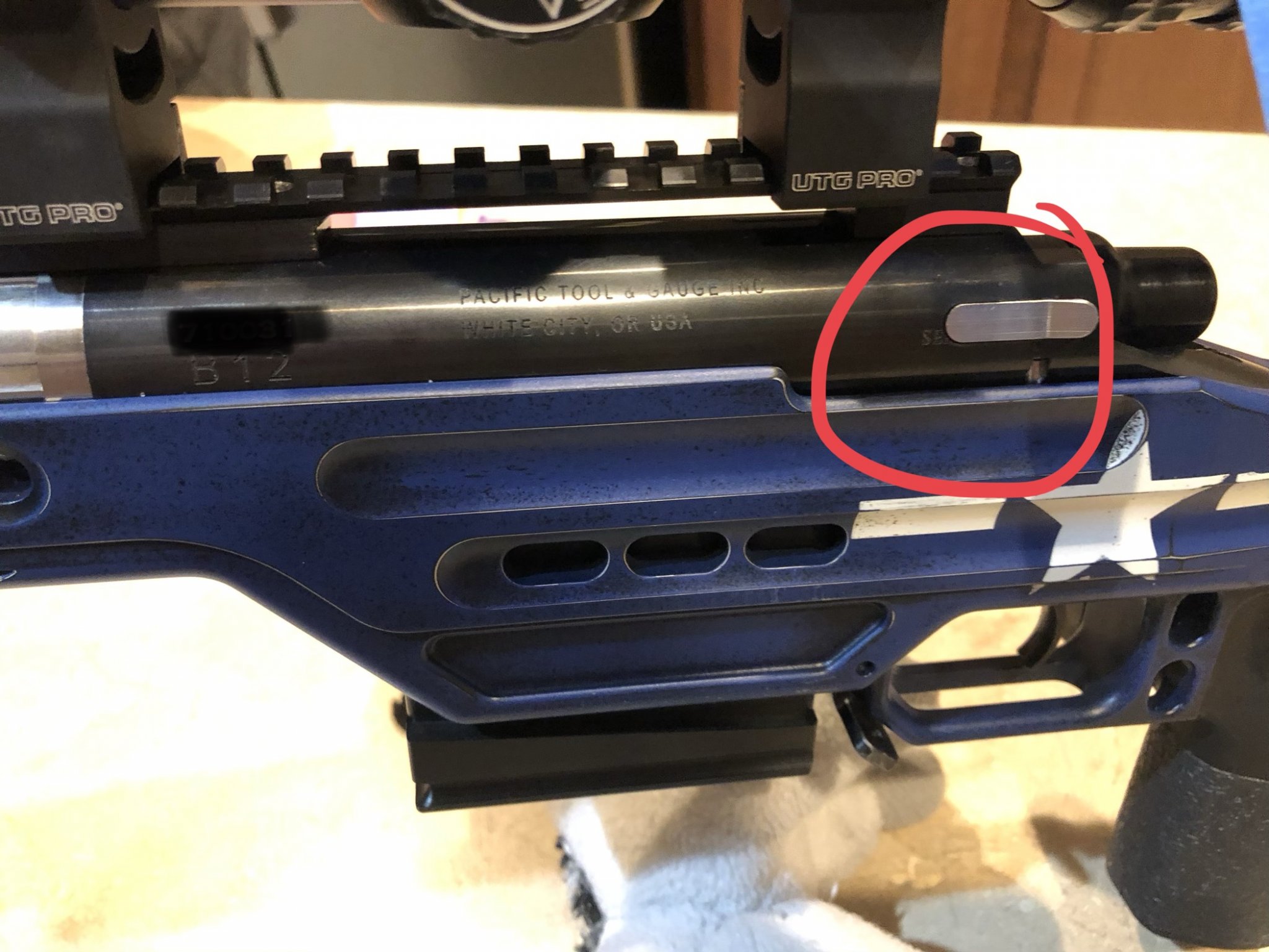

I have a B12 and highly recommend getting something else, like the Origin.
The SN is in the wrong place and has to moved, if you want an external bolt release.(see pic)
Also, the action is threaded for 6-48 scope mount screws, plus the mount is proprietary.
Not to mention the heavy bolt lift....my Origin has me spoiled.
I could have purchased another Origin for price of the PTG and plus work performed by Kampfeld Customs(pinned lug, 8-40 mount holes, side bolt release, & SN relocation)
