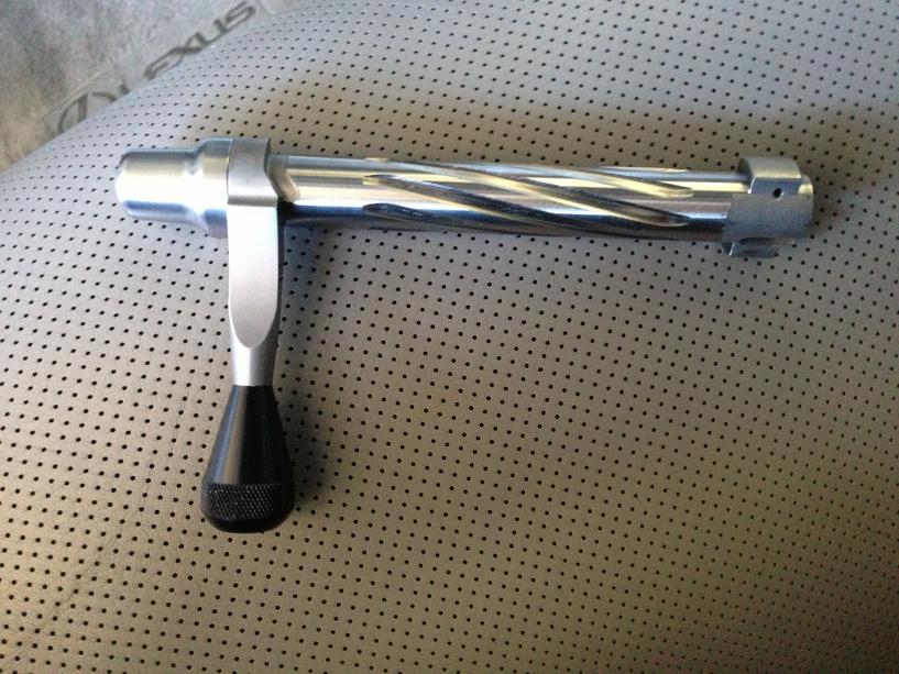

I have two of the spiral fluted bolts for Savage. The consistency is very good although the flutes are very shallow. As for Diameter, they make them .002 smaller than reciever ID. .002 makes them a lot tighter than factory, but gives enough play for debris etc. I don't believe that there are any other fluting options other than spiral.

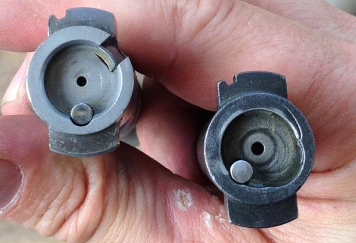

i wish i went with the smaller hole... and bigger flutes...
Reason for wanting the small firing pin hole instead of standard?
I'm assuming you want bigger flutes for aesthetics? You don't have any drag or feeling like the bolt is hanging due to the flutes? They don't have any sharp edges or anything? (sorry lots of questions)
You need to call your gunsmith and find out how big they ream the action to, then you can make a decision on what size the bolt needs to be. I would ask them what they suggest for clearances and go with that personally.

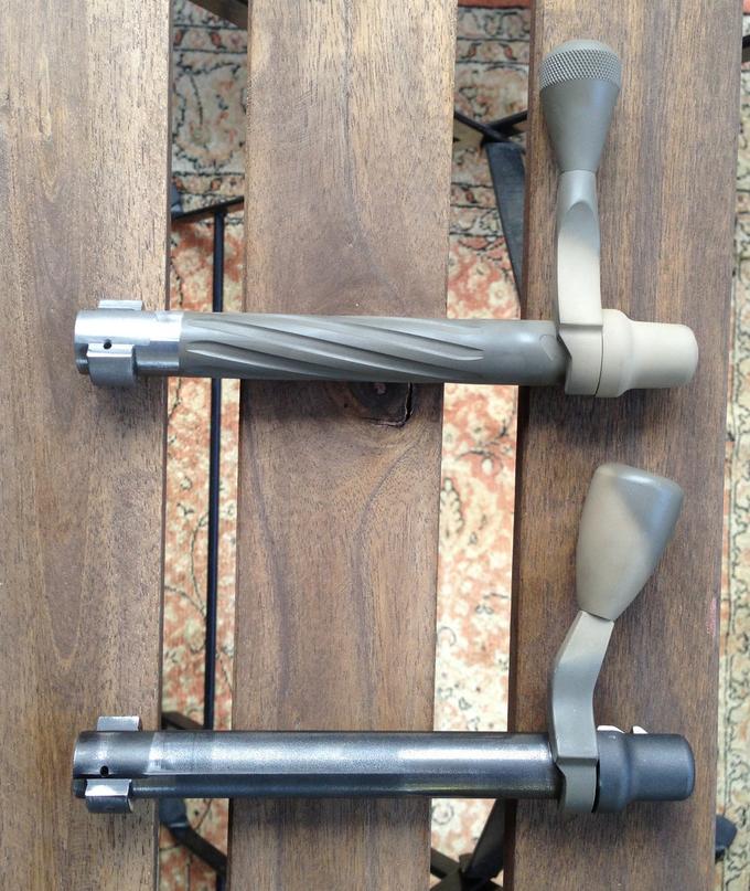

I just replaced the stock Remington 700 SA bolt with a PTG one piece with standard OD and boltface for .308 with the Sako extractor. I also went with the small firing pin. The stock bolt cracked at the extractor and it was a good excuse to upgrade. The fit is much better, as to be expected, and accuracy seems to have improved. I Duracoated the bolt after having it fitted by my gunsmith and fit and operation are flawless.
