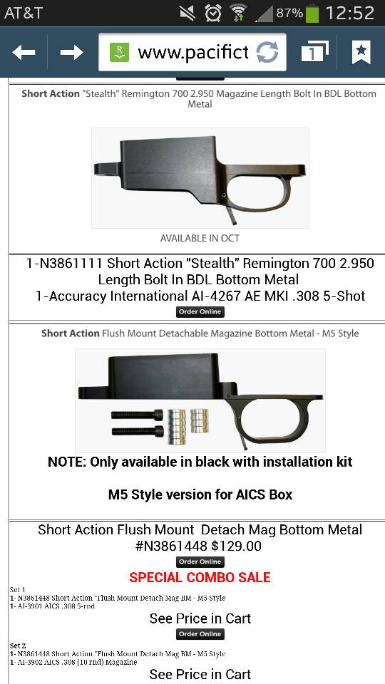

Just to update...the BDL drop ins are listed on PTGs website and it says you can order them in October. (I hope they mean October 1st!)

PT&G has updated their site with more detailed info.
Short Action "Stealth" Remington 700 2.950 Length Bolt In BDL Bottom Metal is: Part# N3861111
Magazine to use in the BDL DBM is: AI-4267-R Universal Mag
