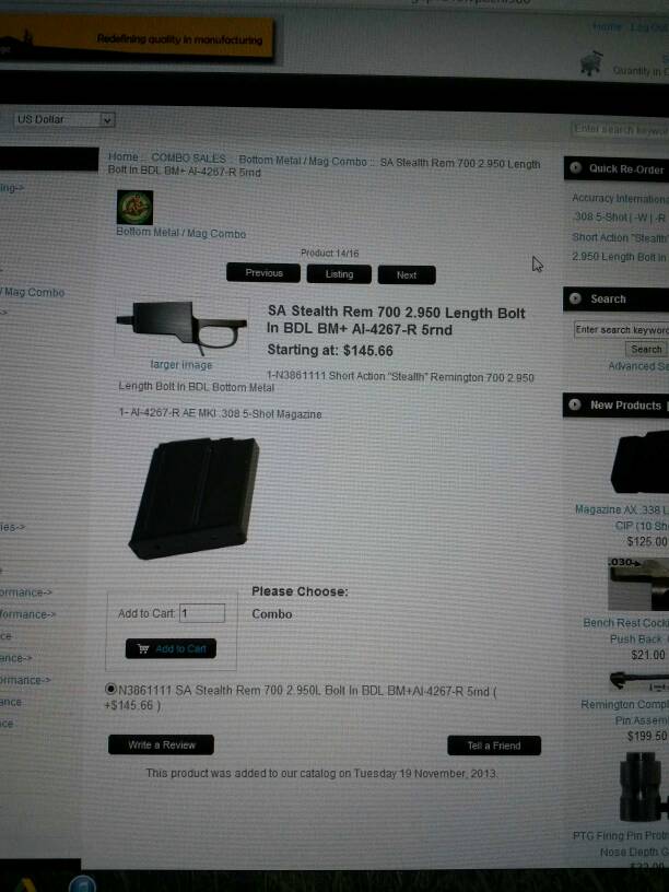

That's cheaper than online. Bottom metal is 129 and the mag is 71 according to their site.I called yesterday 11-11-13 and Ordered the 700 BDL drop in Combo with 5 round mag. Michelle said it would ship by Friday and cost was around $170
Subscribearray:40 [ "versionId" => 2021672 "version" => "2.2.16" "app" => App {#2 #container: Container {#10 #data: array:184 [ "time" => 1732434862 "time.granular" => 1732434862.0859 "app.classType" => "Pub" "app.defaultType" => "public" "config.default" => array:50 [ …50] "config.file" => "/mnt/db1/nvme_storage/production/www.snipershide.com/shooting/src/config.php" "config.legacyFile" => "/mnt/db1/nvme_storage/production/www.snipershide.com/shooting/library/config.php" "config" => Closure {#11 …5} "jQueryVersion" => "3.5.1" "jsVersion" => Closure {#12 …5} "avatarSizeMap" => array:5 [ …5] "editorToolbarSizes" => array:3 [ …3] …172 ] #cache: array:76 [ …76] #cacheable: array:184 [ …184] #factory: array:20 [ …20] #factoryObjects: array:7 [ …7] } #preLoadShared: array:26 [ 0 => "addOns" 1 => "addOnsComposer" 2 => "autoJobRun" 3 => "bbCodeMedia" 4 => "classExtensions" 5 => "codeEventListeners" 6 => "connectedAccountCount" 7 => "contentTypes" 8 => "displayStyles" 9 => "helpPageCount" 10 => "languages" 11 => "masterStyleProperties" 12 => "nodeTypes" 13 => "options" 14 => "paymentProvider" 15 => "reactions" 16 => "reportCounts" 17 => "simpleCache" 18 => "smilies" 19 => "unapprovedCounts" 20 => "userBanners" 21 => "userTitleLadder" 22 => "userUpgradeCount" 23 => "widgetCache" 24 => "widgetDefinition" 25 => "widgetPosition" ] #preLoadLocal: array:13 [ 0 => "bannedIps" 1 => "bbCodeCustom" 2 => "discouragedIps" 3 => "forumTypes" 4 => "notices" 5 => "noticesLastReset" 6 => "routeFilters" 7 => "routesPublic" 8 => "styles" 9 => "userFieldsInfo" 10 => "threadFieldsInfo" 11 => "threadPrefixes" 12 => "threadTypes" ] #updateCsrfCookie: "GP6kh1JJ2dLca1CQ" #isServedFromCache: false } "request" => Request {#233 #filterer: InputFilterer {#234 #stringCleaning: array:67 [ …67] #fullUnicode: true } #input: array:1 [ "/shooting/threads/ptg-bolt-in-bdl-dbm-for-remington-sa_187009/page-2" => "" ] #files: [] #cookie: [] #server: array:39 [ "USER" => "production" "HOME" => "/home/production" "HTTP_CF_CONNECTING_IP" => "3.145.7.187" "HTTP_REFERER" => "https://snipershide.com/shooting/threads/ptg-bolt-in-bdl-dbm-for-remington-sa.187009/page-2" "HTTP_CONNECTION" => "Keep-Alive" "HTTP_CF_VISITOR" => "{"scheme":"https"}" "HTTP_CDN_LOOP" => "cloudflare; loops=1" "HTTP_ACCEPT" => "*/*" "HTTP_X_FORWARDED_PROTO" => "https" "HTTP_CF_IPCOUNTRY" => "US" "HTTP_ACCEPT_ENCODING" => "gzip, br" "HTTP_USER_AGENT" => "Mozilla/5.0 AppleWebKit/537.36 (KHTML, like Gecko; compatible; ClaudeBot/1.0; [email protected])" "HTTP_HOST" => "www.snipershide.com" "HTTP_X_FORWARDED_FOR" => "3.145.7.187" "HTTP_CF_RAY" => "8e77d49f9f8561f2-ORD" "REDIRECT_STATUS" => "200" "SERVER_NAME" => "www.snipershide.com" "SERVER_PORT" => "443" "SERVER_ADDR" => "144.168.44.98" "REMOTE_PORT" => "" "REMOTE_ADDR" => "3.145.7.187" "SERVER_SOFTWARE" => "nginx/1.18.0" "GATEWAY_INTERFACE" => "CGI/1.1" "HTTPS" => "on" "REQUEST_SCHEME" => "https" "SERVER_PROTOCOL" => "HTTP/1.1" "DOCUMENT_ROOT" => "/usr/share/nginx/sites/production/www.snipershide.com" "DOCUMENT_URI" => "/shooting/index.php" "REQUEST_URI" => "/shooting/threads/ptg-bolt-in-bdl-dbm-for-remington-sa.187009/page-2" "SCRIPT_NAME" => "/shooting/index.php" "CONTENT_LENGTH" => "" "CONTENT_TYPE" => "" "REQUEST_METHOD" => "GET" "QUERY_STRING" => "/shooting/threads/ptg-bolt-in-bdl-dbm-for-remington-sa.187009/page-2&" "SCRIPT_FILENAME" => "/usr/share/nginx/sites/production/www.snipershide.com/shooting/index.php" "FCGI_ROLE" => "RESPONDER" "PHP_SELF" => "/shooting/index.php" "REQUEST_TIME_FLOAT" => 1732434862.0859 "REQUEST_TIME" => 1732434862 ] #skipLogKeys: array:1 [ 0 => "_xfToken" ] #cookiePrefix: "xf_" #remoteIp: "3.145.7.187" #robotName: "" #fromSearch: false } "uri" => "/shooting/threads/ptg-bolt-in-bdl-dbm-for-remington-sa.187009/page-2" "fullUri" => "https://www.snipershide.com/shooting/threads/ptg-bolt-in-bdl-dbm-for-remington-sa.187009/page-2" "time" => 1732434862 "timeDetails" => array:6 [ "tomorrow" => "1732510800" "now" => 1732434862 "today" => "1732424400" "todayDow" => "0" "yesterday" => "1732338000" "week" => "1731906000" ] "debug" => false "development" => false "designer" => false "visitor" => User {#310 #_getterCache: array:1 [ "PermissionSet" => PermissionSet {#323 …5} ] #_valueCache: array:3 [ "is_moderator" => false "is_banned" => false "is_admin" => false ] #_structure: Structure {#297 +shortName: "XF:User" +contentType: "user" +table: "xf_user" +primaryKey: "user_id" +columns: array:54 [ …54] +relations: array:19 [ …19] +getters: array:68 [ …68] +defaultWith: array:1 [ …1] +options: array:8 [ …8] +behaviors: array:1 [ …1] +columnAliases: array:1 [ …1] +withAliases: array:1 [ …1] } #_em: Manager {#294 #db: Adapter {#223 #statementClass: "XF\Db\Mysqli\Statement" #config: array:6 [ …6] #fullUnicode: true #inTransaction: false #savePointCounter: 0 #savePoints: [] #queryCount: 40 #logQueries: false #logSimpleOnly: null #queryLog: [] #ignoreLegacyTableWriteError: false #schemaManager: null #connection: mysqli {#324} } #valueFormatter: ValueFormatter {#295} #extension: Extension {#227 …4} #entityClassNameMap: array:27 [ …27] #entities: array:17 [ …17] #structures: array:27 [ …27] #repositories: array:23 [ …23] #cascadeEntitySeen: [] #cascadeEventDepth: [] } -_uniqueEntityId: 5 #rootClass: "XF\Entity\User" #_useReplaceInto: false #_newValues: [] #_values: array:52 [ "user_id" => 0 "username" => "" "username_date" => 0 "username_date_visible" => 0 "style_id" => 0 "language_id" => 0 "timezone" => "America/New_York" "visible" => 1 "activity_visible" => 1 "user_group_id" => 1 "secondary_group_ids" => "" "display_style_group_id" => 0 "permission_combination_id" => 1 "message_count" => 0 "question_solution_count" => 0 "alerts_unviewed" => 0 "alerts_unread" => 0 "conversations_unread" => 0 "register_date" => 1732434862 "last_activity" => 1732434862 "last_summary_email_date" => null "trophy_points" => 0 "avatar_date" => 0 "avatar_width" => 0 "avatar_height" => 0 "avatar_highdpi" => 0 "gravatar" => "" "user_state" => "valid" "security_lock" => "" "is_moderator" => 0 "is_admin" => 0 "is_staff" => 0 "is_banned" => 0 "reaction_score" => 0 "vote_score" => 0 "custom_title" => "" "warning_points" => 0 "privacy_policy_accepted" => 0 "terms_accepted" => 0 "adca_last_email_date" => 0 "thdonate_total_donation" => 0.0 "thdonate_total_public_donation" => 0.0 "thdonate_total_anonymous_donation" => 0.0 "thdonate_num_donation" => 0 "thdonate_num_public_donation" => 0 "thdonate_num_anonymous_donation" => 0 "thfeature_feature_count" => 0 "xfmg_album_count" => 0 "xfmg_media_count" => 0 "xfmg_media_quota" => 0 "xfrm_resource_count" => 0 "audapp_preferences" => "[]" ] #_relations: array:4 [ "Auth" => UserAuth {#303 …20} "Option" => UserOption {#305 …20} "Profile" => UserProfile {#307 …20} "Privacy" => UserPrivacy {#309 …20} ] #_previousValues: [] #_options: [] #_deleted: false #_readOnly: true #_writePending: false #_writeRunning: false #_errors: [] #_whenSaveable: [] #_cascadeSave: [] #_behaviors: null #audliveUserRealmIds: null #primaryRealmUserId: null #realmsUserRealmIds: null #forceRealmsChanges: false #thuixWatchedNodes: null #thuc_user_criteria_cache: null #postDaysData: [] } "session" => Session {#275 #storage: DbStorage {#276 #db: Adapter {#223} #table: "xf_session" } #config: array:5 [ "cookie" => "session" "keyLength" => 32 "lifetime" => 14400 "ipv4CidrMatch" => 24 "ipv6CidrMatch" => 64 ] #sessionId: "R_y3_maBYIZCfYZ7CxWFtRuHwHkPO-sc" #exists: false #fromCookie: false #data: array:1 [ "_ip" => b"\x03‘\x07»" ] } "cookie" => array:4 [ "prefix" => "xf_" "path" => "/" "domain" => "" "secure" => true ] "cookieConsent" => CookieConsent {#279 #cookies: array:26 [ "__crossTab" => array:4 [ …4] "cacheKey" => array:4 [ …4] "consent" => array:4 [ …4] "csrf" => array:4 [ …4] "dbWriteForced" => array:4 [ …4] "editorDisabled" => array:4 [ …4] "emoji_usage" => array:4 [ …4] "fr-copied-html" => array:4 [ …4] "fr-copied-text" => array:4 [ …4] "from_search" => array:4 [ …4] "guestUsername" => array:4 [ …4] "inline_mod_*" => array:4 [ …4] "language_id" => array:4 [ …4] "lbSidebarDisabled" => array:4 [ …4] "ls" => array:4 [ …4] "multiQuote*" => array:4 [ …4] "notice_dismiss" => array:4 [ …4] "push_history_user_ids" => array:4 [ …4] "push_notice_dismiss" => array:4 [ …4] "push_subscription_updated" => array:4 [ …4] "session" => array:4 [ …4] "style_id" => array:4 [ …4] "tfa_trust" => array:4 [ …4] "toggle" => array:4 [ …4] "user" => array:4 [ …4] "visitorCounts" => array:4 [ …4] ] #thirdParties: array:133 [ "abcnews" => true "acast" => true "anchor" => true "apple_music" => true "applepodcasts" => true "audioboom" => true "audiomack" => true "audius" => true "bandcamp" => true "bbcnews" => true "bitchute" => true "brightcove" => true "bunny" => true "captivate" => true "castos" => true "cbsnews" => true "clyp" => true "cnbc" => true "cnn" => true "cnnmoney" => true "codepen" => true "comedycentral" => true "coub" => true "dailymotion" => true "democracynow" => true "dumpert" => true "eighttracks" => true "espn" => true "facebook" => true "falstad" => true "flickr" => true "foxnews" => true "funnyordie" => true "gamespot" => true "getty" => true "gifs" => true "giphy" => true "gist" => true "globalnews" => true "gofundme" => true "google" => true "google_analytics" => true "google_recaptcha" => true "hudl" => true "hulu" => true "ign" => true "imdb" => true "imgur" => true "indiegogo" => true "instagram" => true "internetarchive" => true "izlesene" => true "jsfiddle" => true "jwplatform" => true "kaltura" => true "khl" => true "kickstarter" => true "libsyn" => true "liveleak" => true "livestream" => true "mailru" => true "mastodon" => true "medium" => true "megaphone" => true "meta" => true "metacafe" => true "mixcloud" => true "mlb" => true "mrctv" => true "msnbc" => true "natgeochannel" => true "natgeovideo" => true "nbcnews" => true "nhl" => true "npr" => true "nytimes" => true "odysee" => true "on3" => true "orfium" => true "pastebin" => true "pinterest" => true "podbean" => true "prezi" => true "reddit" => true "rumble" => true "rutube" => true "scribd" => true "sendvid" => true "slideshare" => true "soundcloud" => true "sporcle" => true "sportsnet" => true "spotify" => true "spreaker" => true "steamstore" => true "strawpoll" => true "streamable" => true "teamcoco" => true "ted" => true "telegram" => true "theatlantic" => true "theguardian" => true "theonion" => true "tiktok" => true "tmz" => true "tradingview" => true "traileraddict" => true "trendingviews" => true "tumblr" => true "twentyfoursevensports" => true "twitch" => true "twitter" => true "ustream" => true "vbox7" => true "veoh" => true "vevo" => true "videodetective" => true "vimeo" => true "vine" => true "vk" => true "vocaroo" => true "vox" => true "washingtonpost" => true "wavekit" => true "wistia" => true "wshh" => true "wsj" => true "xboxclips" => true "xboxdvr" => true "xenforo" => true "youku" => true "youmaker" => true "youtube" => true ] #consentedGroups: [] } "enableRtnProtect" => true "serviceWorkerPath" => null "language" => Language {#311 #id: "1" #options: array:18 [ "title" => "English (US)" "language_code" => "en-US" "date_format" => "M j, Y" "time_format" => "g:i A" "currency_format" => "{symbol}{value}" "decimal_point" => "." "thousands_separator" => "," "text_direction" => "LTR" "week_start" => 0 "label_separator" => ":" "comma_separator" => ", " "ellipsis" => "…" "parenthesis_open" => "(" "parenthesis_close" => ")" "user_selectable" => true "language_id" => 1 "parent_id" => 0 "parent_list" => array:2 [ …2] ] #db: Adapter {#223} #groupPath: "/usr/share/nginx/sites/production/xf_code_cache/phrase_groups" #phraseCache: array:387 [ "nav.NewsFeed" => "Your news feed" "nav._default" => "Default (no selected tab)" "nav.ad_leaderboards" => "Leaderboards" "nav.articles" => "Articles" "nav.audfeeds" => "Feeds" "nav.audfeeds_feed_1" => "Events" "nav.audfeeds_feed_10" => "Trending threads" "nav.audfeeds_feed_11" => "Hot" "nav.audfeeds_feed_12" => "Threads" "nav.audfeeds_feed_13" => "Questions" "nav.audfeeds_feed_14" => "Posts" "nav.audfeeds_feed_15" => "Hot Social" "nav.audfeeds_feed_2" => "Social" "nav.audfeeds_feed_3" => "Resources" "nav.audfeeds_feed_5" => "Comments" "nav.audfeeds_feed_6" => "Media" "nav.audfeeds_feed_7" => "Forum list" "nav.audfeeds_feed_8" => "Following" "nav.audfeeds_feed_9" => "Latest activity" "nav.audlive_realm_1" => "Home" "nav.contributedThreads" => "Threads with your posts" "nav.currentVisitors" => "Current visitors" "nav.defaultLatestActivity" => "Latest activity" "nav.defaultLogOut" => "Log out" "nav.defaultNewsFeed" => "Your news feed" "nav.defaultRegister" => "Register" "nav.defaultYourAccount" => "Your account" "nav.defaultYourProfile" => "Your profile" "nav.findThreads" => "Find threads" "nav.forumList" => "Forum list" "nav.forums" => "Forums" "nav.home" => "Home" "nav.latestActivity" => "Latest activity" "nav.markForumsRead" => "Mark forums read" "nav.members" => "Members" "nav.merch" => "Merch" "nav.newMedia" => "New media" "nav.newPosts" => "New posts" "nav.newProfilePosts" => "New profile posts" "nav.nfCalendar" => "Calendar" "nav.nfCalendarCreateEvent" => "Create event" "nav.nfCalendarEventWaitlist" => "Events you're waiting for" "nav.nfCalendarFindEvents" => "Find events" "nav.nfCalendarMarkRead" => "Mark read" "nav.nfCalendarNewEvents" => "New events" "nav.nfCalendarRsvpGoing" => "Events you're going to" "nav.nfCalendarRsvpMaybe" => "Events you might be going to" "nav.nfCalendarSearch" => "Search events" "nav.nfCalendarWatchedEvents" => "Watched events" "nav.nfCalendarYourEvents" => "Your events" "nav.nfNewCalEvents" => "New calendar events" "nav.realms_quizzes" => "Quizzes" "nav.realms_realm_1" => "Home" "nav.registeredMembers" => "Registered members" "nav.searchForums" => "Search forums" "nav.searchProfilePosts" => "Search profile posts" "nav.thMonetize_accountUpgrades" => "Account upgrades" "nav.th_donate" => "Donate" "nav.thfeature" => "Featured" "nav.thfilters_all_threads" => "All threads" "nav.thfilters_latest_threads" => "Latest threads" "nav.thfilters_newest_threads" => "New posts" "nav.thfilters_trending_threads" => "Trending threads" "nav.thtrending" => "Trending" "nav.thxlink_1" => "Home" "nav.unansweredThreads" => "Unanswered threads" "nav.upgrade" => "Upgrade" "nav.watched" => "Watched" "nav.watchedForums" => "Watched forums" "nav.watchedThreads" => "Watched threads" "nav.whatsNew" => "What's new" "nav.whatsNewNewsFeed" => "Your news feed" "nav.whatsNewPosts" => "New posts" "nav.whatsNewProfilePosts" => "New profile posts" "nav.xcfs" => "Feedback" "nav.xcfsFeedbackPref" => "Feedback Preferences" "nav.xcfsStatistics" => "View Statistics" "nav.xfmg" => "Media" "nav.xfmgAddMedia" => "Add media" "nav.xfmgMarkViewed" => "Mark viewed" "nav.xfmgNewComments" => "New comments" "nav.xfmgNewMedia" => "New media" "nav.xfmgSearchMedia" => "Search media" "nav.xfmgWatchedAlbums" => "Watched albums" "nav.xfmgWatchedCategories" => "Watched categories" "nav.xfmgWatchedContent" => "Watched" "nav.xfmgWatchedMedia" => "Watched media" "nav.xfmgWhatsNewMediaComments" => "New media comments" "nav.xfmgWhatsNewNewMedia" => "New media" "nav.xfmgYourAlbums" => "Your albums" "nav.xfmgYourContent" => "Your content" "nav.xfmgYourMedia" => "Your media" "nav.xfrm" => "Resources" "nav.xfrmLatestReviews" => "Latest reviews" "nav.xfrmNewResources" => "New resources" "nav.xfrmSearchResources" => "Search resources" "nav.xfrmWatched" => "Watched" "nav.xfrmWatchedCategories" => "Watched categories" "nav.xfrmWatchedResources" => "Watched resources" "nav.xfrmYourResources" => "Your resources" "nav.yourThreads" => "Your threads" "button.attach" => "Attach files" "button.cancel" => "Cancel" "button.confirm" => "Confirm" "button.copy" => "Copy" "button.delete" => "Delete" "button.edit" => "Edit" "button.export" => "Export" "button.hide" => "Hide" "button.import" => "Import" "button.login" => "Log in" "button.merge" => "Merge" "button.move" => "Move" "button.preview" => "Preview" "button.purchase" => "Purchase" "button.save" => "Save" "button.search" => "Search" "button.show" => "Show" "button.sort" => "Sort" "button.submit" => "Submit" "button.translate" => "Translate" "thread_prefix.1" => "SOLD" "thread_prefix.10" => "Advanced Marksmanship" "thread_prefix.11" => "Sniper’s Hide Cup" "thread_prefix.12" => "PRS Talk" "thread_prefix.13" => "Rifle Competition Events" "thread_prefix.14" => "F T/R Competition" "thread_prefix.15" => "Rifleman’s Team Challenge" "thread_prefix.16" => "Maggie’s" "thread_prefix.17" => "Movie Theater" "thread_prefix.18" => "Member Link Up" "thread_prefix.19" => "Photos" "thread_prefix.2" => "Gunsmithing" "thread_prefix.20" => "Hunting & Fishing" "thread_prefix.21" => "Fieldcraft" "thread_prefix.22" => "Firearms" "thread_prefix.23" => "Optics" "thread_prefix.24" => "Accessories" "thread_prefix.25" => "Rimfire" "thread_prefix.26" => "Reloading Equipment" "thread_prefix.27" => "Left Hand Sale" "thread_prefix.28" => "Feedback" "thread_prefix.29" => "Group Buys" "thread_prefix.3" => "Sidearms & Scatterguns" "thread_prefix.30" => "Night Vision" "thread_prefix.31" => "Spotters" "thread_prefix.32" => "K-Bars" "thread_prefix.33" => "Precision Rifle Gear" "thread_prefix.34" => "WTB" "thread_prefix.35" => "Knives" "thread_prefix.36" => "Assassin's Way" "thread_prefix.37" => "Fieldcraft Matches" "thread_prefix.38" => "Physical Fitness" "thread_prefix.39" => "Ammo" "thread_prefix.4" => "Suppressors" "thread_prefix.5" => "Night Vision" "thread_prefix.6" => "Rifle Scopes" "thread_prefix.7" => "Alaska Precision Rifle Course" "thread_prefix.8" => "Range Report" "thread_prefix.9" => "Training Courses" "widget_def.XP_xpress_recent_posts_3" => "XPress: thxpress_widget_recent_posts" "widget_def.adav_level_progress" => "[Audentio] Achievements: Progress to next level" "widget_def.adav_recent_achievements" => "[Audentio] Achievements: Recently Earned Achievements" "widget_def.adav_tracked_achievements" => "[Audentio] Achievements: Tracked Achievements" "widget_def.adca_account_completion" => "[Audentio] Account Completion" "widget_def.adlb_leaderboard" => "[Audentio] Leaderboards: Leaderboard" "widget_def.birthdays" => "Today's birthdays" "widget_def.find_member" => "Find member" "widget_def.forum_statistics" => "Forum statistics" "widget_def.html" => "HTML" "widget_def.member_stat" => "Member stat" "widget_def.members_online" => "Members online" "widget_def.new_posts" => "New posts" "widget_def.new_profile_posts" => "New profile posts" "widget_def.new_threads" => "New threads" "widget_def.newest_members" => "Newest members" "widget_def.nf_calendar_featured_even" => "Calendar: Featured events" "widget_def.nf_calendar_upcoming_evnt" => "Calendar: Upcoming events" "widget_def.online_statistics" => "Online statistics" "widget_def.php_callback" => "PHP callback" "widget_def.search_forum" => "Search forum" "widget_def.share_page" => "Share this page" "widget_def.template_syntax" => "Template syntax" "widget_def.th_post_thread_uix" => "[UI.X] Start a thread" "widget_def.th_reactplus_top_content" => "[TH] Reactions Plus: Top content" "widget_def.th_widget_login_uix" => "[UI.X] Login form" "widget_def.thdonate_campaign" => "[TH] Donate: Campaign" "widget_def.thdonate_earnings" => "[TH] Donate: Earnings" "widget_def.thdonate_goals" => "[TH] Donate: Goals" "widget_def.thdonate_topDonations" => "[TH] Donate: Top donations" "widget_def.thdonate_topDonors" => "[TH] Donate: Top donors" "widget_def.thfeature_full" => "[TH] Featured Threads and Content: Full" "widget_def.thfeature_full_thread" => "[TH] Featured Threads and Content: Full Threads" "widget_def.thfeature_grid" => "[TH] Featured Threads and Content: Grid" "widget_def.thfeature_grid_threads" => "[TH] Featured Threads and Content: Grid Threads" "widget_def.thfeature_slider" => "[TH] Featured Threads and Content: Slider" "widget_def.thfeature_slider_threads" => "[TH] Featured Threads and Content: Slider Threads" "widget_def.thfilters_filters" => "[TH] Filters" "widget_def.threactplus_userReactList" => "[TH] Reactions Plus: Member reaction list" "widget_def.thread_poll" => "Thread poll" "widget_def.thtrending" => "[TH] Trending" "widget_def.thuix_socialMedia" => "[TH] UI.X social media feed" "widget_def.thxpress_latest_articles" => "[TH] XPress: Latest Articles" "widget_def.visitor_panel" => "Visitor panel" "widget_def.xcfs_latest_feedback" => "XCFS: Latest Feedback" "widget_def.xcfs_top_traders" => "XCFS: Top Traders" "widget_def.xcfs_untrusted_traders" => "XCFS: Untrusted Traders" "widget_def.xfes_similar_threads" => "XFES: Similar threads" "widget_def.xfmg_albums_slider" => "XFMG: Albums slider" "widget_def.xfmg_gallery_statistics" => "XFMG: Gallery statistics" "widget_def.xfmg_latest_comments" => "XFMG: Latest comments" "widget_def.xfmg_media_slider" => "XFMG: Media slider" "widget_def.xfrm_featured_resources" => "XFRM: Featured resources" "widget_def.xfrm_latest_reviews" => "XFRM: Latest reviews" "widget_def.xfrm_new_resources" => "XFRM: New resources" "widget_def.xfrm_top_resources" => "XFRM: Top resources" "widget.Complete_Account" => "Complete Your Account" "widget.advertisement" => "Advertisement" "widget.app_download_canvas" => "App download" "widget.become_a_member" => "Upgrade Your Account" "widget.canvas_menu" => "Canvas Menu" "widget.canvas_menu_social" => "Canvas menu social" "widget.donation" => "Help Cover Community Costs!" "widget.forum_overview_forum_statistics" => "" "widget.forum_overview_members_online" => "" "widget.forum_overview_new_posts" => "" "widget.forum_overview_new_profile_posts" => "" "widget.forum_overview_share_page" => "" "widget.latest_followed_profile_posts" => "Latest profile posts by followers" "widget.latest_posts" => "Latest posts" "widget.latest_profile_posts" => "Latest profile posts" "widget.latest_watched" => "Latest watched" "widget.leaderboards" => "Leaderboard: Posts" "widget.member_wrapper_find_member" => "" "widget.member_wrapper_newest_members" => "" "widget.nf_calendar_list_featured_events" => "" "widget.online_list_online_statistics" => "" "widget.sh_forumStats" => "Forum Statistics" "widget.sh_homeTrending" => "Trending Threads" "widget.sh_mediaSlider" => "Latest Media" "widget.sh_subscribe" => "Subscribe" "widget.thdonate_earnings" => "" "widget.thdonate_goals" => "" "widget.thdonate_topDonations" => "" "widget.thdonate_topDonors" => "" "widget.thuix_footer_aboutUsWidget" => "About us" "widget.uix_footer_forumStatistics" => "" "widget.uix_footer_newPosts" => "" "widget.uix_footer_onlineStatistics" => "" "widget.uix_footer_sharePage" => "" "widget.uix_sidebar_postNewThread" => "Can't find a topic?" "widget.unread_posts" => "Unread posts" "widget.whats_new_new_posts" => "" "widget.whats_new_new_profile_posts" => "" "widget.xfes_thread_view_below_quick_reply_similar_threads" => "" "widget.xfrm_forum_overview_new_resources" => "" "widget.xfrm_list_featured_resources" => "" "widget.xfrm_list_top_resources" => "" "widget.xfrm_overview_latest_reviews" => "" "widget.xfrm_overview_top_authors" => "" "widget.xfrm_whats_new_overview_new_resources" => "" "trophy_title.1" => "First Real Post" "trophy_title.10" => "Old School Sniper's Hide" "trophy_title.11" => "Posts (Silent)" "trophy_title.12" => "Logging In (Silent)" "trophy_title.13" => "Post Media Items (Silent)" "trophy_title.136" => "Test Achievement 4" "trophy_title.14" => "Spotted" "trophy_title.15" => "Rifle Cleaner" "trophy_title.16" => "Completed Profile" "trophy_title.17" => "Gunsmith" "trophy_title.19" => "Community Contributor" "trophy_title.2" => "Just getting into Precision Rifle." "trophy_title.20" => "Marksman!" "trophy_title.22" => "Made America Great Again" "trophy_title.23" => "Professor" "trophy_title.25" => "Leaderboard Legend" "trophy_title.26" => "Commercial Sales Member" "trophy_title.27" => "Supporter" "trophy_title.3" => "Look Everyone I can Sell Now !" "trophy_title.4" => "Hide Addict !" "trophy_title.5" => "Members are Noticing" "trophy_title.6" => "Hide Rockstar, Lady Gaga Approved!" "trophy_title.7" => "They like me, they really like me!" "trophy_title.8" => "I want to have Lowlight's Love Child" "trophy_title.9" => "I LOVE IT LONG TIME" "a_moment_ago" => "A moment ago" "actions" => "Actions" "approve" => "Approve" "continue_reading" => "Continue reading..." "conversations" => "Conversations" "date_x_at_time_y" => "{date} at {time}" "day_friday" => "Friday" "day_friday_short" => "Fri" "day_monday" => "Monday" "day_monday_short" => "Mon" "day_saturday" => "Saturday" "day_saturday_short" => "Sat" "day_sunday" => "Sunday" "day_sunday_short" => "Sun" "day_thursday" => "Thursday" "day_thursday_short" => "Thu" "day_tuesday" => "Tuesday" "day_tuesday_short" => "Tue" "day_wednesday" => "Wednesday" "day_wednesday_short" => "Wed" "day_x_at_time_y" => "{day} at {time}" "delete" => "Delete" "edit_avatar" => "Edit avatar" "follow" => "Follow" "forums" => "Forums" "from_x_location" => "From {location}" "guest" => "Guest" "help" => "Help" "in_a_minute" => "In a minute" "in_a_moment" => "In a moment" "in_x_minutes" => "In {minutes} minutes" "later_today_at_x" => "Later today at {time}" "master_language" => "Master language" "master_style" => "Master style" "members" => "Members" "month_1" => "January" "month_10" => "October" "month_10_short" => "Oct" "month_11" => "November" "month_11_short" => "Nov" "month_12" => "December" "month_12_short" => "Dec" "month_1_short" => "Jan" "month_2" => "February" "month_2_short" => "Feb" "month_3" => "March" "month_3_short" => "Mar" "month_4" => "April" "month_4_short" => "Apr" "month_5" => "May" "month_5_short" => "May" "month_6" => "June" "month_6_short" => "Jun" "month_7" => "July" "month_7_short" => "Jul" "month_8" => "August" "month_8_short" => "Aug" "month_9" => "September" "month_9_short" => "Sep" "new_posts" => "New posts" "new_profile_posts" => "New profile posts" "no_items_to_display" => "No items to display" "none" => "None" "one_minute_ago" => "1 minute ago" "realms_realm_quiz_user" => "Realm Quiz User" "s9e_MediaSites_Footer_Credit" => "Media embeds via s9e/MediaSites" "show_hidden_content_by_x" => "Show hidden content by {names}" "show_ignored_content" => "Show ignored content" "showing_all_items" => "Showing all items" "showing_x_of_y_items" => "Showing {count} of {total} items" "spoiler" => "Spoiler" "staff_member" => "Staff member" "th_progress_bar_color_will_change_donate" => "Once this milestone has been reached the progress bar will change to this color. If left blank it will display the default color from your color palette." "there_are_x_items_in_total" => "There are {total} items in total" "time_am_lower" => "am" "time_am_upper" => "AM" "time_pm_lower" => "pm" "time_pm_upper" => "PM" "title_page_x" => " | Page {page}" "today_at_x" => "Today at {time}" "tomorrow_at_x" => "Tomorrow at {time}" "unfollow" => "Unfollow" "ungrouped" => "Ungrouped" "upload_file" => "Upload file" "viewing_an_error" => "Viewing an error" "x_b" => "{number}B" "x_bytes" => "{size} bytes" "x_gb" => "{size} GB" "x_k" => "{number}K" "x_kb" => "{size} KB" "x_m" => "{number}M" "x_mb" => "{size} MB" "x_minutes_ago" => "{minutes} minutes ago" "x_tb" => "{size} TB" "xfmg_browse_albums" => "Browse albums" "xfmg_x_seconds" => "{count} second(s)" "xfrm_resource_icon" => "Resource icon" "yesterday_at_x" => "Yesterday at {time}" "your_account" => "Your account" "th_reactplus_show_hidden_low_quality_content" => "Show hidden low quality content" "thcovers_no_edit_permissions" => "You are not allowed to edit this cover." ] #phrasesToLoad: array:1 [ "thcovers_no_position_permissions" => true ] #groupsCached: array:6 [ "trophy_title" => true "widget" => true "widget_def" => true "thread_prefix" => true "button" => true "nav" => true ] #date: DateTime @1680040744 {#312 date: 2023-03-28 17:59:04.0 America/New_York (-04:00) } #dayStartTimestamps: array:6 [ "tomorrow" => "1732510800" "now" => 1732434862 "today" => "1732424400" "todayDow" => "0" "yesterday" => "1732338000" "week" => "1731906000" ] #dowTranslation: array:7 [ 0 => "sunday" 1 => "monday" 2 => "tuesday" 3 => "wednesday" 4 => "thursday" 5 => "friday" 6 => "saturday" ] #rdc: array:73 [ 1378940780 => array:1 [ …1] 1384743658 => array:1 [ …1] 1384750222 => array:1 [ …1] 1384809232 => array:1 [ …1] 1384814174 => array:1 [ …1] 1384814423 => array:1 [ …1] 1384814680 => array:1 [ …1] 1384924545 => array:1 [ …1] 1385146162 => array:1 [ …1] 1385161685 => array:1 [ …1] 1385206705 => array:1 [ …1] 1385252272 => array:1 [ …1] 1385253612 => array:1 [ …1] 1385255513 => array:1 [ …1] 1385256037 => array:1 [ …1] 1385261882 => array:1 [ …1] 1385440460 => array:1 [ …1] 1385445652 => array:1 [ …1] 1385507067 => array:1 [ …1] 1385514375 => array:1 [ …1] 1385514837 => array:1 [ …1] 1385516788 => array:1 [ …1] 1385543548 => array:1 [ …1] 1385565016 => array:1 [ …1] 1385567467 => array:1 [ …1] 1385577880 => array:1 [ …1] 1385568761 => array:1 [ …1] 1385568967 => array:1 [ …1] 1385596682 => array:1 [ …1] 1385604251 => array:1 [ …1] 1385611569 => array:1 [ …1] 1385741633 => array:1 [ …1] 1385760964 => array:1 [ …1] 1385778366 => array:1 [ …1] 1385785030 => array:1 [ …1] 1385788766 => array:1 [ …1] 1385832687 => array:1 [ …1] 1385825130 => array:1 [ …1] 1385828743 => array:1 [ …1] 1385918142 => array:1 [ …1] 1385963833 => array:1 [ …1] 1386033341 => array:1 [ …1] 1386034315 => array:1 [ …1] 1386162631 => array:1 [ …1] 1386216391 => array:1 [ …1] 1386258742 => array:1 [ …1] 1386306652 => array:1 [ …1] 1386309415 => array:1 [ …1] 1386330552 => array:1 [ …1] 1386784116 => array:1 [ …1] 1386820328 => array:1 [ …1] 1386961058 => array:1 [ …1] 1387035768 => array:1 [ …1] 1387069564 => array:1 [ …1] 1387069903 => array:1 [ …1] 1387140865 => array:1 [ …1] 1387214408 => array:1 [ …1] 1387224311 => array:1 [ …1] 1387222512 => array:1 [ …1] 1387229144 => array:1 [ …1] 1387323730 => array:1 [ …1] 1387567706 => array:1 [ …1] 1387570190 => array:1 [ …1] 1724645980 => array:1 [ …1] 1729374713 => array:1 [ …1] 1708317309 => array:1 [ …1] 1709474113 => array:1 [ …1] 1659841119 => array:1 [ …1] 1669237234 => array:1 [ …1] 1695253407 => array:1 [ …1] 1695305912 => array:1 [ …1] 1679620225 => array:1 [ …1] 1680040744 => array:1 [ …1] ] } "style" => Style {#321 #id: "27" #lastModified: 1731439652 #properties: array:696 [ "adavAchievementCriteria" => array:3 [ …3] "adavAchievementCriterionProgressBar" => array:5 [ …5] "adavAchievementCriterionProgressBarInner" => array:3 [ …3] "adavAchievementCriterionProgressBarStatus" => array:1 [ …1] "adavAchievementExperience" => array:3 [ …3] "adavAchievementTitle" => array:2 [ …2] "adst_shepherdElement" => array:3 [ …3] "animationSpeed" => "0.2s" "audapp_primaryColor" => "#677e9a" "audapp_secondaryColor" => "#677e9a" "avatarBg" => "rgb(27,27,27)" "avatarBorderRadius" => "8px" "badge" => array:4 [ …4] "bbCodeBlock" => array:6 [ …6] "bbCodeBlockTitle" => array:3 [ …3] "bbCodeInlineCode" => array:9 [ …9] "blockBorder" => array:5 [ …5] "blockBorderRadius" => "8px" "blockFilterBar" => array:3 [ …3] "blockFooter" => array:5 [ …5] "blockFooterBg" => "rgb(45,45,45)" "blockFooterTextColor" => "rgba(255, 255, 255, 0.6)" "blockHeader" => array:6 [ …6] "blockLink" => array:4 [ …4] "blockLinkSelected" => array:5 [ …5] "blockMinorHeader" => array:6 [ …6] "blockMinorTabHeader" => array:5 [ …5] "blockMinorTabHeaderSelected" => array:2 [ …2] "blockPaddingH" => "16px" "blockPaddingV" => "16px" "blockTabHeader" => array:6 [ …6] "blockTabHeaderBg" => "transparent" "blockTabHeaderSelected" => array:2 [ …2] "blockTabHeaderTextColor" => "rgba(255, 255, 255, 0.6)" "blockTextHeader" => array:3 [ …3] "borderColor" => "rgba(255,255,255,.14)" "borderColorAccentContent" => "#677e9a" "borderColorAttention" => "#677e9a" "borderColorFaint" => "rgba(255,255,255,.14)" "borderColorFeature" => "#677e9a" "borderColorHeavy" => "rgba(255,255,255,.14)" "borderColorHighlight" => "#677e9a" "borderColorLight" => "rgba(255,255,255,.14)" "borderRadiusLarge" => "12px" "borderRadiusMedium" => "8px" "borderRadiusSmall" => "8px" "borderSize" => "0px" "borderSizeFeature" => "2px" "buttonBase" => array:8 [ …8] "buttonBg" => "fade(rgba(255, 255, 255, 0.8), 14%)" "buttonCta" => array:3 [ …3] "buttonCtaBg" => "#677e9a" "buttonDefault" => array:3 [ …3] "buttonDisabled" => array:4 [ …4] "buttonPrimary" => array:3 [ …3] "buttonPrimaryBg" => "#677e9a" "buttonTextColor" => "rgba(255, 255, 255, 0.8)" "chip" => array:5 [ …5] "chipHover" => array:1 [ …1] "chromeBg" => "mix(#677e9a, rgb(27,27,27), 10%)" "chromeTextColor" => "rgb(36,36,36)" "contentAccentBase" => array:2 [ …2] "contentAccentBg" => "mix(#677e9a, rgb(27,27,27), 10%)" "contentAccentLink" => array:1 [ …1] "contentAltBase" => array:2 [ …2] "contentAltBg" => "rgb(36,36,36)" "contentBase" => array:2 [ …2] "contentBg" => "rgb(27,27,27)" "contentHighlightBase" => array:2 [ …2] "contentHighlightBg" => "rgb(45,45,45)" "dataListFooter" => array:5 [ …5] "dataListHeader" => array:7 [ …7] "dataListPaddingH" => "16px" "dataListPaddingV" => "16px" "dataListSection" => array:5 [ …5] "editorBg" => "rgb(45,45,45)" "editorButtonActiveColor" => "rgba(255, 255, 255, 0.8)" "editorButtonColor" => "fade(mix(rgba(255, 255, 255, 0.8), rgb(255, 255, 255)), 85%)" "editorButtonDisabledColor" => "mix(rgb(27,27,27), rgba(255, 255, 255, 0.6), 60%)" "editorButtonHoverBg" => "fade(rgba(255, 255, 255, 0.8), 15%)" "editorButtonHoverColor" => "rgba(255, 255, 255, 0.8)" "editorButtonSelectedBg" => "fade(rgba(255, 255, 255, 0.8), 15%)" "editorButtonSize" => "18px" "editorColor" => "rgba(255, 255, 255, 0.8)" "editorFocusBg" => "xf-intensify(rgb(45,45,45), 1%)" "editorFocusColor" => "rgba(255, 255, 255, 0.8)" "editorImageHandles" => "#677e9a" "editorSelectionBg" => "rgb(36,36,36)" "editorSelectionColor" => "rgba(255, 255, 255, 0.8)" "editorToolsFocusBg" => "linear-gradient(180deg, rgb(45,45,45), xf-intensify(rgb(45,45,45), 1%))" "editorToolsOverflowBg" => "xf-intensify(rgb(45,45,45), 3%)" "elementSpacer" => "16px" "emailBg" => "rgb(18,18,18)" "emailBorderColor" => "rgba(255,255,255,.14)" "emailContentAltBg" => "rgb(36,36,36)" "emailContentBg" => "rgb(27,27,27)" "emailFont" => "ui-sans-serif,system-ui,sans-serif,Apple Color Emoji,Segoe UI Emoji,Segoe UI Symbol,Noto Color Emoji" "emailHeaderColor" => "rgba(255, 255, 255, 0.8)" "emailLinkColor" => "#677e9a" "emailTextColor" => "rgba(255, 255, 255, 0.8)" "emailTextColorMuted" => "rgba(255, 255, 255, 0.6)" "fixedMessage" => array:7 [ …7] "flashMessage" => array:5 [ …5] "fontFamilyBody" => "ui-sans-serif,system-ui,sans-serif,Apple Color Emoji,Segoe UI Emoji,Segoe UI Symbol,Noto Color Emoji" "fontFamilyUi" => "ui-sans-serif,system-ui,sans-serif,Apple Color Emoji,Segoe UI Emoji,Segoe UI Symbol,Noto Color Emoji" "fontSizeLarge" => "1.6rem" "fontSizeLarger" => "2.0rem" "fontSizeLargest" => "2.4rem" "fontSizeNormal" => "1.6rem" "fontSizeSmall" => "1.4rem" "fontSizeSmaller" => "1.4rem" "fontSizeSmallest" => "1.1rem" "formExplain" => array:2 [ …2] "formHint" => array:2 [ …2] "formLabel" => array:3 [ …3] "formRowPaddingHInner" => "16px" "formRowPaddingHOuter" => "16px" "formRowPaddingV" => "16px" "formSectionHeader" => array:6 [ …6] "formSubmitRow" => array:3 [ …3] "globalActionColor" => "#677e9a" "inlineModBar" => array:6 [ …6] "inlineModHighlightColor" => "mix(#677e9a, rgb(27,27,27), 10%)" "input" => array:10 [ …10] "inputBgColor" => "rgb(45,45,45)" "inputDisabled" => array:2 [ …2] "inputFocus" => array:3 [ …3] "inputFocusBgColor" => "xf-intensify(rgb(45,45,45), 1%)" "inputTextColor" => "rgba(255, 255, 255, 0.8)" "link" => array:2 [ …2] "linkColor" => "#677e9a" "linkHover" => array:2 [ …2] "linkHoverColor" => "xf-intensify(#677e9a, 17%)" "majorHeadingBg" => "transparent" "majorHeadingTextColor" => "rgb(255, 255, 255)" "memberHeader" => array:3 [ …3] "memberHeaderBlurbContainerBanner" => array:4 [ …4] "memberHeaderName" => array:2 [ …2] "memberTooltipBlurbContainerBanner" => array:5 [ …5] "memberTooltipHeader" => array:4 [ …4] "memberTooltipName" => array:1 [ …1] "menu" => array:6 [ …6] "menuBorderRadius" => "8px" "menuFeatureBorderColor" => "rgba(255,255,255,.14)" "menuFooter" => array:6 [ …6] "menuHeader" => array:5 [ …5] "menuLinkRow" => array:2 [ …2] "menuLinkRowSelected" => array:3 [ …3] "menuTabHeader" => array:5 [ …5] "menuTabHeaderSelected" => array:2 [ …2] "messageNewIndicator" => array:8 [ …8] "messagePadding" => "16px" "messagePaddingSmall" => "16px" "messageSignature" => array:7 [ …7] "messageUserBlock" => array:3 [ …3] "messageUserElements" => array:9 [ …9] "metaThemeColor" => "#677e9a" "minorBlockContent" => array:3 [ …3] "minorHeadingTextColor" => "rgba(255, 255, 255, 0.8)" "nodeIconReadColor" => "#fff" "nodeIconUnreadColor" => "#fff" "nodeListDescriptionDisplay" => "inline" "overlayHeader" => array:8 [ …8] "overlayMaskColor" => "rgba(0, 0, 0, .3)" "paddingLarge" => "16px" "paddingLargest" => "24px" "paddingMedium" => "16px" "paddingSmall" => "8px" "pageBackground" => array:1 [ …1] "pageBg" => "rgb(18,18,18)" "pageEdgeSpacer" => "30px" "paletteAccent1" => "#677e9a" "paletteAccent2" => "#677e9a" "paletteAccent3" => "#677e9a" "paletteColor1" => "rgb(27,27,27)" "paletteColor2" => "rgb(36,36,36)" "paletteColor3" => "rgb(45,45,45)" "paletteColor4" => "rgb(18,18,18)" "paletteColor5" => "mix(#677e9a, rgb(27,27,27), 10%)" "paletteNeutral1" => "rgb(255, 255, 255)" "paletteNeutral2" => "rgba(255, 255, 255, 0.6)" "paletteNeutral3" => "rgba(255, 255, 255, 0.8)" "profilePostCommentToggle" => 1 "progressBarColor" => "#677e9a" "publicFaviconUrl" => "styles/snipershide/snipershide/sh-favicon.svg" "publicFooter" => array:2 [ …2] "publicFooterLink" => array:1 [ …1] "publicHeader" => array:3 [ …3] "publicHeaderAdjustColor" => "" "publicIconUrl" => "data/assets/logo/192.png" "publicIconUrlLarge" => "data/assets/logo/512.png" "publicLogoHeight" => "60" "publicLogoUrl" => "styles/snipershide/snipershide/logo-top.svg" "publicLogoWidth" => "417" "publicMetadataLogoUrl" => "https://snipershide.com/shooting/styles/snipershide/snipershide/SHMetaplatev2.png" "publicNav" => array:3 [ …3] "publicNavCollapseWidth" => "1000px" "publicNavPaddingH" => "12px" "publicNavSelected" => array:2 [ …2] "publicNavTab" => array:5 [ …5] "publicNavTabHover" => array:2 [ …2] "publicNavTabMenuOpen" => array:1 [ …1] "publicStaffBar" => array:5 [ …5] "publicSubNav" => array:5 [ …5] "publicSubNavElHover" => array:1 [ …1] "publicSubNavElMenuOpen" => array:1 [ …1] "publicSubNavPaddingV" => "2px" "responsiveEdgeSpacerRemoval" => "1000px" "responsiveWide" => "1000px" "scrollJumpButtons" => "both" "sidebarSpacer" => "16px" "sidebarWidth" => "300px" "standaloneTab" => array:4 [ …4] "standaloneTabSelected" => array:2 [ …2] "starEmptyColor" => "rgba(255,255,255,.14)" "starFullColor" => "#677e9a" "styleType" => "dark" "subNavBg" => "rgb(45,45,45)" "subNavTextColor" => "rgba(255, 255, 255, 0.6)" "textColor" => "rgba(255, 255, 255, 0.8)" "textColorAccentContent" => "#677e9a" "textColorAttention" => "#677e9a" "textColorDimmed" => "rgba(255, 255, 255, 0.6)" "textColorEmphasized" => "#677e9a" "textColorFeature" => "rgba(255, 255, 255, 0.8)" "textColorMuted" => "rgba(255, 255, 255, 0.6)" "th_nodeBody" => array:1 [ …1] "th_reactplus_countStyling" => array:8 [ …8] "thdonate_progressBar" => array:1 [ …1] "thdonate_progressBarContainer" => array:3 [ …3] "thfeature_slider" => array:1 [ …1] "thuix_webapp_backgroundColor" => "#677e9a" "thxpress_dotsNavigation" => 1 "thxpress_postExcerptTitle" => array:4 [ …4] "tl_backgroundColor" => "rgb(45,45,45)" "tl_backgroundLightColor" => "rgb(27,27,27)" "tl_fontColor" => "rgba(255, 255, 255, 0.8)" "tl_fontDarkColor" => "rgba(255, 255, 255, 0.8)" "tl_fontExtraLightColor" => "rgba(255, 255, 255, 0.6)" "tl_fontLightColor" => "rgba(255, 255, 255, 0.6)" "tl_lineColor" => "rgba(255,255,255,.14)" "tl_lineLightColor" => "rgba(255,255,255,.14)" "tl_overlayColor" => "rgb(45,45,45)" "tl_primaryColor" => "#677e9a" "tl_secondaryColor" => "#677e9a" "tooltip" => array:8 [ …8] "uix_abridgedSignatures" => 1 "uix_activeNavTitle" => 0 "uix_activeNavTitleStyle" => array:7 [ …7] "uix_additionalCss" => "ac_app.less,realms.less" "uix_alertsUnread" => 0 "uix_avatarShape" => "1" "uix_backstretch" => 0 "uix_backstretchDuration" => "4000" "uix_backstretchFade" => "500" "uix_backstretchImages" => ""styles/acui/images/bg/1.jpg", "styles/acui/images/bg/2.jpg", "styles/acui/images/bg/3.jpg"" "uix_backstretchSelector" => "body" "uix_betaMode" => 0 "uix_blockBody" => [] "uix_blockContainer" => array:3 [ …3] "uix_blockMessage" => array:3 [ …3] "uix_blockOuter" => array:1 [ …1] "uix_blockTabHeaderTab" => [] "uix_borderRadiusJs" => 0 "uix_borderRadiusSelectors" => ".p-footer-inner, .uix_extendedFooter, .p-nav, .p-sectionLinks, .p-staffBar, .p-header, #wpadminbar" "uix_bottomBreadcrumbLocation" => "belowMainContainer" "uix_brandmarkImage__breakpoint" => "0" "uix_breadcrumbItem" => array:1 [ …1] "uix_breadcrumbItem__active" => array:1 [ …1] "uix_breadcrumbStyle" => array:1 [ …1] "uix_breadcrumbWrapper" => [] "uix_breadcrumbWrapperBottom" => array:1 [ …1] "uix_buttonActive" => array:2 [ …2] "uix_buttonCtaActive" => [] "uix_buttonCtaHover" => array:1 [ …1] "uix_buttonHover" => array:2 [ …2] "uix_buttonLink" => array:4 [ …4] "uix_buttonPrimaryActive" => [] "uix_buttonPrimaryHover" => array:1 [ …1] "uix_buttonRipple" => 1 "uix_buttonSmall" => array:5 [ …5] "uix_canvas" => array:2 [ …2] "uix_canvasHeader" => [] "uix_canvasNavItem" => array:2 [ …2] "uix_canvasNavItemActive" => array:2 [ …2] "uix_canvasNavItemHover" => array:1 [ …1] "uix_canvasNavSubItem" => array:2 [ …2] "uix_categoryCollapse" => 1 "uix_categoryDescription" => array:5 [ …5] "uix_categoryDescriptionDisplay" => "tooltip" "uix_categoryIconStyle" => array:3 [ …3] "uix_categoryStrip" => array:5 [ …5] "uix_categoryStripIcons" => 0 "uix_categoryStripOutsideWrapper" => 0 "uix_clickableThreads" => 0 "uix_collapseExtraInfo" => 1 "uix_collapseStaffbarLinks" => 1 "uix_collapseibleSubForums" => 0 "uix_collapsibleSidebar" => 1 "uix_collapsibleStickyThreads" => 1 "uix_condenseVisitorTabs" => 0 "uix_contentWrapper" => "0" "uix_contentWrapperStyle" => array:3 [ …3] "uix_copyrightOrder" => "30" "uix_defaultNavIcon" => 1 "uix_defaultSidebarIcon" => 1 "uix_detachedNavigation" => 1 "uix_discussionList" => array:1 [ …1] "uix_discussionListAnimation" => 0 "uix_discussionListCollapseWidth" => "1000px" "uix_discussionListItem" => [] "uix_discussionListItemDeleted" => [] "uix_discussionListItemEven" => "" "uix_discussionListItemHover" => "" "uix_discussionListItemModerated" => [] "uix_discussionListItemSticky" => [] "uix_discussionListTitle" => array:3 [ …3] "uix_discussionListTitleUnread" => array:1 [ …1] "uix_dropdownHover" => 0 "uix_elevation1" => "0 10px 20px rgba(0,0,0,0.09), 0 6px 6px rgba(0,0,0,0.15)" "uix_elevation2" => "0 3px 10px 2px rgba(0,0,0,.1), 0 1px 18px 0px rgba(0, 0, 0, 0.12), 0 3px 5px 0 rgba(0, 0, 0, 0.2)" "uix_enableExtendedFooter" => 0 "uix_enableMainTabs" => 0 "uix_enableWelcomeHeaderImage" => 0 "uix_extendedFooterOrder" => "10" "uix_extendedFooterStyle" => array:6 [ …6] "uix_extendedFooter__whiteText" => 0 "uix_externalLinkIcon" => 1 "uix_fab" => "mobile" "uix_fabBarBackground" => "rgb(27,27,27)" "uix_fabScroll" => 0 "uix_fabVw" => "1000px" "uix_footerChooser" => array:2 [ …2] "uix_footerChooserHover" => array:1 [ …1] "uix_footerCopyrightRow" => array:4 [ …4] "uix_footerIcons" => 0 "uix_footerInsideContent" => 0 "uix_footerLinkHover" => array:2 [ …2] "uix_footerMenu" => array:1 [ …1] "uix_footerMenuOrder" => "20" "uix_footerWidget" => array:4 [ …4] "uix_footerWidgetBody" => [] "uix_footerWidgetFooter" => array:4 [ …4] "uix_footerWidgetHeader" => array:5 [ …5] "uix_footerWidgetPadding" => "16px" "uix_footerWidgetRow" => array:2 [ …2] "uix_footerWidgetWidth" => "280px" "uix_forceCoverCopyright" => 0 "uix_forceCoverExtendedFooter" => 0 "uix_forceCoverFooterMenu" => 0 "uix_glyphCategoryIcon" => "" "uix_glyphForumIcon" => "" "uix_glyphLinkIcon" => "" "uix_glyphPageIcon" => "" "uix_googleFonts" => "" "uix_headerWhiteSpace" => "0px" "uix_headerWrapper" => array:1 [ …1] "uix_headingFont" => "ui-sans-serif,system-ui,sans-serif,Apple Color Emoji,Segoe UI Emoji,Segoe UI Symbol,Noto Color Emoji" "uix_headingFontWeight" => "400" "uix_headingFontWeightHeavy" => "700" "uix_hideElementsDuringJSLoad" => 1 "uix_hideExtendedFooterMobile" => 0 "uix_hideNodeLastPost" => 0 "uix_hideNodeStats" => 0 "uix_hideSingleCrumb" => 1 "uix_hideStyleChoose" => 0 "uix_hideTopPagenavMobile" => 1 "uix_homeCrumbIcon" => 1 "uix_iconFont" => array:1 [ …1] "uix_iconFontFamily" => "material" "uix_iconSize" => "18px" "uix_iconSizeLarge" => "24px" "uix_imageForumIcon" => array:2 [ …2] "uix_imageForumUnreadIcon" => array:2 [ …2] "uix_imageIcon" => array:1 [ …1] "uix_imageLinkIcon" => array:2 [ …2] "uix_imagePageIcon" => array:2 [ …2] "uix_imagePath" => "styles/acui" "uix_jsPath" => "acui" "uix_lazyLoadSupport" => 0 "uix_loginStyle" => "link" "uix_loginTriggerPosition" => "navigation" "uix_logoIcon" => "mdi mdi-tune" "uix_logoIconStyle" => array:2 [ …2] "uix_logoSmall" => "" "uix_logoText" => "UI.X" "uix_logoTextBreakpoint" => "650px" "uix_logoText__style" => array:4 [ …4] "uix_logoWidth" => "222.4px" "uix_mainTabsBarStyling" => array:1 [ …1] "uix_mainTabsHeight" => "50px" "uix_mainTabsSticky" => 0 "uix_materialAvatars" => 1 "uix_message" => array:2 [ …2] "uix_messageActionBar" => [] "uix_messageAnimation" => 0 "uix_messageAttachments" => array:3 [ …3] "uix_messageBody" => array:3 [ …3] "uix_messageControl" => array:7 [ …7] "uix_messageControlHover" => array:3 [ …3] "uix_messageLikes" => array:5 [ …5] "uix_messageMain" => array:1 [ …1] "uix_messageMeta" => array:4 [ …4] "uix_messageNotice" => array:2 [ …2] "uix_metaCell" => [] "uix_mobileTabsNav" => 1 "uix_navAboveHeader" => 0 "uix_navLogoVertSpacing" => "11px" "uix_navTabIconStyle" => array:2 [ …2] "uix_navTabIcons" => 0 "uix_navigationBarHeight" => "72px" "uix_navigationType" => "default" "uix_newNodeMarker" => 1 "uix_newNodeMarkerStyle" => array:8 [ …8] "uix_nodeAnimations" => 0 "uix_nodeBlockBody" => array:2 [ …2] "uix_nodeBody" => array:2 [ …2] "uix_nodeBodyEven" => "" "uix_nodeBodyHover" => array:2 [ …2] "uix_nodeClickable" => 1 "uix_nodeContainer" => array:4 [ …4] "uix_nodeDescription" => array:3 [ …3] "uix_nodeIconImages" => 0 "uix_nodeIconStyle" => array:4 [ …4] "uix_nodeIconWidth" => "51px" "uix_nodePadding" => "16px" "uix_nodeStatsHover" => 0 "uix_nodeStatsIcons" => 1 "uix_nodeTitle" => array:4 [ …4] "uix_nodeTitle__unread" => [] "uix_noticeLocation" => "aboveMainContainer" "uix_onlineIndicator" => "default" "uix_originalPoster" => "icon" "uix_pageAnimation" => 0 "uix_pageStyle" => "covered" "uix_pageTitle" => array:3 [ …3] "uix_pageWidthToggle" => "fixed" "uix_pageWrapper" => array:4 [ …4] "uix_parallax" => 0 "uix_parallaxImage" => "styles/acui/images/welcome-banner.png" "uix_parallaxPosition" => "center" "uix_parallaxSelector" => ".uix_welcomeSection" "uix_postBitAvatarSize" => "small" "uix_postBitIcons" => 1 "uix_prefixAccent" => "#677e9a" "uix_prefixBlue" => "#2196F3" "uix_prefixGray" => "#616161" "uix_prefixGreen" => "#4CAF50" "uix_prefixLightGreen" => "#8BC34A" "uix_prefixOlive" => "#689F38" "uix_prefixOrange" => "#FF9800" "uix_prefixPrimary" => "#677e9a" "uix_prefixRed" => "#D32F2F" "uix_prefixRedSkyBlue" => "#03A9F4" "uix_prefixRoyalBlue" => "#0D47A1" "uix_prefixSilver" => "#CFD8DC" "uix_prefixYellow" => "#FFEB3B" "uix_primaryColor" => "#677e9a" "uix_primaryColorDarker" => "#677e9a" "uix_removeBottomBreadcrumb" => 0 "uix_removeHeaderWrapper" => 1 "uix_removeIndexPageTitle" => 0 "uix_removeMessageArrow" => 1 "uix_removePageAction" => 0 "uix_removeRegisterText" => 0 "uix_removeVisitorTabsText" => 1 "uix_removeWhatsNewButtons" => 1 "uix_responsiveLogoFontSize" => "" "uix_rightAlignNavigation" => 0 "uix_scrollableSidebar" => 0 "uix_searchBar" => array:5 [ …5] "uix_searchBarFocus" => array:1 [ …1] "uix_searchBarHeight" => "36px" "uix_searchBarPlaceholderColor" => "rgba(255, 255, 255, 0.6)" "uix_searchBarPlaceholderFocusColor" => "rgba(255, 255, 255, 0.8)" "uix_searchBarWidth" => "250px" "uix_searchButton" => 0 "uix_searchIcon" => array:6 [ …6] "uix_searchIconBehavior" => "expandMobile" "uix_searchIconFocusColor" => "rgba(255, 255, 255, 0.6)" "uix_searchPosition" => "header" "uix_search_maxResponsiveWidth" => "10000px" "uix_secondaryColor" => "#677e9a" "uix_sectionBg" => "#677e9a" "uix_sectionLinksStickyStyle" => array:1 [ …1] "uix_separateThreads" => 1 "uix_shareWidgetModal" => 1 "uix_sideNavCollapsed" => 0 "uix_sideNavigationAnimation" => 0 "uix_sidebarBlockRow" => [] "uix_sidebarBreakpoint" => "1000px" "uix_sidebarIcons" => 0 "uix_sidebarLocation" => "right" "uix_sidebarMobileCanvas" => 1 "uix_sidebarNavWidth" => "210px" "uix_sidebarNavigationStyle" => array:1 [ …1] "uix_sidebarTriggerPhrase" => 0 "uix_sidebarTriggerPosition" => "sectionLinks" "uix_sidebarWidgetAnimations" => 0 "uix_sidebarWidgetFooter" => [] "uix_sidebarWidgetHeading" => array:3 [ …3] "uix_sidebarWidgetWrapper" => array:1 [ …1] "uix_signatureHoverEnabled" => 0 "uix_signatureMaxHeight" => "100" "uix_similarScrollNotice" => 1 "uix_socialMediaIcon" => array:1 [ …1] "uix_socialMediaPosition" => "copyright" "uix_staffBarBreakpoint" => "1000px" "uix_staffBarTab" => array:4 [ …4] "uix_staffBarTabHover" => array:2 [ …2] "uix_stickyCategoryStrips" => 0 "uix_stickyNavHeight" => "72px" "uix_stickyNavigationStyle" => array:2 [ …2] "uix_stickySectionLinkHeight" => "40px" "uix_stickySidebar" => "disabled" "uix_stickySidebarCalcDelay" => "100" "uix_stickySidenav" => 1 "uix_stickyStaffBar" => 1 "uix_stickyStaffBarHeight" => "40px" "uix_stickyStaffbarStyle" => [] "uix_structPaddingH" => "16px" "uix_structPaddingV" => "16px" "uix_subForumTitle" => array:1 [ …1] "uix_swipeSupport" => 0 "uix_tabBarLocation" => "header" "uix_tablinksInSideNav" => 1 "uix_tag" => [] "uix_tagHover" => [] "uix_textSelection" => array:2 [ …2] "uix_threadField" => array:3 [ …3] "uix_threadListSeparator" => array:4 [ …4] "uix_titlebar" => array:5 [ …5] "uix_titlebarLocation" => "mainContainerTop" "uix_topBreadcrumbLocation" => "aboveMainContainer" "uix_transition" => "cubic-bezier(0.4, 0, 0.2, 1)" "uix_userTabsPosition" => "navigation" "uix_version" => "2.2.15.0.2" "uix_viewportCenterLogo" => "0px" "uix_viewportCollapseStaffLinks" => "1000px" "uix_viewportCollapseStats" => "1000px" "uix_viewportCondenseVisitorTabs" => "10000px" "uix_viewportRemoveRegisterText" => "650px" "uix_viewportRemoveVisitorTabsText" => "100000px" "uix_viewportShowLogoBlock" => "100%" "uix_viewportWidthRemoveSubNav" => "1px" "uix_visitorPanelIcons" => 0 "uix_visitorTabsMobile" => "initial" "uix_voteActionButton" => "mobile" "uix_welcomeSectionForumListOnly" => 1 "uix_welcomeSectionIcon__style" => array:3 [ …3] "uix_welcomeSectionInner" => array:2 [ …2] "uix_welcomeSectionLocation" => "sidebar" "uix_welcomeSectionOverlay" => "" "uix_welcomeSectionText__style" => array:4 [ …4] "uix_welcomeSectionTitle__style" => array:2 [ …2] "uix_welcomeSectionVisible" => "guests" "uix_welcomeSection__buttonText" => "Register" "uix_welcomeSection__icon" => "" "uix_welcomeSection__style" => array:3 [ …3] "uix_welcomeSection__text" => "Get access to live stream, lessons, the post exchange, and chat with other snipers." "uix_welcomeSection__title" => "Join the Hide community" "uix_welcomeSection__url" => "register" "uix_widgetPadding" => "16px" "xpress_articleListLayout" => "list" "xpress_authorBlock" => array:10 [ …10] "xpress_dropcap" => 0 "xpress_featuredArticleStyle" => "carousel" "xpress_featuredExcerptLength" => "150" "xpress_featuredItemsCount" => "3" "xpress_removeFeaturedExcerpt" => 1 "adavAchievement" => [] "adavAchievementCriterionTitle" => [] "adavAchievementCriterionTitleCompleted" => array:1 [ …1] "adavAchievementTitleCommon" => [] "adavAchievementTitleEpic" => array:1 [ …1] "adavAchievementTitleLegendary" => array:1 [ …1] "adavAchievementTitleRare" => array:1 [ …1] "adavAchievementTitleUncommon" => array:1 [ …1] "adavAchievementTitleUnique" => array:1 [ …1] "adav_memberLevelBadeLocation" => "stats" "audfeeds_chromeless_tabs" => 0 "audfeeds_tabbar_location" => "aboveMainContent" "audfeeds_tabsWrapper" => [] "avatarDefaultImage" => "" "avatarDefaultTextContent" => "?" "avatarDefaultType" => "text" "avatarDynamicFont" => "'Arial', sans-serif" "avatarDynamicLineHeight" => "1.04" "avatarDynamicTextPercent" => "60" "badgeHighlighted" => array:2 [ …2] "bbCodeBlockExpandHeight" => "150px" "bbCodeImgFloatMargin" => "0.25em" "bbCodeImgFloatMarginAfter" => "1.35em" "bbCodeImgLarge" => "512px" "bbCodeImgMedium" => "128px" "bbCodeImgSmall" => "64px" "borderSizeMinorFeature" => "2px" "editorToolsBg" => "transparent" "emailPublicLogoUrl" => "" "errorBg" => "rgb(253, 233, 233)" "errorColor" => "rgb(200, 68, 72)" "errorFeatureColor" => "rgb(200, 68, 72)" "findThreadsNavStyle" => "tabs" "fontAwesomeWeight" => "400" "fontFamilyCode" => "Monaco, Menlo, Consolas, 'Roboto Mono', 'Andale Mono', 'Ubuntu Mono', monospace" "fontWeightHeavy" => "700" "fontWeightLight" => "300" "fontWeightNormal" => "400" "formLabelWidth" => "33%" "formResponsive" => "540px" "formSubmitSticky" => 1 "lineHeightDefault" => "1.4" "memberHeaderNameBanner" => array:1 [ …1] "memberTooltipNameBanner" => array:1 [ …1] "messageSingleColumnWidth" => "650px" "messageUserBlockWidth" => "120px" "nfCalendarDateIcons" => 0 "nodeListSubDisplay" => "menu" "noticeScrollInterval" => "6" "overlayMaskBlur" => "0px" "overlayTopMargin" => "4vh" "pageNavStyle" => "mixed" "pageWidthMax" => "1200px" "publicIconsMaskable" => 0 "publicLogoUrl2x" => "" "publicNavPaddingV" => "8px" "publicNavSticky" => "primary" "publicPushBadgeUrl" => "styles/default/xenforo/bell.png" "publicPwaInstallVideoUrl" => "styles/default/xenforo/add_to_home.mp4" "publicSubNavPaddingH" => "8px" "reactionSummaryOnLists" => "" "responsiveMedium" => "650px" "responsiveNarrow" => "480px" "successBg" => "rgb(218, 243, 216)" "successColor" => "rgb(61, 121, 63)" "successFeatureColor" => "rgb(99, 178, 101)" "th_backgroundSelector_nodes" => ".node--id{node_id} > .node-body" "th_enableGrid_nodes" => 0 "th_enableGrid_nodes_advanced" => 0 "th_enableNodeFooter_nodes" => 1 "th_enableStyling_nodes" => 0 "th_imageOverlay" => "rgba(0,0,0,.4)" "th_nodeGutter" => "10px" "th_reactplus_condensedSummary" => 0 "th_reactplus_countMin" => "1" "th_reactplus_showCounter" => 0 "th_textSelector_nodes" => ".node--id{node_id} > .node-body, .node--id{node_id} > .node-body a" "th_uix_staffMessageBlock" => [] "th_uix_staffMessageNewIndicator" => [] "th_uix_staffMessageSignature" => [] "th_uix_staffMessageUserBlock" => [] "th_uix_threadStarterMessageBlock" => [] "th_uix_threadStarterMessageNewIndicator" => [] "th_uix_threadStarterMessageSignature" => [] "th_uix_threadStarterMessageUserBlock" => [] "thdonate_separateCompletedCampaigns" => 0 "thfeature_defaultFeatureBackground" => "" "thfeature_display_style" => "default" "thfeature_firstPost_article" => 1 "thfeature_firstPost_author" => 1 "thfeature_firstPost_style" => array:2 [ …2] "thfeature_icon_size" => "l" "thfeature_icon_style" => "default" "thfeature_pageTitle" => 0 "thmonetize_userUpgradeCurrency" => array:1 [ …1] "thmonetize_userUpgradeLength" => array:1 [ …1] "thmonetize_userUpgradeOccurrence" => array:1 [ …1] "thmonetize_userUpgradePrice" => array:1 [ …1] "thmonetize_userUpgradeShapeBorderWidth" => "12px" "thmonetize_userUpgradeShapeWidth" => "220px" "thnodes_enable_header_styling_categoryView" => 0 "thnodes_enable_header_styling_forumView" => 0 "thnodes_enable_header_styling_threadView" => 0 "thnodes_enable_icons" => 0 "thnodes_show_header_icon" => 0 "thuix_webapp_icon192x192" => "" "thuix_webapp_icon512x512" => "" "thxpress_articleFeaturedImageCover" => 1 "thxpress_carouselItems" => "1" "thxpress_excerpt" => 1 "thxpress_excerptLimit" => "55" "thxpress_hideSignature" => 0 "thxpress_postThumbnails" => 1 "thxpress_showFunctionalTags" => 0 "voteNegativeColor" => "rgb(200, 68, 72)" "votePositiveColor" => "rgb(99, 178, 101)" "warningBg" => "rgb(251, 247, 226)" "warningColor" => "rgb(132, 101, 61)" "warningFeatureColor" => "rgb(220, 218, 84)" "whatsNewNavStyle" => "tabs" "xfmgCategoryList" => "container" "xpress_articleThumbnailSize" => "thumbnail" "xpress_categoryScroller" => 1 "xpress_removeFeaturedMeta" => 0 "xpress_vwColumnBreakpoint" => "650px" "zIndexMultiplier" => "100" ] #options: array:14 [ "style_id" => 27 "parent_id" => 26 "parent_list" => array:6 [ …6] "title" => "Realms: Sniper's Hide (Dark)" "description" => "" "assets" => [] "effective_assets" => [] "user_selectable" => true "designer_mode" => null "th_product_id_uix" => 0 "th_product_version_uix" => null "th_primary_child_uix" => false "th_child_style_xml_uix" => "" "th_child_style_cache_uix" => [] ] } "isRtl" => false "options" => ArrayObject {#229 -storage: array:573 [ "acpSearchExclude" => [] "activitySummaryEmail" => array:4 [ …4] "activitySummaryEmailBatchLimit" => "100" "ad_lb_alertTop" => "15" "ad_lb_awardTop" => "10" "ad_lb_cache" => "5" "ad_lb_defaultSort" => "weekly" "ad_lb_enable_pagination" => "1" "ad_lb_incrementNumber" => "5" "ad_lb_rankChanges" => "1" "ad_lb_types" => array:5 [ …5] "ad_lb_userEntry" => "1" "ad_lb_userEntry_rank" => "1" "adav_level_formula" => "logarithmic" "adav_level_formula_data" => array:4 [ …4] "adca_dismissDuration" => "0" "adca_dismissible" => "1" "adca_notifyCutoff" => "7" "adca_notifyUserAfter" => "7" "addBanUserGroup" => "23" "adminRequireTfa" => "0" "adsDisallowedTemplates" => """ error\n login\n login_password_confirm\n login_two_step\n message_page\n register_complete\n register_connected_account\n register_confirm\n register_form """ "akismetKey" => "8be4acf584c1" "alertExpiryDays" => "3" "alertsPerPage" => "25" "alertsPopupExpiryDays" => "7" "allowGuestRte" => "1" "allowVideoUploads" => array:2 [ …2] "allowedCodeLanguages" => """ apacheconf\n applescript\n aspnet\n bash\n c\n clike\n coffeescript\n cpp\n csharp\n css\n diff\n git\n html\n http\n ini\n java\n javascript\n json\n jsx\n less\n makefile\n markdown\n nginx\n objectivec\n perl\n php\n python\n ruby\n sass\n scss\n sql\n svg\n swift\n wiki\n xml\n yaml """ "approveSharedBannedRejectedIp" => array:2 [ …2] "attachmentExtensions" => """ zip\n txt\n pdf\n png\n jpg\n jpeg\n jpe\n gif """ "attachmentMaxDimensions" => array:2 [ …2] "attachmentMaxFileSize" => "25000" "attachmentMaxPerMessage" => "25" "attachmentThumbnailDimensions" => "150" "audapi_oauthEncryptionKey" => "hacxn11Rc7qZVYsNav1FwiFV3dkluCMUZw81Czgdjg0=" "audapi_oauthPrivateKey" => """ -----BEGIN PRIVATE KEY-----\n MIIEvwIBADANBgkqhkiG9w0BAQEFAASCBKkwggSlAgEAAoIBAQDq+QDCK3Xe/IMi\n 0SgreLG/PSnt6AK5L1DNvjpWmic4EjMMcAej7SB9J5gxUUQAoPClERbAwrplb7Zl\n Fq2udfIR6HXVkGKYq6uiLKeNKgKT4cFSjoQ73JnfPHJQwQG7aHvLyz8Bz6u2u9fJ\n YlBRu2oFhDEmie0kgAbXYD9by3jYTv/hSp7gTDT8TdHnMc4GKqcfk5qhnJn++uKy\n QzNSLsZsq86bANUfu8y6HEMV8qwjGpzZ8X3TlbmcCxuvNN3EDiU4GGPdsuyQbMXv\n II2FSE4OfSwAPp6uBJuTDhSD6pUyV6Byk7x6iKis25KndHBcRqVSY7G1Uw3VzRFg\n 4RiwczvvAgMBAAECggEBAJm9UkG5LeY4UZT2RNIsph/6ZPTEWQPRcY0saf8/3WlS\n fxQkONuIyzkYLvwVr+i5ZLqb88crocm8zhpWPE1p3njZIEAbuGcr66CwlvBGDGm1\n zEe3980zCXqGkkVEA14bfuRYl2EX/8IQJaAeM29GsJfrZj1RAVhgbBl/X/UvrGHa\n DZ8ppq4duRn9VBg3oHLeS42jZbgAwoW2RS9ffHpby4Ju9PDTo8IeArJamndofB7E\n QaaTPVkNp4RULEFvQb4p58DHK7JBbNvLVMcp+bmdTRXKYjAoXUdjqg+USdabKZsj\n /HZ6DFHICWa5/RubC9mBvm67CK1xADKeVrrf1th/bAECgYEA9dZFk67dnCwrm4Yn\n N53q2aMSAv7zM+gS1LBBKFNpolSfDvGiW1AQ83gXa7x9ULjQkE7bzg+lrA5YjwU+\n cp+09vKzy8HPC14oVJfuPUD/sh9X57cFDAIr5VWvAtTjwX6XOx3TMnwN9FCg2fk6\n aI54/+jH4l9po2QzFDK9MfOrfDUCgYEA9K/AnWQ5QJmNTfCjFcV8kHjJgCoS42BP\n iTKyTniDASSxGUNMxt0Hqu1m9jDwduHhi4X+KibVTaMexdkta6KPNgpFYSCWgwcj\n SwVv0xxoqiYGv1n5TTpcPM+4tVgSSdNiQsj2x3CaQXRH4W9rd3FBqI/bSb6kXgEV\n uu2fl7DNdBMCgYEAh9quvotfKmP6gUrkt0aMt1L3rDIqQmAYr/LrPxbBhJTRBZgh\n Cec4RuPxxXb3pblMgMMjkz9wZaHT7M2QEhYSEnpTQ+HJwlV5Yi5H2Q/nfg72LDYn\n EtjMW0M7oQv3BUIo3uF/iiGmMIKyMWMalRdO5NVGSOJDZakE1T+o8EbhWJUCgYEA\n lOMUqzC+/aXxq4lPUwIWJ7q3sbroP17tRqiIguMlo951vM+MujzoW4OVcRyaVVxg\n 54si+vciN9mX8f+SeboytklNqiowK45+VTn7r1PMBCybUngnEG0Ajyg+Vmo+xplP\n Yx/xua20zzs4Od6YX9eUgkL2xkqwrVqvpEzPHXhBq+0CgYBHTUVg6HTCS7/70ckk\n Za3OGmtn7OSlUIr5+RlMuYKZJ9qPEevkasyZ7lVKd8wzXOcYWRVCS39WbFQSp5r/\n g+uewXlkn5alw2g3zbctmqqkGuIOn3HwC/uNsJ4sWWYhDvSXt4no8S1uAisBANIK\n mTCpQEzuFWBAp/LmHDEZJ9Np8g==\n -----END PRIVATE KEY-----\n """ "audapi_oauthPublicKey" => """ -----BEGIN PUBLIC KEY-----\n MIIBIjANBgkqhkiG9w0BAQEFAAOCAQ8AMIIBCgKCAQEA6vkAwit13vyDItEoK3ix\n vz0p7egCuS9Qzb46VponOBIzDHAHo+0gfSeYMVFEAKDwpREWwMK6ZW+2ZRatrnXy\n Eeh11ZBimKuroiynjSoCk+HBUo6EO9yZ3zxyUMEBu2h7y8s/Ac+rtrvXyWJQUbtq\n BYQxJontJIAG12A/W8t42E7/4Uqe4Ew0/E3R5zHOBiqnH5OaoZyZ/vriskMzUi7G\n bKvOmwDVH7vMuhxDFfKsIxqc2fF905W5nAsbrzTdxA4lOBhj3bLskGzF7yCNhUhO\n Dn0sAD6ergSbkw4Ug+qVMlegcpO8eoiorNuSp3RwXEalUmOxtVMN1c0RYOEYsHM7\n 7wIDAQAB\n -----END PUBLIC KEY-----\n """ "audapp_appConfig" => array:4 [ …4] "audapp_appConfigFailures" => "0" "audapp_appConfigKey" => "d3ZYUjJEUEFxdERyOWlWbQ==" "audapp_appId" => "com.snipershide.app" "audapp_appleBid" => "com.snipershide.app.ios" "audapp_appleEnvironment" => "default" "audapp_appleSharedSecret" => "f0673ec43fea4ce69a9cab6b362d3738" "audapp_darkStyleId" => "22" "audapp_enableAppInstallBanner" => "1" "audapp_enableExtraNodeData" => "1" "audapp_enableInlineAds" => "1" "audapp_enableInterstitialAds" => "1" "audapp_enablePushLog" => "0" "audapp_featureToggles" => array:11 [ …11] "audapp_googleClientEmail" => "[email protected]" "audapp_googlePackageName" => "com.snipershide.app.android" "audapp_googlePrivateKey" => "-----BEGIN PRIVATE KEY-----\nMIIEvgIBADANBgkqhkiG9w0BAQEFAASCBKgwggSkAgEAAoIBAQDKiUrl041Friaa\ntk2gqSKe1I99PDAL4BZmbU5LMXqgP4Ks2ErDj2Aa5PuR3GXYVGa9A3Q8rEe133ch\nE7PK+v4K0tSzWdmIREdyS7RNGVDH5NJNhPehE1iwr4WzmKXN69KtTqtSwBIv2hG5\n8mF0FWdUvZm/Z/dCzUGyXxD1fmMhstya425FypW0ETrPN+70oAB0CSzN5refTkeq\nPWRzekMCWb4F/tc7g2T5YOxR7tjC/hVU1T3dReEozga8cO12gG+zw2zEwKtVLZXC\n/POdm3c3G99tYMUz73MW7+BxwtaeVz8v+v7CjjIZxY0qOQmPukC222EtfwyHYc9O\n/+YXxeSDAgMBAAECggEABIP+xf9V+Srn/xoNGAW9WQeJ3XPFPyEzY/w65c/yw8uM\nCSOCDeMj9DriZamhdwBxZp8YQoQKzezEtgQ/mskcIeH6eQyJ85D7e3phnjhwGyIo\naC8MlaxIlW6MZL6Er9clVCowBVZ1Rq4uJ/8Amjsh7yXnss30GYAEX3WMJhUNIRgB\ncQt81X3EGLCXObUuPwx+Rr4+x9qUz/mAPLH/rAKh9kSIKNrDzOtRetemOPz5i+n5\nLiVYkay+YdjXucxxV2X2/U3+BCXix7inD+gJAivMak3ZoH76V8hOlBevmO7ElRbN\n1vKe9VKJcm4Z5PY+zFQ8dPu2uymwmMIaY7hi9Opi7QKBgQD1/1Otj8SSkAjrHwBX\nlpSB+zWlMiwcO3U3ZMBn2JMk6yP3xwxHXw9jqRtZ4G/w1N+1CYxkeZqv51+It9nd\nASovCOwKvfcHluMlSyBM+uvatjV736H6b171uQsYKJXD4GiyUftLa9mJXveIjExw\n4WMHaTA9J1Gf1JqfV/Nh7h69VwKBgQDSxZBqmkt29RMZ4Ms8koFZK7vBpDEpJfJQ\nY+6g+P3XHzZIllQQbXELXAvNX/hYKrS948O3Tw6NKZ+Bygr+nZRwoCg9tLF5acRy\nh/anebF3DPUATJwozlH++c6HD3/pgb2QgJf3y1y3+mUSxJ6V881vdf5agSd7C3ut\nrK97YPxqtQKBgErnAqCfXPhPeRe2adFBnVhymCQDweCazhcey2MTU8JzApGofvmg\nXTw4OobESvFmr/McxC23xTz4U2N6r5CWkTSfH9gpfXVHIUSyulQWNwhyYJimQFjT\n3nMtc85YVTm+M8LQKZcOcL9eNjrSlVftmMyh37lPJpBnGOmZyxavfZajAoGBAJke\n0/LOEwLhujWznJJtsLCSV/2uhdRp7+a9IrApE2hEEZCcPYgNqfFhtmVGUknjBJlr\nLVUvhtfApFOK73/YBO3pPDLP4Zrd3syBwAwdGXLuo9LK1SvD78e3vXVbKkb+bTPc\naAqp37r8mo8O7lLr4pQV+WnQqFj4l6otaPLOG7J9AoGBAPXS2CgmfBzeBo8dt0i3\npqQc4h01hLIDcag691WVnhtFXu6f8ks+v40yw8th6CCpwGLIl/2R2Lf75HB/BiwE\niFapsvKJlDG7YE4nf+xyeOZSQKdm/N0NAHjGP6Jnh69RTZD1T/oy0ttvR9JwhihZ\nSrUfD9J1NACHWIyn0VfLwuXB\n-----END PRIVATE KEY-----\n" "audapp_googleProjectId" => "pc-api-8550534343379152468-165" "audapp_iOSAppStoreId" => "" "audapp_isSetup" => "1" "audapp_killApp" => "0" "audapp_killPushNotifications" => "0" "audapp_lightStyleId" => "21" "audapp_logPushApiErrors" => "0" "audapp_newPostDisplayMode" => "thread" "audapp_pageDisplayTypes" => array:5 [ …5] "audav_earn_alerts" => "first" "audav_level_alerts" => "1" "audav_showEarnOnModal" => "0" "audentioapi_oauthAccessTokenTTL" => "2592000" "audentioapi_oauthRefreshTokenTTL" => "5184000" "audentiocommunity_lastReportEval" => "0" "audentiocommunity_reportScore" => "0" "audentioleaderboards_pageSize" => "25" "audfeeds_ajaxTabs" => "1" "audfeeds_ajaxUpdate" => "1" "audfeeds_ajaxUpdateRate" => "5" "audfeeds_availablePrefixFilters" => [] "audfeeds_availableTTFilters" => [] "audfeeds_cachePageCount" => "1" "audfeeds_cacheTime" => "5" "audfeeds_cacheTimeLong" => "24" "audfeeds_createButton" => array:7 [ …7] "audfeeds_curatedLimit" => "100" "audfeeds_curatedMaxDays" => "30" "audfeeds_decay" => "exp" "audfeeds_dropdownSelect" => "1" "audfeeds_enableCustomOrder" => "0" "audfeeds_enableNodeFilter" => "1" "audfeeds_enablePage" => "1" "audfeeds_entriesPerPage" => "25" "audfeeds_excludeNodeIds" => [] "audfeeds_filterAutoSave" => "0" "audfeeds_filterWidgetPosition" => "sidenav" "audfeeds_hideGuestMedia" => "1" "audfeeds_holdPromotionX" => "60" "audfeeds_maxPages" => "1000" "audfeeds_newsFeedReactions" => "0" "audfeeds_promoteEverySocialX" => "60" "audfeeds_promoteEveryX" => "60" "audfeeds_redirectWhatsNew" => "0" "audfeeds_unlimitedScroll" => "1" "audfeeds_unreadIndicators" => "1" "audfeeds_weightComment" => "1000" "audfeeds_weightPost" => "1000" "audfeeds_weightRating" => "1000" "audfeeds_weightReaction" => "100" "audfeeds_weightReactionSocial" => "100" "audfeeds_weightView" => "1" "audlive_logApiErrors" => "0" "autoEmbedMedia" => array:2 [ …2] "boardActive" => "1" "boardDescription" => "Sniper's Hide Forum" "boardInactiveMessage" => "Sniper's Hide is currently undergoing an upgrade. Check back in a few hours!" "boardShortTitle" => "" "boardTitle" => "Sniper's Hide Forum" "boardUrl" => "https://www.snipershide.com/shooting" "boardUrlCanonical" => "0" "bounceEmailAddress" => "" "captcha" => "ReCaptcha" "categoryOwnPage" => "0" "censorCharacter" => "*" "censorWords" => [] "changeLogLength" => "60" "collectServerStats" => array:4 [ …4] "contactEmailAddress" => "[email protected]" "contactEmailSenderHeader" => "0" "contactUrl" => array:3 [ …3] "conversationPopupExpiryHours" => "72" "convertMarkdownToBbCode" => "0" "cookieConsent" => array:1 [ …1] "cookieConsentLogLength" => "90" "currentVersionId" => "2021672" "defaultEmailAddress" => "[email protected]" "defaultEmailStyleId" => "15" "defaultLanguageId" => "1" "defaultStyleId" => "27" "disallowedCustomTitles" => """ admin\n moderator """ "discourageBlankChance" => "10" "discourageDelay" => array:2 [ …2] "discourageFloodMultiplier" => "10" "discourageRedirectChance" => "15" "discourageRedirectUrl" => "" "discourageSearchChance" => "40" "discussionPreview" => "1" "discussionRssContentLength" => "500" "discussionsPerPage" => "20" "displayVisitorCount" => "title_and_icon" "dynamicAvatarEnable" => "1" "editHistory" => array:2 [ …2] "editLogDisplay" => array:2 [ …2] "editorDropdownConfig" => array:1 [ …1] "editorToolbarConfig" => array:4 [ …4] "emailBounceHandler" => array:7 [ …7] "emailConversationIncludeMessage" => "1" "emailDkim" => array:5 [ …5] "emailFileCheckWarning" => array:2 [ …2] "emailSenderName" => "" "emailShare" => "1" "emailSoftBounceThreshold" => array:3 [ …3] "emailTransport" => array:7 [ …7] "emailUnsubscribeHandler" => array:7 [ …7] "emailWatchedThreadIncludeMessage" => "1" "emojiSource" => array:2 [ …2] "emojiStyle" => "emojione" "enableMemberList" => "0" "enableNewsFeed" => "1" "enableNotices" => "1" "enablePush" => "1" "enableSearch" => "1" "enableTagging" => "1" "enableTrophies" => "0" "enableVerp" => "1" "extraCaptchaKeys" => array:2 [ …2] "facebookLike" => "1" "floodCheckLength" => "30" "floodCheckLengthDiscussion" => "180" "forumsDefaultPage" => "forums" "geoLocationUrl" => "https://maps.google.com/maps?q={location}" "giphy" => array:3 [ …3] "googleAnalyticsAnonymize" => "1" "googleAnalyticsWebPropertyId" => "UA-91918309-1" "gravatarEnable" => "0" "guestShowSignatures" => "0" "guestTimeZone" => "America/New_York" "homePageUrl" => "https://thehide.tv/" "imageCacheRefresh" => "0" "imageCacheTTL" => "7" "imageLibrary" => "gd" "imageLinkProxy" => array:2 [ …2] "imageLinkProxyKey" => "" "imageLinkProxyLogLength" => "90" "imageLinkProxyReferrer" => array:2 [ …2] "imageProxyBypass" => array:2 [ …2] "imageProxyMaxSize" => "51200" "import_vb_table" => "xf_import_vbulletin5_log" "includeCaptchaPrivacyPolicy" => "1" "includeTitleInUrls" => "1" "indexRoute" => "forums/" "ipInfoUrl" => "http://whatismyipaddress.com/ip/{ip}" "ipLogCleanUp" => array:2 [ …2] "jQuerySource" => "local" "jobRunTrigger" => "server" "jsLastUpdate" => "1725390632" "lastPageLinks" => "3" "lightBoxUniversal" => "0" "linkShare" => "1" "loginLimit" => "block" "logoLink" => "0" "lostPasswordCaptcha" => "1" "lostPasswordTimeLimit" => "180" "maxContentSpamMessages" => "2" "maxContentTags" => "10" "maxContentTagsPerUser" => "10" "maximumSearchResults" => "200" "membersPerPage" => "20" "messageMaxImages" => "25" "messageMaxLength" => "1000000" "messageMaxMedia" => "20" "messagesPerPage" => "50" "moderatorLogLength" => "0" "multiQuote" => "1" "newsFeedMaxItems" => "15" "newsFeedMessageSnippetLength" => "140" "nfCalendarAgendaViews" => "1" "nfCalendarBoundaryFilterDistance" => array:2 [ …2] "nfCalendarDefaultListView" => "listMonth" "nfCalendarDefaultView" => "agendaWeek" "nfCalendarEventCalLimit" => "5" "nfCalendarEventFromLimit" => "5" "nfCalendarEventUnreadCounter" => "0" "nfCalendarEventsPerPage" => "20" "nfCalendarGoogleApi" => "" "nfCalendarIncludeBirthdays" => array:2 [ …2] "nfCalendarIncludeWeekends" => "1" "nfCalendarIndexBirthdays" => "1" "nfCalendarIndexFutureBirthdays" => "1" "nfCalendarLayoutType" => "calendar" "nfCalendarLocationComplete" => "1" "nfCalendarMaxMessageLength" => "10000" "nfCalendarMinMessageLength" => "0" "nfCalendarNLP" => "0" "nfCalendarPrefillDateTime" => "1" "nfCalendarSelectable" => "0" "nfCalendarWeekStart" => "1" "oEmbedCacheRefresh" => "0" "oEmbedCacheTTL" => "7" "oEmbedLogLength" => "90" "oEmbedRequestReferrer" => array:2 [ …2] "onlineStatusTimeout" => "15" "pinterestShare" => "0" "pollMaximumResponses" => "10" "preRegAction" => array:3 [ …3] "preventDiscouragedRegistration" => "1" "privacyPolicyForceWhitelist" => "" "privacyPolicyLastUpdate" => "0" "privacyPolicyUrl" => array:2 [ …2] "profilePostMaxLength" => "500" "pushKeysVAPID" => array:2 [ …2] "readMarkingDataLifetime" => "30" "realms_createAchievements" => "1" "realms_logApiErrors" => "0" "realms_overrideLoginRegister" => "1" "realms_primaryRealmId" => "1" "realms_syncAchievements" => "0" "realms_syncQuizzes" => "0" "redditShare" => "0" "registrationCheckDnsBl" => array:3 [ …3] "registrationDefaults" => array:16 [ …16] "registrationSetup" => array:7 [ …7] "registrationTimer" => "15" "registrationWelcome" => array:13 [ …13] "reportIntoForumId" => "0" "romanizeUrls" => "0" "rootBreadcrumb" => "forums" "s9e_MediaSites_AMAZON_ASSOCIATE_TAG" => "" "s9e_MediaSites_AMAZON_ASSOCIATE_TAG_CA" => "" "s9e_MediaSites_AMAZON_ASSOCIATE_TAG_DE" => "" "s9e_MediaSites_AMAZON_ASSOCIATE_TAG_ES" => "" "s9e_MediaSites_AMAZON_ASSOCIATE_TAG_FR" => "" "s9e_MediaSites_AMAZON_ASSOCIATE_TAG_IN" => "" "s9e_MediaSites_AMAZON_ASSOCIATE_TAG_IT" => "" "s9e_MediaSites_AMAZON_ASSOCIATE_TAG_JP" => "" "s9e_MediaSites_AMAZON_ASSOCIATE_TAG_UK" => "" "s9e_MediaSites_ClickToLoad" => "0" "s9e_MediaSites_ClickToLoad_Oembed" => "0" "s9e_MediaSites_FindInPage" => "1" "s9e_MediaSites_Footer" => "show" "s9e_MediaSites_Full_Width_Embeds" => "0" "s9e_MediaSites_Markup" => "media" "s9e_MediaSites_MastodonHosts" => "mastodon.social" "s9e_MediaSites_Miniplayer" => "1" "s9e_MediaSites_Native_GIFs" => "0" "s9e_MediaSites_Native_Paused" => "0" "s9e_MediaSites_Scraping_Client" => "auto" "s9e_MediaSites_Url_Suffix" => array:2 [ …2] "s9e_MediaSites_XenForoHosts" => "" "s9e_MediaSites_YouTube_Privacy" => "0" "saveDrafts" => array:3 [ …3] "searchMinWordLength" => "3" "searchResultsPerPage" => "20" "selectQuotable" => "1" "sendUnsubscribeConfirmation" => "1" "sharedIpsCheckLimit" => "28" "shortcodeToEmoji" => "1" "showEmojiInSmilieMenu" => "1" "showMessageOnlineStatus" => "1" "sitemapAutoRebuild" => "1" "sitemapAutoSubmit" => array:2 [ …2] "sitemapExclude" => [] "sitemapExtraUrls" => "" "spamDefaultOptions" => array:5 [ …5] "spamMessageAction" => "delete" "spamPhrases" => array:2 [ …2] "spamThreadAction" => array:2 [ …2] "spamUserCriteria" => array:3 [ …3] "stopForumSpam" => array:8 [ …8] "svLogLessFunc" => "0" "tagCloud" => array:2 [ …2] "tagCloudMinUses" => "1" "tagLength" => array:2 [ …2] "tagValidation" => array:2 [ …2] "templateHistoryLength" => "30" "termsLastUpdate" => "0" "thDonate_animateBars" => "1" "thDonate_user_notification" => [] "th_apiKey_uix" => "6dde658f525a5215b6f56b5cc14a033ab82b6f3285cfdaad0e9c60bd33372d54" "th_deviantArtUrl_uix" => "" "th_discordUrl_uix" => "" "th_enableFtp_uix" => "0" "th_facebookUrl_uix" => "https://www.facebook.com/snipershidellc/" "th_gitHubUrl_uix" => "" "th_googlePlus_uix" => "" "th_imageoptimizer_disabledContentTypes" => [] "th_imageoptimizer_secretKey" => "NCaJ2rEKhiP3EJAf" "th_instagramUrl_uix" => "https://www.instagram.com/shlowlight" "th_linkedInUrl_uix" => "" "th_materialAvatars_uix" => "0" "th_newDirectoryPermissions_uix" => "0755" "th_optimizeOnUpload_imageOptimizer" => "1" "th_pinterestUrl_uix" => "" "th_postbitCollapseDefault_uix" => "all" "th_preferredCurrency_donate" => "USD" "th_reactplus_reactionPicker" => "default" "th_redditUrl_uix" => "" "th_sidebarCollapseDefault_uix" => "" "th_sidebarCollapseTime_uix" => "0" "th_sidebarNavCollapseDefault_uix" => "" "th_steamUrl_uix" => "" "th_tumblrUrl_uix" => "" "th_twitchUrl_uix" => "" "th_twitterUrl_uix" => "https://twitter.com/SH_Lowlight" "th_updateCheck_uix" => "1" "th_youtubeUrl_uix" => "https://www.youtube.com/channel/UCwHsnyWOaQNtrGjJKsTgegg" "thageprompt_age" => "18" "thcli_cron_log" => "0" "thconnectedaccountproviders_autoCreateAccounts" => "0" "thconnectedaccountproviders_bypass" => array:1 [ …1] "thconnectedaccountproviders_enableConAccSect" => "1" "thconnectedaccountproviders_forceOauthLogin" => "0" "thconnectedaccountproviders_forceOauthRegistration" => "0" "thconnectedaccountproviders_linkProfileFields" => [] "thconnectedaccountproviders_mapToCustom" => array:2 [ …2] "thconnectedaccountproviders_redirectAfterLogout" => "" "thconnectedaccountproviders_redirectSingleProvider" => "1" "thconnectedaccountproviders_updateEmail" => "0" "thconnectedaccountproviders_updateUsername" => "0" "thcovers_allowContentOwnersToEdit" => "0" "thcovers_coverMaxFileSize" => "8192" "thcovers_ogImages" => "0" "thdonate_profile_tab" => "1" "thdonate_require_captcha" => "0" "thfeature_applyPrefixToFeaturedResources" => "0" "thfeature_applyPrefixToFeaturedThreads" => "0" "thfeature_cropToSlider" => "1" "thfeature_defaultFeatureLength" => array:3 [ …3] "thfeature_defaultSort" => "feature_date" "thfeature_enableFeaturePage" => "1" "thfeature_enableMemberProfileTab" => "1" "thfeature_featurePageGrid" => "1" "thfeature_featurePageGridLimit" => "5" "thfeature_featurePageSlider" => "1" "thfeature_featurePageSliderAutoplaySpeed" => "5000" "thfeature_featurePageSliderLimit" => "5" "thfeature_featuredContentPerPage" => "20" "thfeature_maxMessageLength" => "256" "thfeature_overrideResourcePrefixOnFeature" => "0" "thfeature_overrideThreadPrefixOnFeature" => "0" "thfeature_separateFirstPost" => "0" "thfeature_separateFirstPostAllPages" => "0" "thfeature_sliderDimensions" => array:2 [ …2] "thfeature_trimExcerpt" => "0" "thfilters_discussionsPerPage" => "25" "thfilters_filterPrefixes" => [] "thfilters_filterThreads" => "0" "thfilters_filterTogglePosition" => "page_action" "thfilters_filtersOnAllPage" => array:2 [ …2] "thfilters_invertNodeColor" => "1" "thfilters_randomNodeColor" => "1" "thfilters_trendingConfiguration" => "auto" "thforumlistwatchedforums_limit" => "6" "thimageoptimizer_logInformationalErrors" => "1" "thmonetize_alertLogLength" => "0" "thmonetize_allowFreeUpgrade" => "1" "thmonetize_allowGuestsToViewUserUpgrades" => "1" "thmonetize_defaultTimePeriodFilter" => "monthly" "thmonetize_emailLogLength" => "0" "thmonetize_enableSponsorsDirectory" => "0" "thmonetize_excludeSuggestUpgradeContent" => [] "thmonetize_excludeSuggestUpgradeGlobal" => [] "thmonetize_force_show_coupon_form" => "0" "thmonetize_keywordsExcludedContentTypes" => array:1 [ …1] "thmonetize_keywordsExcludedNodes" => [] "thmonetize_keywordsExcludedUsergroups" => [] "thmonetize_keywordsLimitPerPage" => "0" "thmonetize_keywordsLimitPerWord" => "0" "thmonetize_linkToUpgradesIfContentRestricted" => "1" "thmonetize_maxAlertsPerUser" => array:2 [ …2] "thmonetize_maxEmailsPerUser" => array:2 [ …2] "thmonetize_maxMessagesPerUser" => array:2 [ …2] "thmonetize_maxTotalAlertsPerUser" => array:2 [ …2] "thmonetize_maxTotalEmailsPerUser" => array:2 [ …2] "thmonetize_maxTotalMessagesPerUser" => array:2 [ …2] "thmonetize_messageActiveCutoff" => "7" "thmonetize_messageActiveOnly" => "1" "thmonetize_messageLogLength" => "0" "thmonetize_requireUserUpgradeOnRegistration" => "0" "thmonetize_sendUpgradeReceipt" => "1" "thmonetize_showTimePeriodFilters" => "1" "thmonetize_suggestUpgradeOnNoPermissionError" => "0" "thmonetize_suggestUpgradeOnNoPermissionErrorGuests" => "0" "thmonetize_suggestUpgradeOnNoPermissionErrorRoutes" => "lessons/*" "thnodes_customColors" => "0" "thnodes_openPostThreadInOverlay" => "1" "thprivacyoptioncontrol_available_values" => array:2 [ …2] "thprivacyoptioncontrol_restricted_options" => array:1 [ …1] "threadloom_access_key" => "XLRFJJJR" "threadloom_account" => "forumsnipershide" "threadloom_colorNote" => "" "threadloom_defaultSearchType" => "threadloom" "threadloom_dev_options" => array:1 [ …1] "threadloom_disable_rt" => "0" "threadloom_search" => "0" "threadloom_showEngineOptionsSearchDropdown" => "0" "threadloom_showMakeDefaultSearchResultsCta" => "0" "threadloom_showThreadloomResults" => "1" "threadloom_showXenForoResults" => "1" "threadloom_status" => "" "thtrending_posChanges" => "1" "thuix_enableStyleOptions" => "0" "thuix_userStyleChangeStorage" => "session" "thusercriteria_prefix" => "th_" "thxlink_cache_time" => "5" "thxlink_last_widget_sync" => "1724250795" "tosForceWhitelist" => "" "tosUrl" => array:2 [ …2] "tumblrShare" => "0" "tweet" => array:3 [ …3] "unsubscribeEmailAddress" => "" "unsubscribeEmailHandling" => array:2 [ …2] "upgradeCheckStableOnly" => "1" "urlToPageTitle" => array:2 [ …2] "urlToRichPreview" => "1" "useFriendlyUrls" => "1" "userBanners" => array:4 [ …4] "userMentionKeepAt" => "1" "userTitleLadderField" => "message_count" "usernameChangeRecentLimit" => "30" "usernameChangeRequireReason" => "0" "usernameChangeTimeLimit" => "60" "usernameLength" => array:2 [ …2] "usernameReuseTimeLimit" => "0" "usernameValidation" => array:2 [ …2] "watchAlertActiveOnly" => array:2 [ …2] "webShare" => "1" "whatsAppShare" => "1" "xc_feedback_admin_notify_email" => array:1 [ …1] "xc_feedback_admin_notify_notification" => array:1 [ …1] "xc_feedback_admin_notify_pm" => array:1 [ …1] "xc_feedback_default_notify_email" => array:1 [ …1] "xc_feedback_default_notify_pm" => array:1 [ …1] "xc_feedback_notify_notification" => [] "xcfs_admin_username" => [] "xcfs_ajax_redirect" => "0" "xcfs_ajax_reload_interval" => "0" "xcfs_allow_thread_starter" => "0" "xcfs_alternate_url" => "0" "xcfs_branding" => "1" "xcfs_can_give_feedback" => "0" "xcfs_check_thread_starter" => "0" "xcfs_comment_minlength" => "10" "xcfs_disable_thread_live_check" => "0" "xcfs_dump_id_on_error" => "0" "xcfs_duplicate_time_limit" => "10" "xcfs_edit_time_limit" => "5" "xcfs_enable_activity" => "1" "xcfs_enable_guest_activity" => "0" "xcfs_feedback_limit" => array:2 [ …2] "xcfs_force_valid_deal_url" => "0" "xcfs_homepage" => array:3 [ …3] "xcfs_import_mode" => "0" "xcfs_mainpage_limit" => "10" "xcfs_make_mutual_if_time" => "0" "xcfs_member_tab" => "last" "xcfs_mutual_feedback" => "0" "xcfs_notable_members" => "1" "xcfs_notify_from_admin" => "" "xcfs_perpage" => "20" "xcfs_perpagefiltered" => "50" "xcfs_postbit_valid_forums" => [] "xcfs_rate_from_postbit" => "allow" "xcfs_rating_style" => "0" "xcfs_require_comment" => "0" "xcfs_require_feedback_reply" => "0" "xcfs_show_alternative_postbit_stats" => "0" "xcfs_show_comment" => "1" "xcfs_show_detailed_postbit_stats" => "1" "xcfs_show_in_conversations" => "1" "xcfs_show_in_navbar" => "1" "xcfs_show_in_postbit" => "below" "xcfs_show_in_visitor_panel" => "1" "xcfs_show_link_in_member_card" => "1" "xcfs_show_tabbed" => "1" "xcfs_sidebar_blocks" => array:3 [ …3] "xcfs_thread_valid_forums" => [] "xcfs_unique_deal_url" => "0" "xcfs_use_overlay" => "1" "xcfs_valid_media" => [] "xcfs_valid_resources" => [] "xfesConfig" => array:9 [ …9] "xfesEnabled" => "1" "xfesRecencyRelevance" => array:2 [ …2] "xfesSimilarThreads" => array:4 [ …4] "xfesSimilarThreadsExcludedForums" => [] "xfmgAlbumsPerPage" => "12" "xfmgAllowPersonalAlbums" => "1" "xfmgAudioExtensions" => """ wav\n mp3\n flac """ "xfmgCommentsPerPage" => "10" "xfmgDefaultViewPrivacy" => "public" "xfmgFfmpeg" => array:8 [ …8] "xfmgImageExtensions" => """ png\n jpg\n jpeg\n jpe\n gif """ "xfmgLightboxNavigation" => "1" "xfmgMaxDescriptionLength" => "300" "xfmgMaxTitleLength" => "150" "xfmgMediaIndexLimit" => "0" "xfmgMediaPerPage" => "24" "xfmgMinTagsPersonalAlbums" => "0" "xfmgOverrideStyle" => "0" "xfmgRequireComment" => "0" "xfmgThumbnailDimensions" => array:2 [ …2] "xfmgUnviewedCounter" => "0" "xfmgVideoExtensions" => """ avi\n m4v\n mov\n mp4\n ogg\n webm\n wmv """ "xfmgWatermarking" => array:2 [ …2] "xfrmAllowAnonReview" => "0" "xfrmAllowIcons" => "1" "xfrmAuthorOtherResourcesCount" => "5" "xfrmEnableTeams" => "0" "xfrmFilelessViewFull" => array:2 [ …2] "xfrmListDefaultOrder" => "last_update" "xfrmMinimumReviewLength" => "0" "xfrmPaidResourceThreadTitleTemplate" => "{title} [Paid]" "xfrmRecentReviewsCount" => "10" "xfrmRecentUpdatesCount" => "3" "xfrmRequireDownloadToRate" => "1" "xfrmResourceCurrencies" => """ usd\n cad\n aud\n gbp\n eur """ "xfrmResourceDeleteThreadAction" => array:4 [ …4] "xfrmResourceExtensions" => """ zip\n txt\n pdf\n png\n jpg\n jpeg\n jpe\n gif\n psd\n tif """ "xfrmResourceMaxFileSize" => "2048" "xfrmResourceMaxFiles" => "5" "xfrmResourcesPerPage" => "20" "xfrmReviewRequired" => "1" "xfrmReviewVoting" => "yes" "xfrmReviewsPerPage" => "20" "xfrmUpdateMaxLength" => "50000" "xfrmUpdatesPerPage" => "10" ] flag::STD_PROP_LIST: false flag::ARRAY_AS_PROPS: true iteratorClass: "ArrayIterator" } "reactions" => array:6 [ 1 => array:16 [ "reaction_id" => 1 "text_color" => "@xf-linkColor" "reaction_score" => 1 "display_order" => 100 "active" => true "image_url" => "styles/default/xenforo/reactions/emojione/sprite_sheet_emojione.png" "image_url_2x" => "" "sprite_params" => array:5 [ …5] "th_reactplus_reaction_category_id" => 0 "th_reactplus_display_type" => "image" "th_reactplus_display_value" => null "th_reactplus_content_criteria" => [] "th_reactplus_user_criteria" => [] "th_reactplus_has_verb" => false "th_reactplus_import_type" => null "th_reactplus_import_id" => null ] 2 => array:16 [ "reaction_id" => 2 "text_color" => "#E81C27" "reaction_score" => 1 "display_order" => 200 "active" => true "image_url" => "styles/default/xenforo/reactions/emojione/sprite_sheet_emojione.png" "image_url_2x" => "" "sprite_params" => array:5 [ …5] "th_reactplus_reaction_category_id" => 0 "th_reactplus_display_type" => "image" "th_reactplus_display_value" => null "th_reactplus_content_criteria" => [] "th_reactplus_user_criteria" => [] "th_reactplus_has_verb" => false "th_reactplus_import_type" => null "th_reactplus_import_id" => null ] 3 => array:16 [ "reaction_id" => 3 "text_color" => "#FDCA47" "reaction_score" => 1 "display_order" => 300 "active" => true "image_url" => "styles/default/xenforo/reactions/emojione/sprite_sheet_emojione.png" "image_url_2x" => "" "sprite_params" => array:5 [ …5] "th_reactplus_reaction_category_id" => 0 "th_reactplus_display_type" => "image" "th_reactplus_display_value" => null "th_reactplus_content_criteria" => [] "th_reactplus_user_criteria" => [] "th_reactplus_has_verb" => false "th_reactplus_import_type" => null "th_reactplus_import_id" => null ] 4 => array:16 [ "reaction_id" => 4 "text_color" => "#FDCA47" "reaction_score" => 0 "display_order" => 400 "active" => true "image_url" => "styles/default/xenforo/reactions/emojione/sprite_sheet_emojione.png" "image_url_2x" => "" "sprite_params" => array:5 [ …5] "th_reactplus_reaction_category_id" => 0 "th_reactplus_display_type" => "image" "th_reactplus_display_value" => null "th_reactplus_content_criteria" => [] "th_reactplus_user_criteria" => [] "th_reactplus_has_verb" => false "th_reactplus_import_type" => null "th_reactplus_import_id" => null ] 5 => array:16 [ "reaction_id" => 5 "text_color" => "#FDCA47" "reaction_score" => 0 "display_order" => 500 "active" => true "image_url" => "styles/default/xenforo/reactions/emojione/sprite_sheet_emojione.png" "image_url_2x" => "" "sprite_params" => array:5 [ …5] "th_reactplus_reaction_category_id" => 0 "th_reactplus_display_type" => "image" "th_reactplus_display_value" => null "th_reactplus_content_criteria" => [] "th_reactplus_user_criteria" => [] "th_reactplus_has_verb" => false "th_reactplus_import_type" => null "th_reactplus_import_id" => null ] 6 => array:16 [ "reaction_id" => 6 "text_color" => "#FF4D4D" "reaction_score" => 0 "display_order" => 600 "active" => true "image_url" => "styles/default/xenforo/reactions/emojione/sprite_sheet_emojione.png" "image_url_2x" => "" "sprite_params" => array:5 [ …5] "th_reactplus_reaction_category_id" => 0 "th_reactplus_display_type" => "image" "th_reactplus_display_value" => null "th_reactplus_content_criteria" => [] "th_reactplus_user_criteria" => [] "th_reactplus_has_verb" => false "th_reactplus_import_type" => null "th_reactplus_import_id" => null ] ] "reactionsActive" => array:6 [ 1 => array:16 [ "reaction_id" => 1 "text_color" => "@xf-linkColor" "reaction_score" => 1 "display_order" => 100 "active" => true "image_url" => "styles/default/xenforo/reactions/emojione/sprite_sheet_emojione.png" "image_url_2x" => "" "sprite_params" => array:5 [ …5] "th_reactplus_reaction_category_id" => 0 "th_reactplus_display_type" => "image" "th_reactplus_display_value" => null "th_reactplus_content_criteria" => [] "th_reactplus_user_criteria" => [] "th_reactplus_has_verb" => false "th_reactplus_import_type" => null "th_reactplus_import_id" => null ] 2 => array:16 [ "reaction_id" => 2 "text_color" => "#E81C27" "reaction_score" => 1 "display_order" => 200 "active" => true "image_url" => "styles/default/xenforo/reactions/emojione/sprite_sheet_emojione.png" "image_url_2x" => "" "sprite_params" => array:5 [ …5] "th_reactplus_reaction_category_id" => 0 "th_reactplus_display_type" => "image" "th_reactplus_display_value" => null "th_reactplus_content_criteria" => [] "th_reactplus_user_criteria" => [] "th_reactplus_has_verb" => false "th_reactplus_import_type" => null "th_reactplus_import_id" => null ] 3 => array:16 [ "reaction_id" => 3 "text_color" => "#FDCA47" "reaction_score" => 1 "display_order" => 300 "active" => true "image_url" => "styles/default/xenforo/reactions/emojione/sprite_sheet_emojione.png" "image_url_2x" => "" "sprite_params" => array:5 [ …5] "th_reactplus_reaction_category_id" => 0 "th_reactplus_display_type" => "image" "th_reactplus_display_value" => null "th_reactplus_content_criteria" => [] "th_reactplus_user_criteria" => [] "th_reactplus_has_verb" => false "th_reactplus_import_type" => null "th_reactplus_import_id" => null ] 4 => array:16 [ "reaction_id" => 4 "text_color" => "#FDCA47" "reaction_score" => 0 "display_order" => 400 "active" => true "image_url" => "styles/default/xenforo/reactions/emojione/sprite_sheet_emojione.png" "image_url_2x" => "" "sprite_params" => array:5 [ …5] "th_reactplus_reaction_category_id" => 0 "th_reactplus_display_type" => "image" "th_reactplus_display_value" => null "th_reactplus_content_criteria" => [] "th_reactplus_user_criteria" => [] "th_reactplus_has_verb" => false "th_reactplus_import_type" => null "th_reactplus_import_id" => null ] 5 => array:16 [ "reaction_id" => 5 "text_color" => "#FDCA47" "reaction_score" => 0 "display_order" => 500 "active" => true "image_url" => "styles/default/xenforo/reactions/emojione/sprite_sheet_emojione.png" "image_url_2x" => "" "sprite_params" => array:5 [ …5] "th_reactplus_reaction_category_id" => 0 "th_reactplus_display_type" => "image" "th_reactplus_display_value" => null "th_reactplus_content_criteria" => [] "th_reactplus_user_criteria" => [] "th_reactplus_has_verb" => false "th_reactplus_import_type" => null "th_reactplus_import_id" => null ] 6 => array:16 [ "reaction_id" => 6 "text_color" => "#FF4D4D" "reaction_score" => 0 "display_order" => 600 "active" => true "image_url" => "styles/default/xenforo/reactions/emojione/sprite_sheet_emojione.png" "image_url_2x" => "" "sprite_params" => array:5 [ …5] "th_reactplus_reaction_category_id" => 0 "th_reactplus_display_type" => "image" "th_reactplus_display_value" => null "th_reactplus_content_criteria" => [] "th_reactplus_user_criteria" => [] "th_reactplus_has_verb" => false "th_reactplus_import_type" => null "th_reactplus_import_id" => null ] ] "addOns" => array:37 [ "Audentio/API" => 1000270 "Audentio/Achievements" => 1001494 "Audentio/App" => 1011670 "Audentio/Community" => 1000392 "Audentio/CompleteAccount" => 1000394 "Audentio/Emoji" => 1000091 "Audentio/Feeds" => 1030370 "Audentio/Leaderboards" => 1001070 "Audentio/Streaming" => 1010170 "Audentio/UsergroupMarking" => 1000091 "NF/Calendar" => 2030172 "Realms/XFIntegration" => 1010391 "SV/StandardLib" => 2001200100 "ThemeHouse/AgePrompt" => 1000170 "ThemeHouse/ConnectedAccountProviders" => 1020493 "ThemeHouse/Covers" => 901010195 "ThemeHouse/Donate" => 901010892 "ThemeHouse/Feature" => 1001292 "ThemeHouse/Filters" => 1000594 "ThemeHouse/ForumListWatchedForums" => 1000091 "ThemeHouse/Monetize" => 1010992 "ThemeHouse/Nodes" => 1010191 "ThemeHouse/PrivacyOptionControl" => 1000070 "ThemeHouse/ReactPlus" => 1020070 "ThemeHouse/Trending" => 1000594 "ThemeHouse/UIX" => 2020093 "ThemeHouse/UIXPro" => 1000370 "ThemeHouse/UserCriteria" => 1000793 "ThemeHouse/XLink" => 1000992 "ThemeHouse/XPress" => 1010594 "XF" => 2021672 "XF301VB" => 1010970 "XFES" => 2020270 "XFMG" => 902020670 "XFRM" => 2020570 "XenCentral/Feedback" => 2030052700 "s9e/MediaSites" => 2160070 ] "runJobs" => false "simpleCache" => SimpleCache {#319 #data: array:3 [ "XFMG" => array:3 [ …3] "ThemeHouse/XPress" => array:1 [ …1] "Audentio/Leaderboards" => array:1 [ …1] ] } "livePayments" => true "fullJs" => false "contactUrl" => "/shooting/misc/contact" "privacyPolicyUrl" => "/shooting/help/privacy-policy/" "tosUrl" => "/shooting/help/terms/" "homePageUrl" => "https://thehide.tv/" "helpPageCount" => 7 "uploadMaxFilesize" => 10485760 "allowedVideoExtensions" => array:8 [ 0 => "m4v" 1 => "mov" 2 => "mp4" 3 => "mp4v" 4 => "mpeg" 5 => "mpg" 6 => "ogv" 7 => "webm" ] "allowedAudioExtensions" => array:4 [ 0 => "mp3" 1 => "opus" 2 => "ogg" 3 => "wav" ] "reply" => array:7 [ "controller" => "XF:Thread" "action" => "Index" "section" => "forums" "containerKey" => "node-53" "contentKey" => "thread-187009" "view" => "XF:Thread\View" "template" => "thread_view" ] "audapp" => App {#232 #app: App {#2} #appUserAgentString: null #isMobileAppRequest: false #isAlertsViewCheck: false #doesRemoveHeaderAndFooter: false #mobileAppOS: null #mobileAppVersion: null #mobileAppMode: "light" } "audlive" => array:2 [ "showNavItem" => array:1 [ 1 => true ] "liveRealmIds" => [] ] "realms" => array:2 [ "showNavItem" => array:1 [ 1 => true ] "liveRealmIds" => [] ] ]
I noticed that too. Its $213.16 all together with shipping online. Maybe its because he called and said he was on the hide?

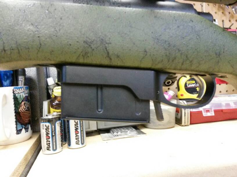

Installed mine, works great. If I could figure out how to post a picture from my phone I would post that picture.

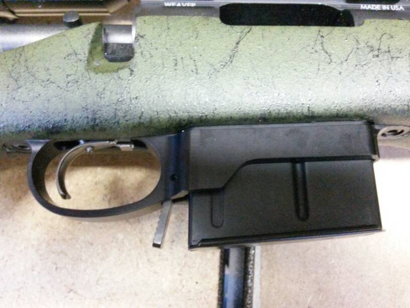

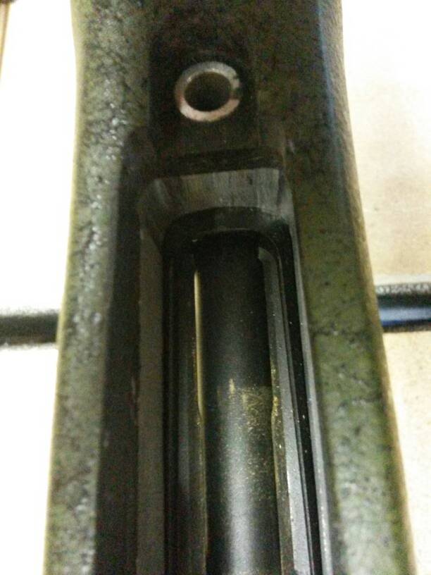

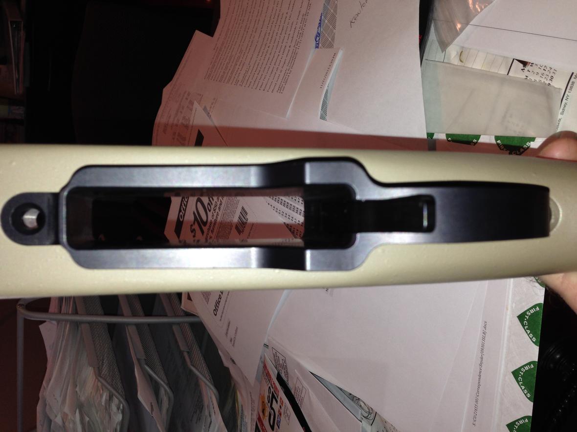

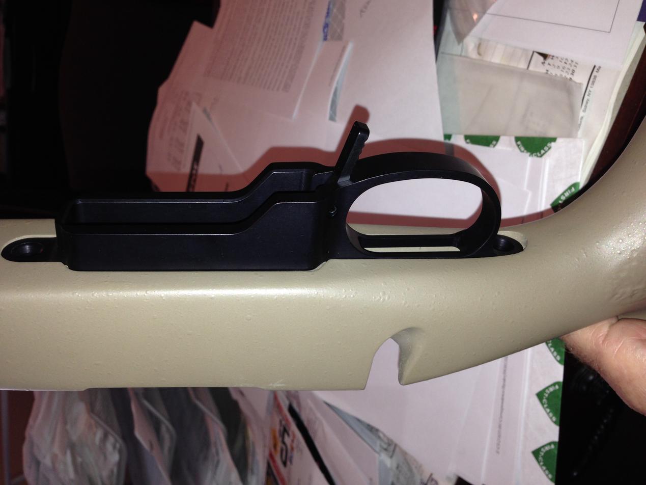

The odd thing is that the stock I have came standard with rem 700. I gave a hogue overmold I had laying around a try (take-off from my AAC-SD; both stocks are SA) but had similar issues. Looking at the other pics posted here, it looks like for the gap between the Stealth and the stock belly to not happen the front and rear inlets where the screws holes go need to be deeper (dbm would need to hide inside the stock on those areas). In my case these areas end up perfectly flush between the Stealth dbm and the stock, thus the gap around the dbm shows off.
BDW, thanks for helping us try to fix this issue Dave. Let me know if you need me to send the stock your way.

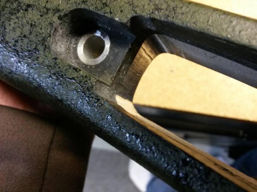

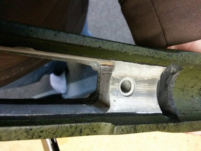

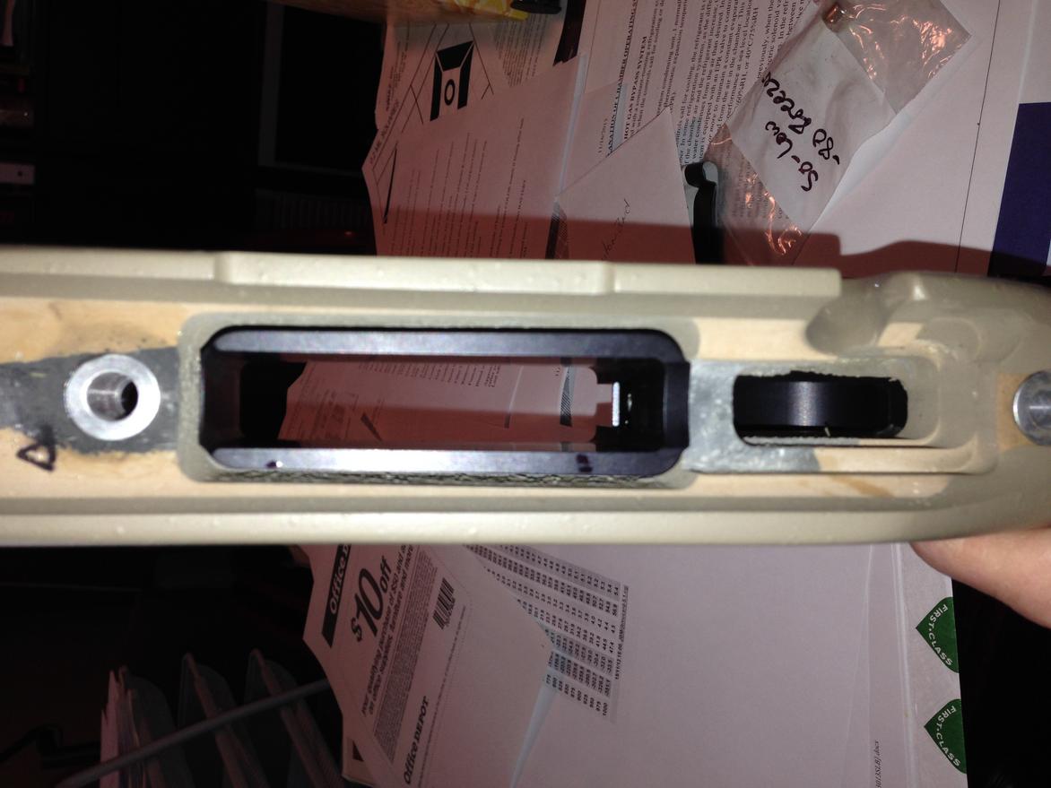

We have longer and shorter latches to move the magazine up or down in the stock for proper feeding , some stocks are thicker in depth than others so ether the latch change or deepening the inlet is necessary. Thanks Dave
Sounds like I might as well go M5 flush then since Id rather have it anyway but was trying to stay away from having to cut up my stock.
[\QUOTE]
I cant speak for others but 20 minutes with a hand file opening up enough material forward of the factory mag box cut out in my B&C to allow mine to drop in. I removed very little material... maybe .05" forward. YMMV.

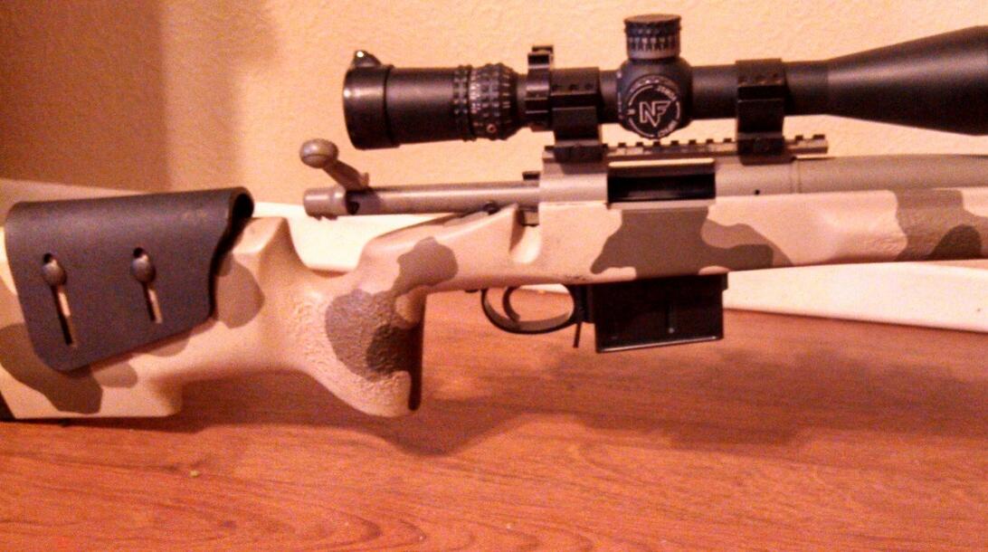

If I load the mag with the bolt closed it doesn't pick up the first round unless I open the bolt and tap the mag up. It almost always fails to pick up the last round unless I hold the bottom of the mag up.
Very very frustrating. Anyone have any ideas or atleast having similar problems?
