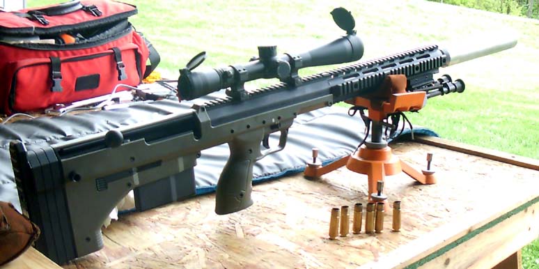

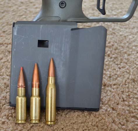

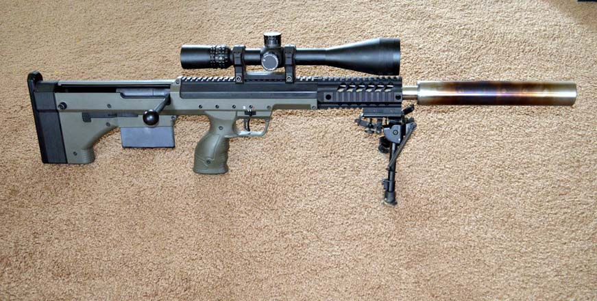

I shoot my Desert Tactical SRS/Covert with both rounds and normally shoot suppressed. The 510 is based on the .338 Lapua mag case cut down and with a neck turned on it. The .338BR is just the standard Remington Benchrest case necked to .338. If you're shooting subsonic the one issue you'll have is the rainbow like trajectory at longer ranges. The high BC bullets don't lose much velocity but since they're moving so slow they do drop more than the same round at high speed. I've heard of guys shooting these rounds at 1000yds but I think it would be tough to do consistently. I've fired .50 BMG tracer bullets in the 510 out to 1500yds and they do have quite an arc at that range. Might be a good choice for dropping rounds on the far side of walls or other obstacles since they drop so near vertical at that range. In any case it is a great niche to be involved in and its great fun to shoot. Low noise, low recoil, less cost for powder and lots of fun.

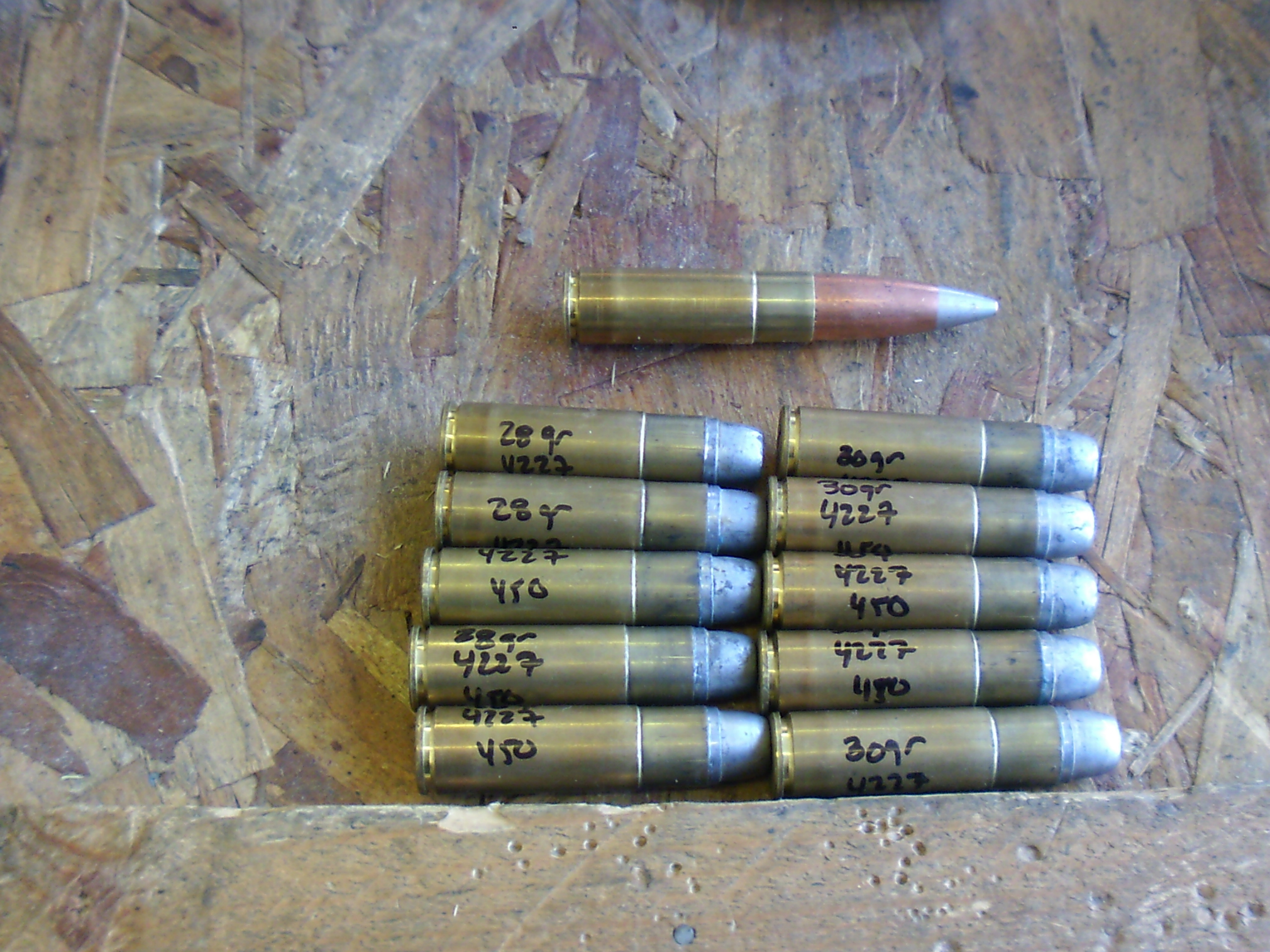

First pic is the .338 BR with 200 and 300 gr bullets next to a .308 ball round. Next is the Desert Tactical rifle with the suppressor on the .338 BR barrel (17" bbl). Next is some test .510 rounds using cast gas checked bullets and one round of API 650gr. Next pic is the Desert tactical rifle in 510 with the suppressor prior to swapping the long handguard for the short one.
