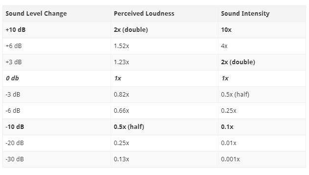

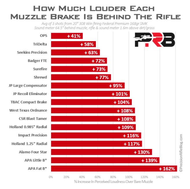

5 decibels only sounds inconsequential if you dont understand logarithmics and are thinking in linear scales. So yeah, its that bad.
Note these are increases: 100% increase is basically 2x as loud as a bare muzzle.

so many people are missing the point. Your fucking your hearing with a normal bare barrel without a brake!
many rifle suppressor mfgs claim of hearing safe, is NOT for more than a very limited exposure.
btw they ran the mic 9” of to the side, about 4” more into the blast zone of brakes than the shooter experiences.
for those of you who have spent a lot of time spotting you know just a couple inches of center of the shooter and the noise levels with a brake drastically increase
LOL....That chart is cute. As it really demonstrates the change in direction of the perceived loudness. For every increase...there must be a decrease. Take that same testing situation, place sound meters in a full 360* circle spaced equally apart. Take your measurements. You'll see the changes, where what is happening and when. Some areas of the circle will decrease....other will increase. Just as your chart depicts....it's just your chart is ONLY referencing one specific point in space.
Take any rifle outside with nothing around. Fire the rifle. Now go into sheltered firing position say like a hotel room. While in the exact center of the room fire the rifle The sound will be "perceivably louder" since the sound will now be "trapped" inside the room.
It's not rocket science, it just takes an understanding of what info people are sharing.....or not sharing.
I'm not saying don't wear hearing pro. By all means WEAR IT. But to give some idea that I'm going to notice a +5db change with a brake isn't always 100% factual. Why??? Cause as your chart above shows.....muzzle brakes made by DIFFERENT companies, using different designs,.....well......OMG....cause different changes in perceived loudness. WOW.
Using your chart of Sound Level Change and comparing that to the "How much louder.." chart I see the JP Recoil Eliminator @ 101% should be "perceived" as 2x louder than a bare barrel. Do I have that right??
SO we have to ask....How?? Well...considering the other brakes listed lower than 101% in increase (except one JP) are made by different companies....we can say it's all about design.
So muzzle brake DESIGN isn't there to make the "perceived loudness" less.....it's there to control the weapon. Wearing hearing protection changes the "perceived loudness" more than a muzzle brake.....BY DESIGN.

For example when taking two sources of the noise: Let's use two rifles same make, same series....two different calibers. One 30-06, one 7mm. When fired the 30-06 makes 160db, the 7mm makes 165db. Then we do that same firing using two different rifles and calibers....every time it's measured at a +5db between the two fired rifles. You will not be able to identify the +5db 100% accurately every single time during every single testing sample. You will say "Damn that's loud."
I work in an industry where that +5db is the difference between single and double hearing protection.
As measured by a meter...not by you walking around going...."Hey guys there's a +5db change in the noise here. Time to double up hearing protection."
For what it's worth:
Perception
Sound studies tell us time and again that a 3dBA increase in sound level is barely noticeable to the human ear. In fact, you have to raise a sound level by 5dBA before most listeners report a noticeable or significant change. Further, it takes a 10dBA increase before the average listener hears “double the sound.” That’s a far cry from 3dB.
Perception

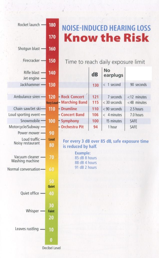

I don’t know why you are still arguing. And using examples at the low and safe level of hearing to describe dB differences is a misleading argument. Sound dB increases are not linear in nature, they are logarithmic. Here’s a chart, similar to most, except indicating safe non-protected exposure time at various sound levels. Once you hit 130 dB, it’s less than one second. And, for every 3 dB increases that safe exposure time is cut in half.
That’s probably what you’re arguing against without knowing.
So the whole argument is about how many nanoseconds difference it takes before you’ve permanently damaged your hearing?

@Krazy_jim That's my point exactly. You don't know the exact increase, you just know from the "perception" of your own hearing. For a situation like that a meter is always going to be used LONG before a personal reaction to noise levels to know the exact noise readings.
@lash Once you start going to the higher end of that table ( firearms show at 140+)...your ears will hurt long before you 100% know every time you are exposed to +5db changes. Many testing reports show a 12ga, 30-06, and .45ACP read at levels within +5db of each other as measured at the barrel. Can you say 100%/90%/80% when you experience a +5db change from a weapon??? I doubt it.
As before many people report one huge factor is individual perception. Sure use whatever meter you want.....people will still look at the meter and say "Wow ...I didn't realize it was that loud."
The test link/blog post above shows a reading of sound level to the side of 162.7db. Put on a OPS muzzle brake and the reading is 166.7db. That's only a 50% increase....in perception.

Random photo from the interwebs:

You are illustrating my point. Many are judging the differences from experiencing the muzzle blast from another persons brake, especially when under cover like at the range.
This is not what the shooter experiences when tucked up tight horizontaly centered up behind the barrel. Move 6” outside that zone with an APA or Hellfire and you’ll notice a much loader event, 9” more and by 2-3’ you get smacked in the head. Under the low roof at some of the ranges the entire event feels more violent.
You can ask the other guys, not just me that shoot thousand of rounds yearly and burn out barrels at the PRS and NRL matches. Ask guys that spend enormous time spotting or teaching a ton of precision rifle, we know where not to stand.. we’ve all had to be in the wrong place. No doubt that’s sucks. But that is NOT the same dynamic the shooter experiences, and yes, some brakes like the Insite I showed earlier do not put the blast cone back as steep.
