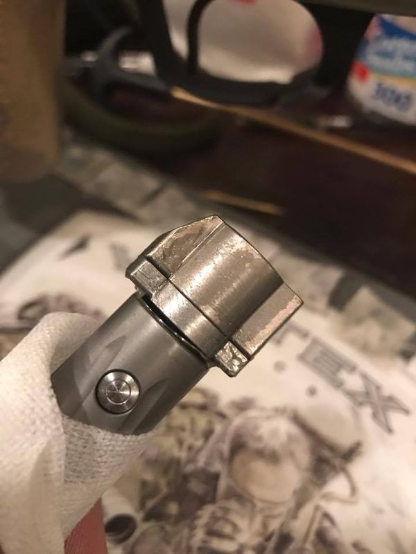

I went out today to get a good zero and it was freezing. In the 20's and a stiff wind in the face had my fingers frozen pretty quick. I shot a few fice shot groups to confirm accuracy with the 123L and 130ELDM loads, packed up and left. [IMG2=JSON]{"data-align":"none","data-size":"full","src":"http:\/\/i.imgur.com\/K6PeAQv.jpg"}[/IMG2]
Berger 140 Hybrids and 130 Hunting VLD's showed up yesterday. Still waiting on some 130 AR Hybrids and 130 Target VLD's to arrive. Will load up an OCW with each bullet and see how they do and report back. Will also be doing an OCW test with 140 ELD-M while Im at it.
As Josh reported, Bighorn had some issues with one of their 3rd party NP3 applicators on a batch of bolt/bolt heads. I had about 100rd through mine when I noticed the NP3 flaking off the bolt head only, the bolt looks beautiful with no issues. Spoke to both Eric and Aaron over at Bighorn who were great, they sent me out a replacement bolt head that day with a prepaid shipping label to send the new one back. It came yesterday and swapped it out in 60sec. To be clear, this does not affect accuracy or safety what so ever. Thumbs up to Bighorn for doing it this way instead of continuing to ship actions to put money in their pocket and instead taking care of the customers that already bought actions that had this issue. Their bolt head inventory will catch back up shortly and all will be good in Bighorn land!
As a business owner myself, everybody has issue, especially when your outsourcing parts or other parts of your business, but your judged on how you handle those issues. Bighorn handled this one beautifully.
So this is taking place of the TL3 thread? I planned on DLCing the action body and leaving the bolt NP3'd, though hopefully i don't run into any issues. Still have a month and a half or so before they ship out from PVA.
Got mine replaced and installed but havent shot it yet. What do you mean have issues?? What kind of issues? I cant think of any issues that could arrise from swapping the bolt head...
Issues could arise if the company wasn't controlling their tolerance stack as tightly as Bighorn does. Their replacement bolt heads have all been within 5 tenths when I got them to check. We'll see what the next set comes in at but if it's anything like the 100+ TL2/3 receivers that came through my shop last year it would be hard to foresee issues.
While I understand what could happen, I was under the impression after talking to you and Aaron that Bighorns tolerances are very tight and there shouldnt be any issues when swapping bolt heads.
