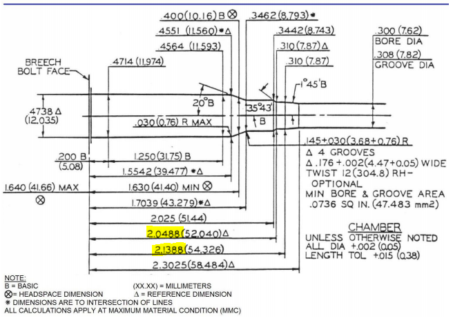

That free bore sounds pretty close to a saami spec freebore of .090 (2.1388-2.0488)

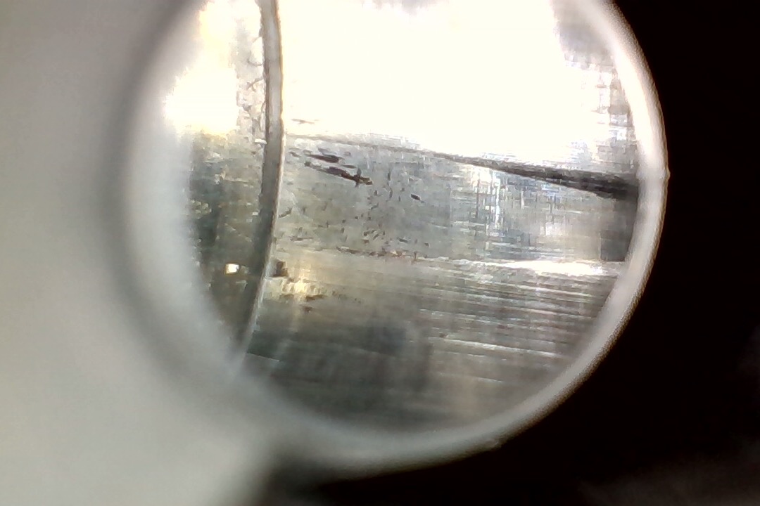

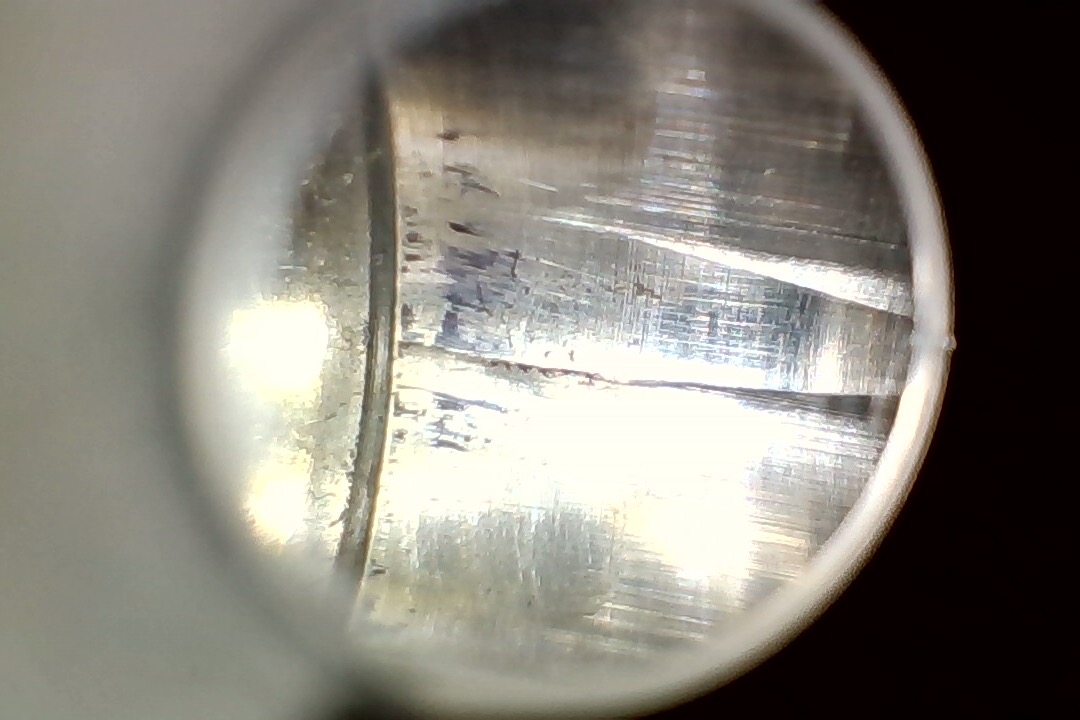

I borrowed a borescope and here are some images of the throat. It looks like the rifling starts tapering in immediately.
The black smudges are from marking bullets with dykem while diagnosing this.
