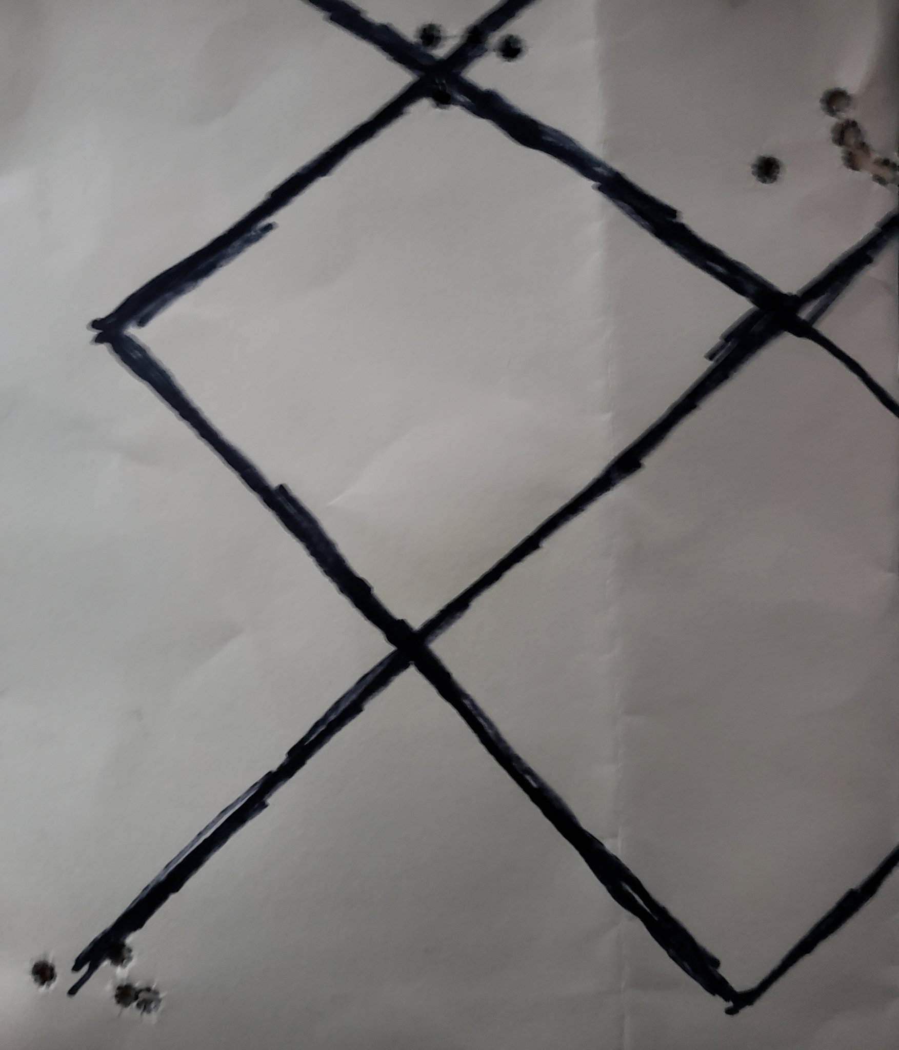

I shot these groups with one of his Kreiger barrels 2" outside to outside on the 500 yd paper target. Didn't measure the 600yd, but it's tight. Very little load development done.

200 yard target from yesterday testing a load on my latest keystone barrel. 8-10 mph fishtail, no cherry picked groups. Really tough to keep them even somewhat close together as wind was shifting and nothing shot worse than .4x, one was .3x. Good conditions it will shoot .2s. Not terrible from a prefit lol.
