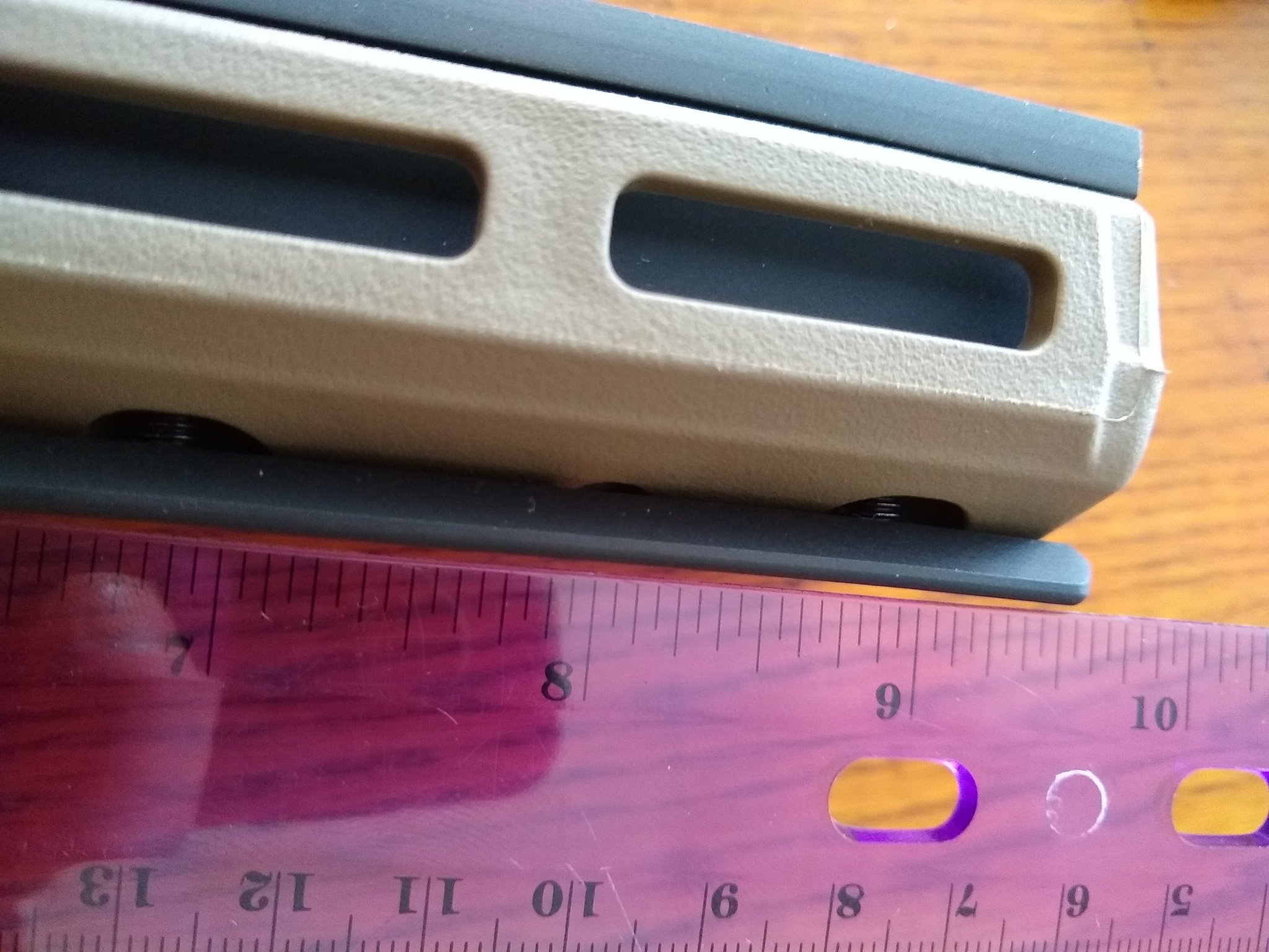

Hey guys, I’m having an issue with my bravo chassis and the KRG ARCA rail. Was wondering if anyone has the same issue.
When I tighten the KRG ARCA rail to the bravo fore end, it causes the ARCA rail to bend and conform to the bellied shape of the fore end. This causes my ARCA bipod to bind when trying to slide it back and forth unless I loosen it a lot. Anyone have this issue?
I have a Bravo but have not added a rail yet. Please keep us in loop as to what KRG has to say. Is it a KRG ARCA rail or a other variant? I’m using the KRG spigot with the KRG direct mount for my Harris and really like it so far.
Everybody knows the true test of straightness is a purple ruler (or maybe I have that confused). Anyway, jammed some feelers gauges in there & the gap seems to be .032". As I told COJ, I haven't tried the thing out as I'm waiting for the BA from PVA along with the tripod so I don't have anything to Arca to it, but comparing the pictures, I'd expect similar results. I noticed it on installation but assumed it must not be enough to matter. For clarification, the forend appears to be flat everywhere except the front 3" where it's molded for what I assume is a Harris bipod.
Reactions: Cup O Joe
Everybody knows the true test of straightness is a purple ruler (or maybe I have that confused). Anyway, jammed some feelers gauges in there & the gap seems to be .032". As I told COJ, I haven't tried the thing out as I'm waiting for the BA from PVA along with the tripod so I don't have anything to Arca to it, but comparing the pictures, I'd expect similar results. I noticed it on installation but assumed it must not be enough to matter. For clarification, the forend appears to be flat everywhere except the front 3" where it's molded for what I assume is a Harris bipod.View attachment 7012597
That looks very similar to mine though I’d say mine has a larger gap.

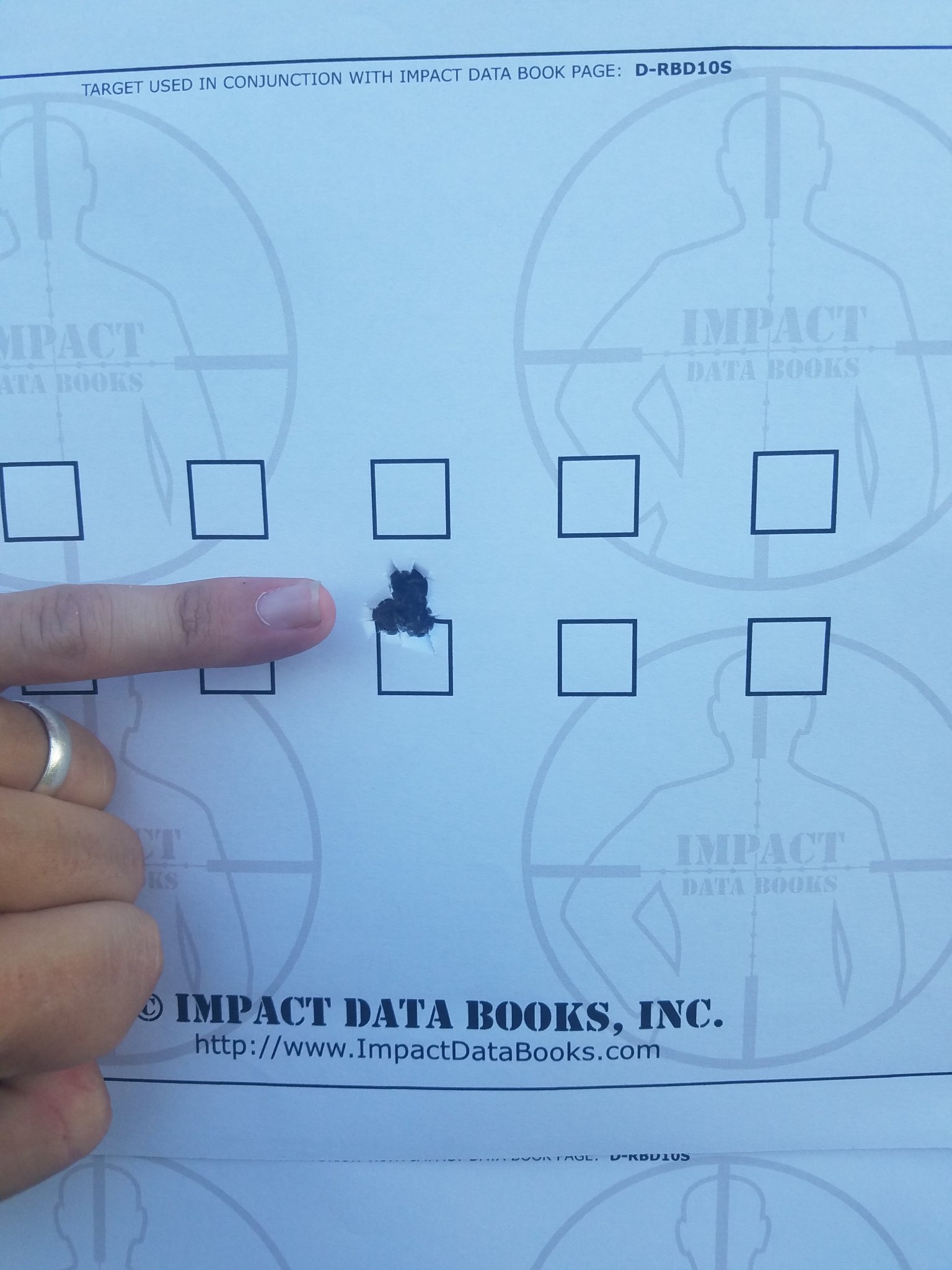

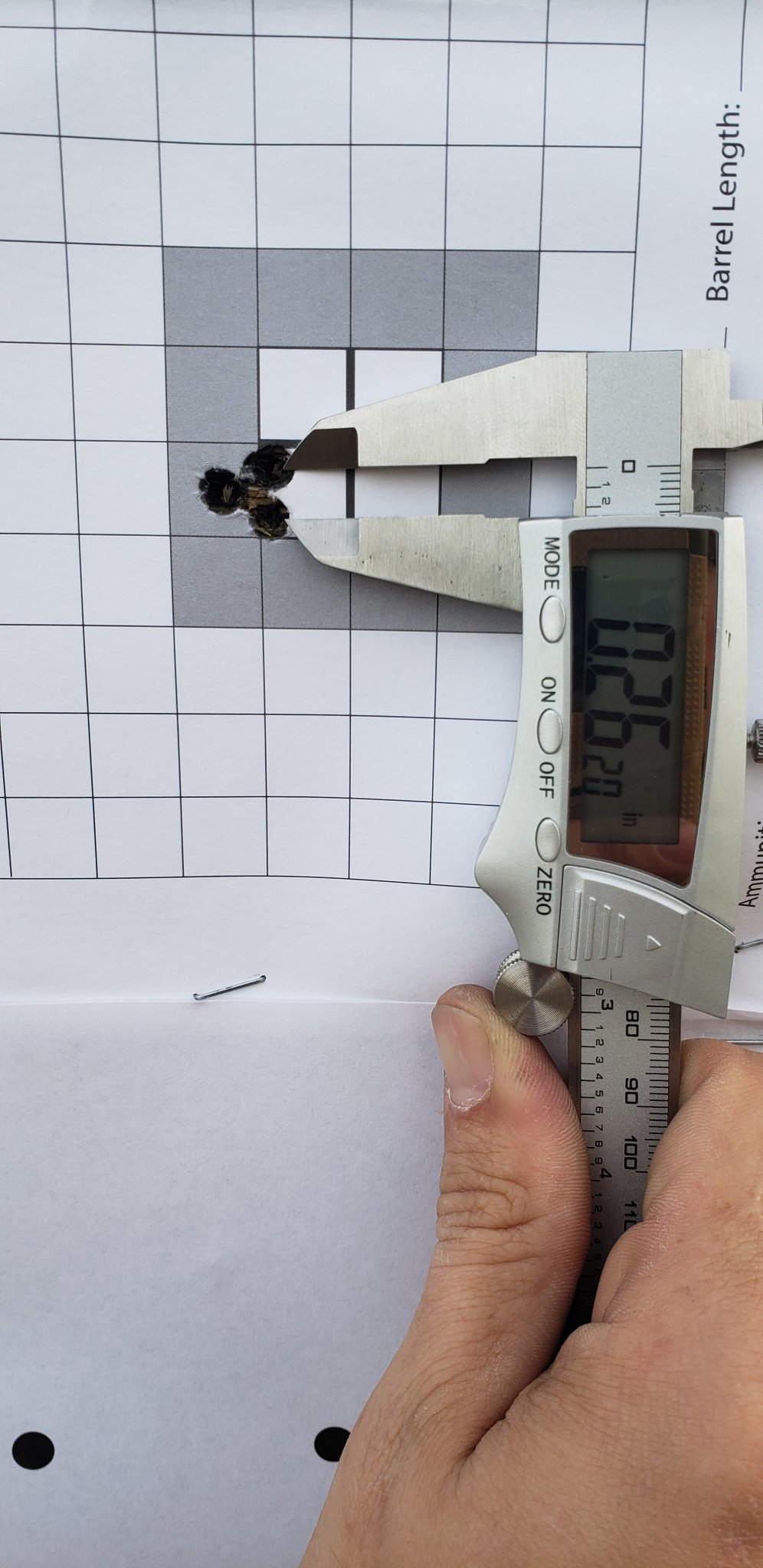

I'm also curious on how the JH 6.5's are holding up. What kind of groups are y'all printing?
Holy Cow!! I spend a couple days offline and miss all the whining & crying. I am JHR Order #1953, made deposit on 28/29JAN18, and waiting on a tracking number. The waiting has sucked but my gosh, not bad enough to make me cry like a little entitled metrosexual bitch.
Anyway......For y'all that have JHR/BA's in 6.5CM, how are they shooting?
I have 600 rounds thru my Nuclues BA from PVA, it shoots 1/2MOA no problem. I had a load developed in 20 rounds and only had to tweak it slightly once all my brass was fire formed. The chamber is slightly tight (feel it slightly when closing the bolt) with factory hornady ammo but I handload so thats not an issue. Ive had zero issues with the action, no light primer strikes using 16# spring, feeds great from a magazine, and single feeds great.
