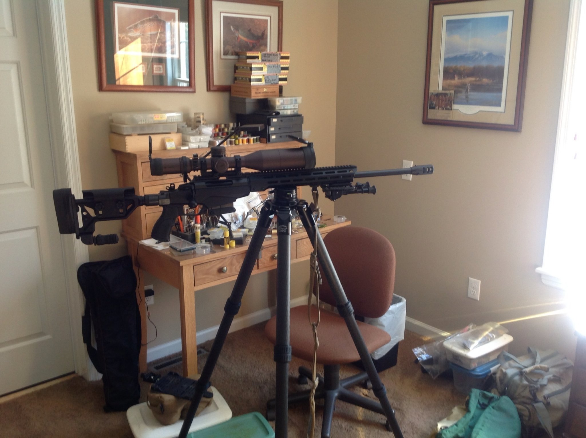

I have the PVA tripod and love it. I went with a RRS TA-3 leveling base rather than ball head, mostly for weight and the fact that the anvil-30 was damn near impossible to find in stock. I'll get a pic and post it when I get back today.

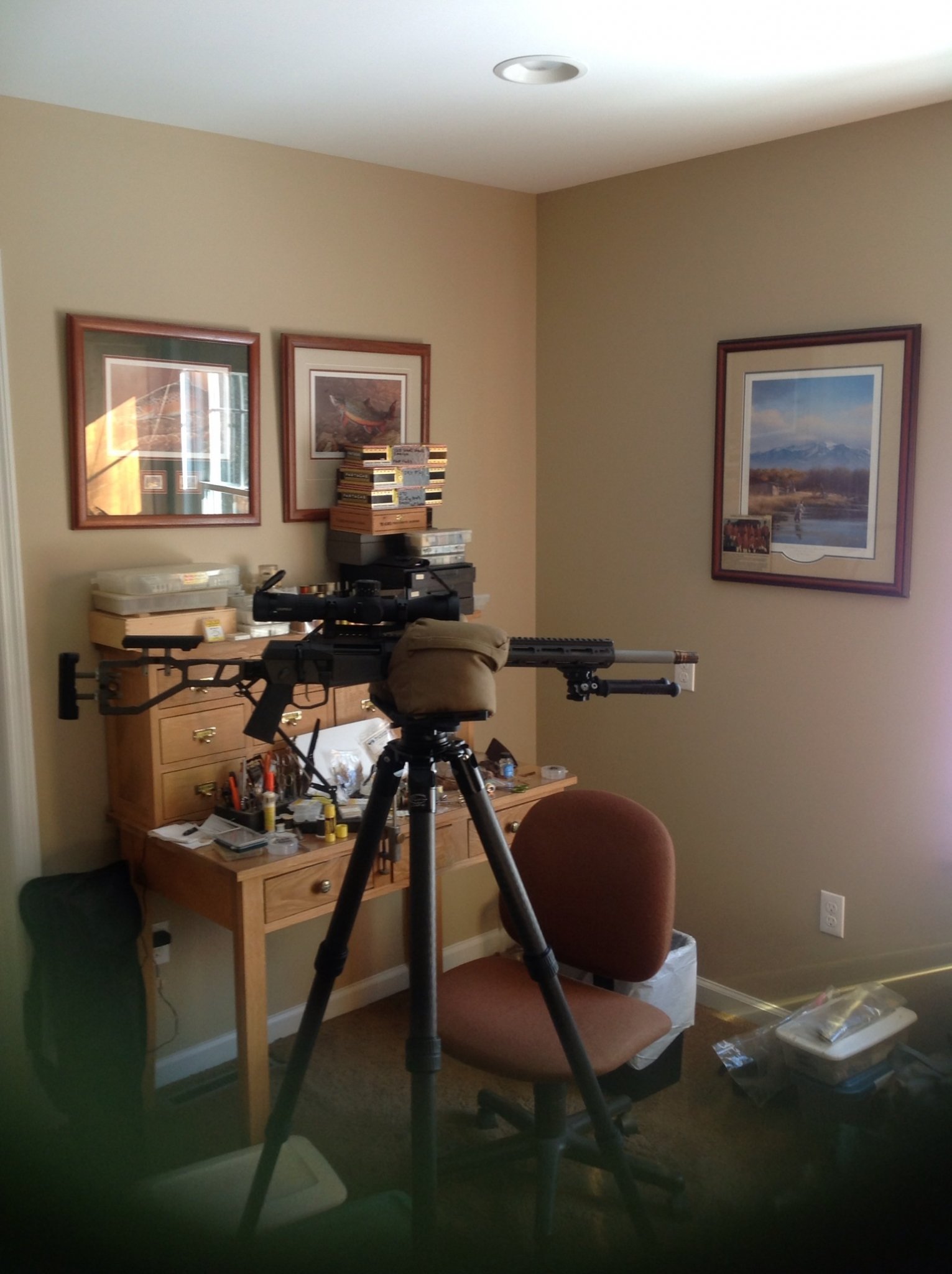

I have the PVA tripod with a RRS TA-3 leveling base. I got an Abel table also. This past weekend shot the Fix off the Abel table from 400 to 700 yards, very stable and was really pleased with the results. I also have a RRS direct clamp on my Tikka but haven't got a chance to try it yet.

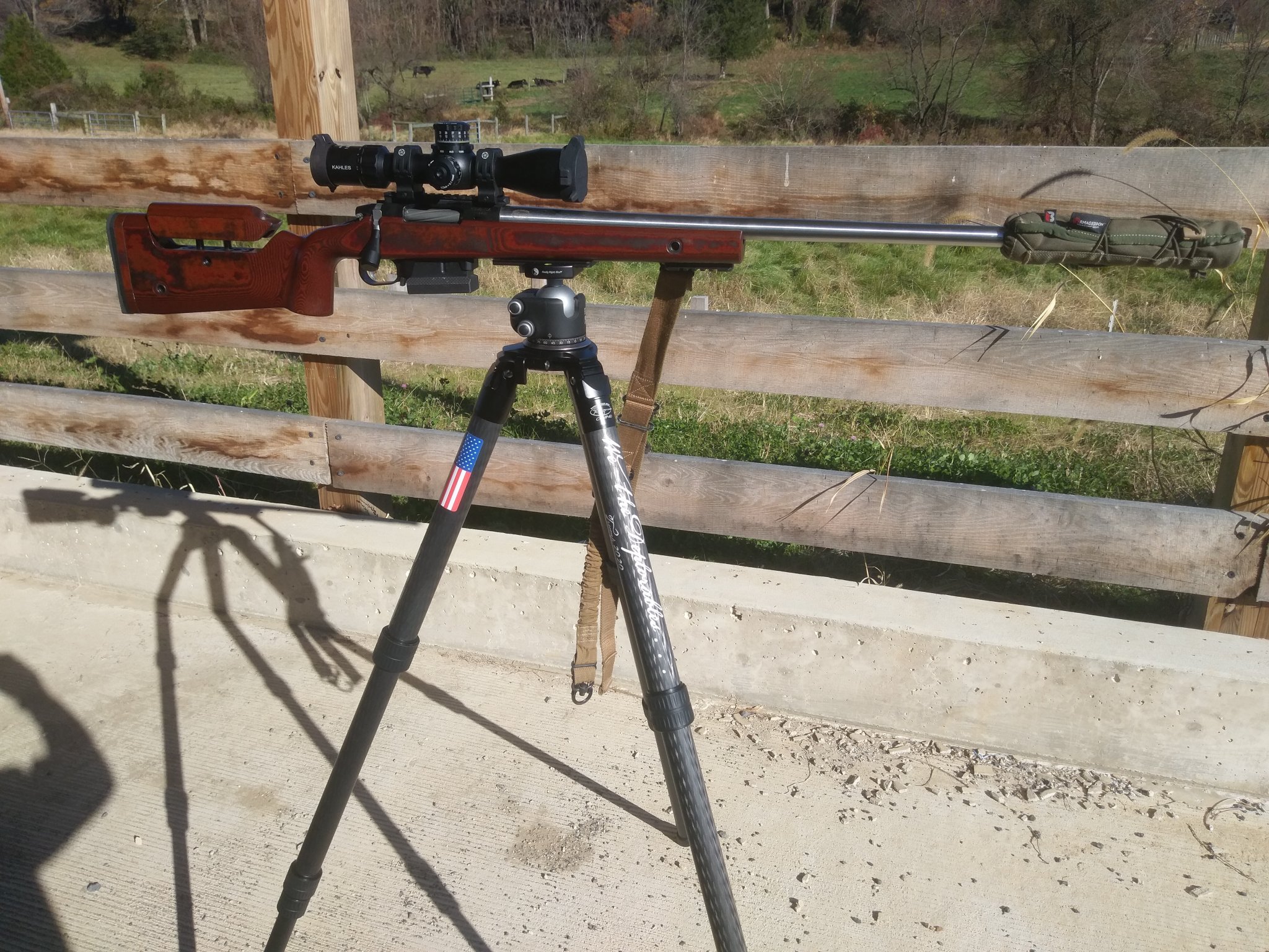

PVA tripod. This is my first and only foray into the tripod life. I'm confident I did it right and I don't foresee any issues or reasons to move to any other setup. I've not messed with the other attachment options out there but I say go RRS BH-55 or go home. It's sweet.

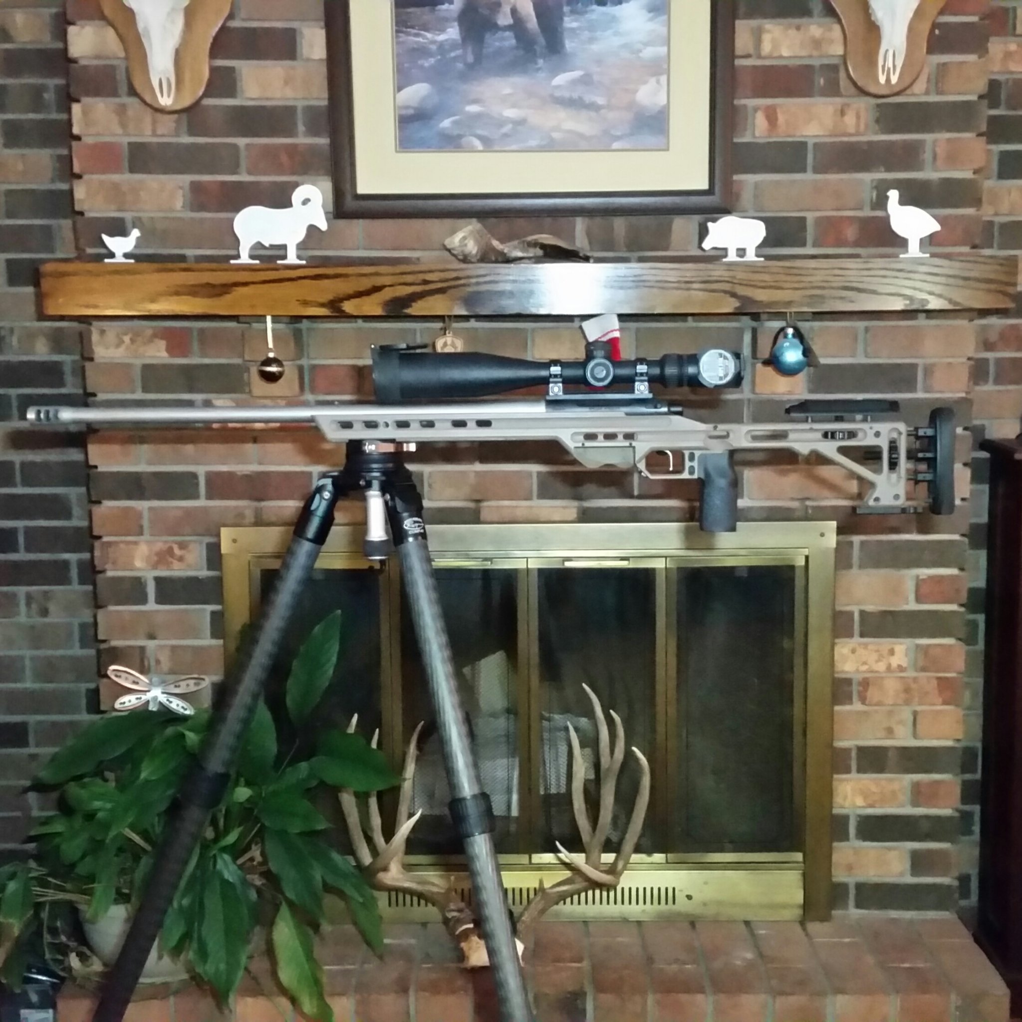

I used @Darkside-Six RRS Tripod that had the TA-2 at a match this year and I can not see how a ball head could ever be as ridged as the TA, since then I have used the TA-3 at two other matches from very accommodating competitors... They were a very solid lock up and dampened vibration down to a level I have not seen before. Zero problems supporting a 17 pound rifle as far out as my MPA chassis forend would allow. Needless to say, I've got both a PVA Tripod and a TA-3 in the mail as we speak. Good bye Manfrotto! I'll use you for non shooting stuff.

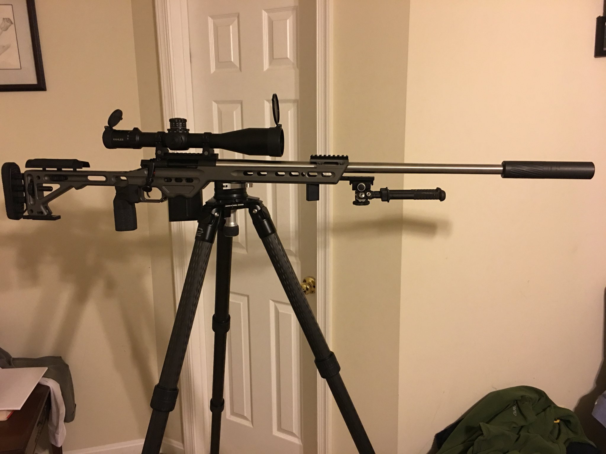

I switched from the Feisol ball head to TA-3 on my PVA tripod and it made a huge difference.
