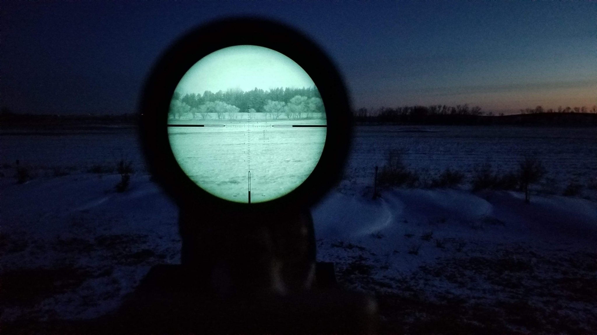

Hope this helps.View attachment 7289964
What type of scope do you have mounted on the back of this. What distance are the targets ? Do you need a peq 15 to provide more illumination or is starlight enough ?
Reactions: falcom
I have a nightforce 2.5-10x32 nxs as my day scope. There are no targets in that picture but that treeline before day break was at 400yds. I use a peq2a but a peq15 full power would be a better choice. No moon and no stars and you're still gonna be struggling to see much of anything. My optic choice isnt super ideal either though.

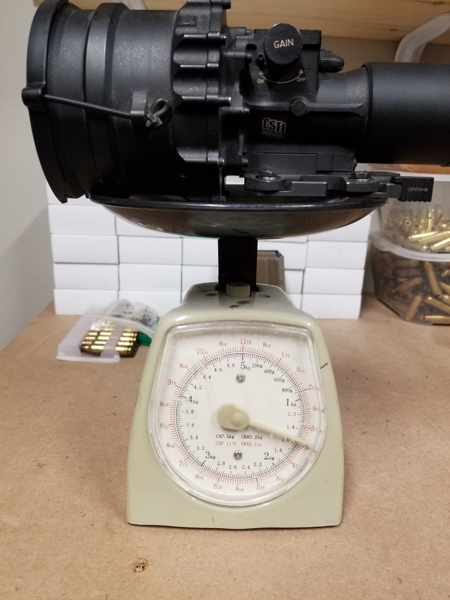

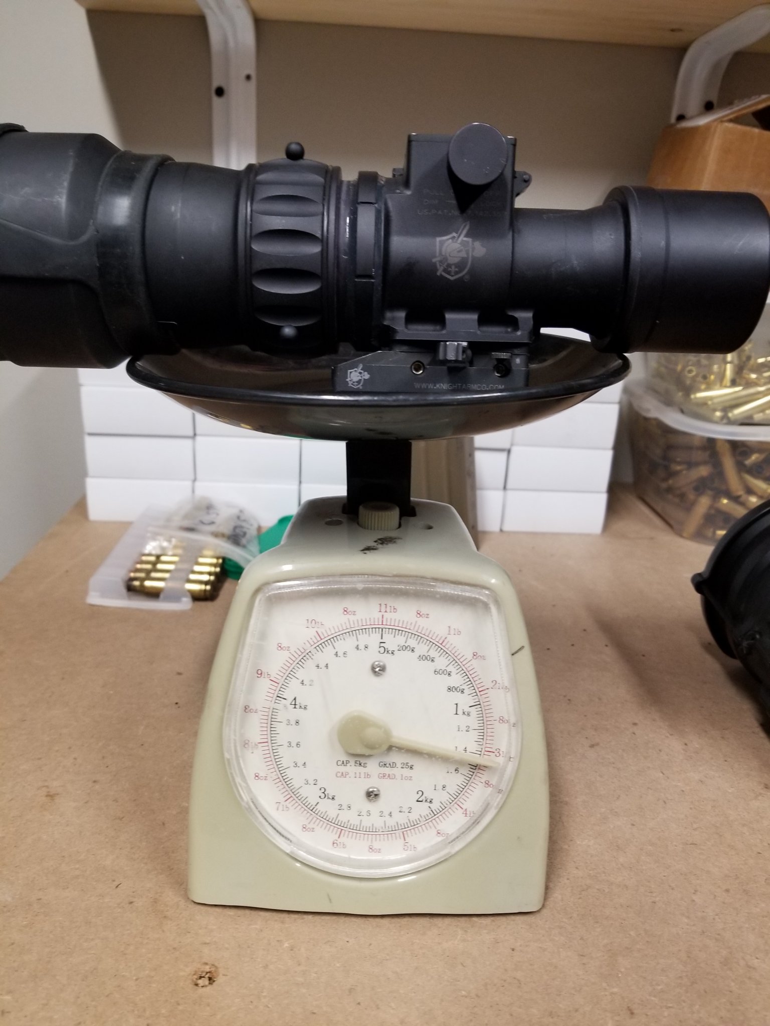

They really are on par with each other in my opinion. I'd say an edge to the 27 from the bones I have. The 27 is a hair brighter and crisper image I believe, maybe due to the obj. Size. Weight is not crazy different on mine. 3.2 oz. Haven't had issues fitting the 27 on rails or EFRs. They both work well with no issues. I do want to try a WP tube though for shits and giggles to see how much difference there is in a clip on.
