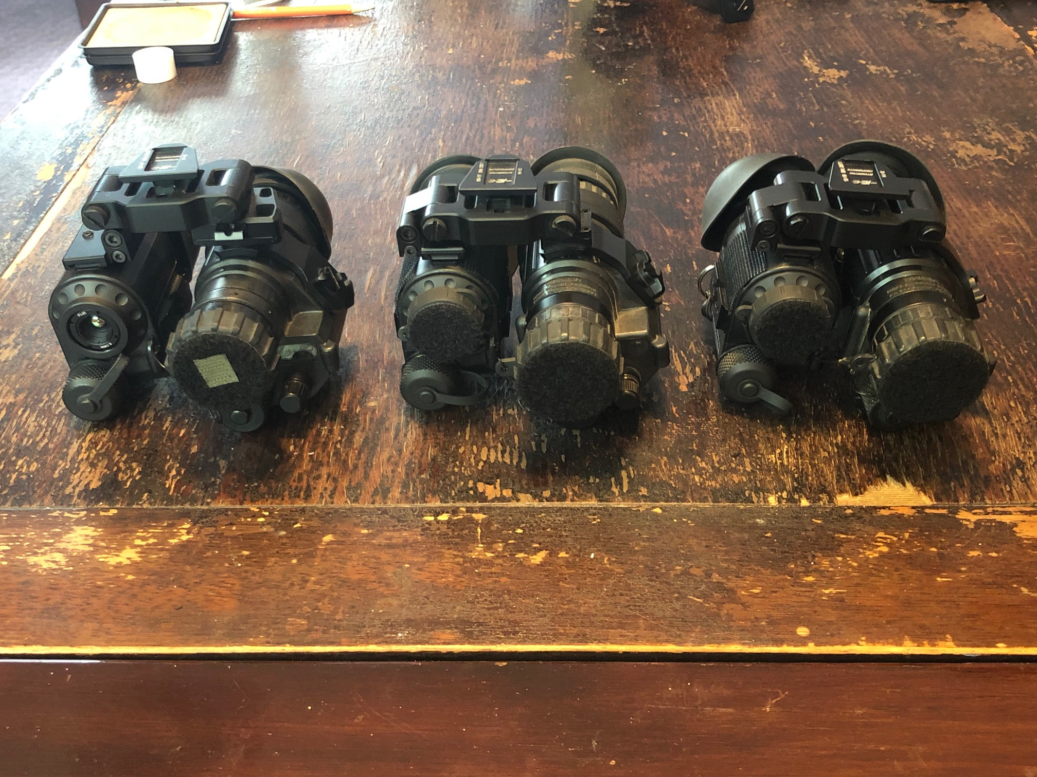

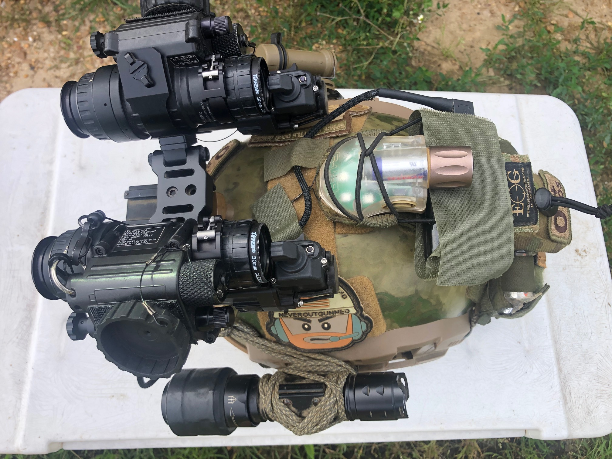

IMHO a dedicated Bino is pretty much a 1 Trick Pony. Why limit your abilities. There are so many advantages to going with the Mod Armory D14 or Light Weight Bridge over a dedicated Bino that it is not even funny.
1. Can Run NV & Thermal head mounted.
2. Can Run Dual Night Vision (2 14's) so you have Bino System
3. Can run a simple single for light weight easily concealed/packed system on Nightcap. (Think Bug Out Bag or Get Home Bag)
4. Can split your "Bino" system so a buddy etc can have one of the PVS 14's
5. Redundancy in independent power systems. With dedicated Bino's if you have a power issue, usually you loose both tubes down. That is almost impossible to occur with 2 PVS 14s
6. Have a hard face plant with dedicated Bino's and booger up just one side and the whole unit has to ship off for repair which is usually expensive. If you do same with a set of Bridged 14's just roll another (spare) 14 in and keep rockin or just send off the boogered unit for repair while you continue on with one.
7. With Bridged 14's you have 2 onboard emergency Illuminators, vs just 1 with (some) dedicated Bino's.
8. Usually much cheaper to get 2 PVS 14's and bridge them than buying a dedicated Bino.
9. 2 Bridged PVS 14's on a Mod Armory Bridge is usually stronger than most dedicated Bino's.
10. Independent manual Gain control for each tube. This can become extremely important if you ever run a Pas 29 COTI system on a dual set of NV.
Point being, it can be extremely advantageous to lower the Gain on the unit that does not have the COTI attached to it. This provides a much better fused image and also allows one of your eyes to maintain its natural night vision so you can monitor the ambient light situation.
11. Can take one of your 14's off and hook you IPhone up to it and use to take night pics while you still move around with the other one as a single.
I probably have forgotten to list a few other advantages.
There is only 1 Disadvantage against some (not all) dedicated Bino system and that is some minimal additional weight.
To me the Bridged 14 system or Bridged 14 & Breach advantages far outweigh the 1 slight negative. YMMV.

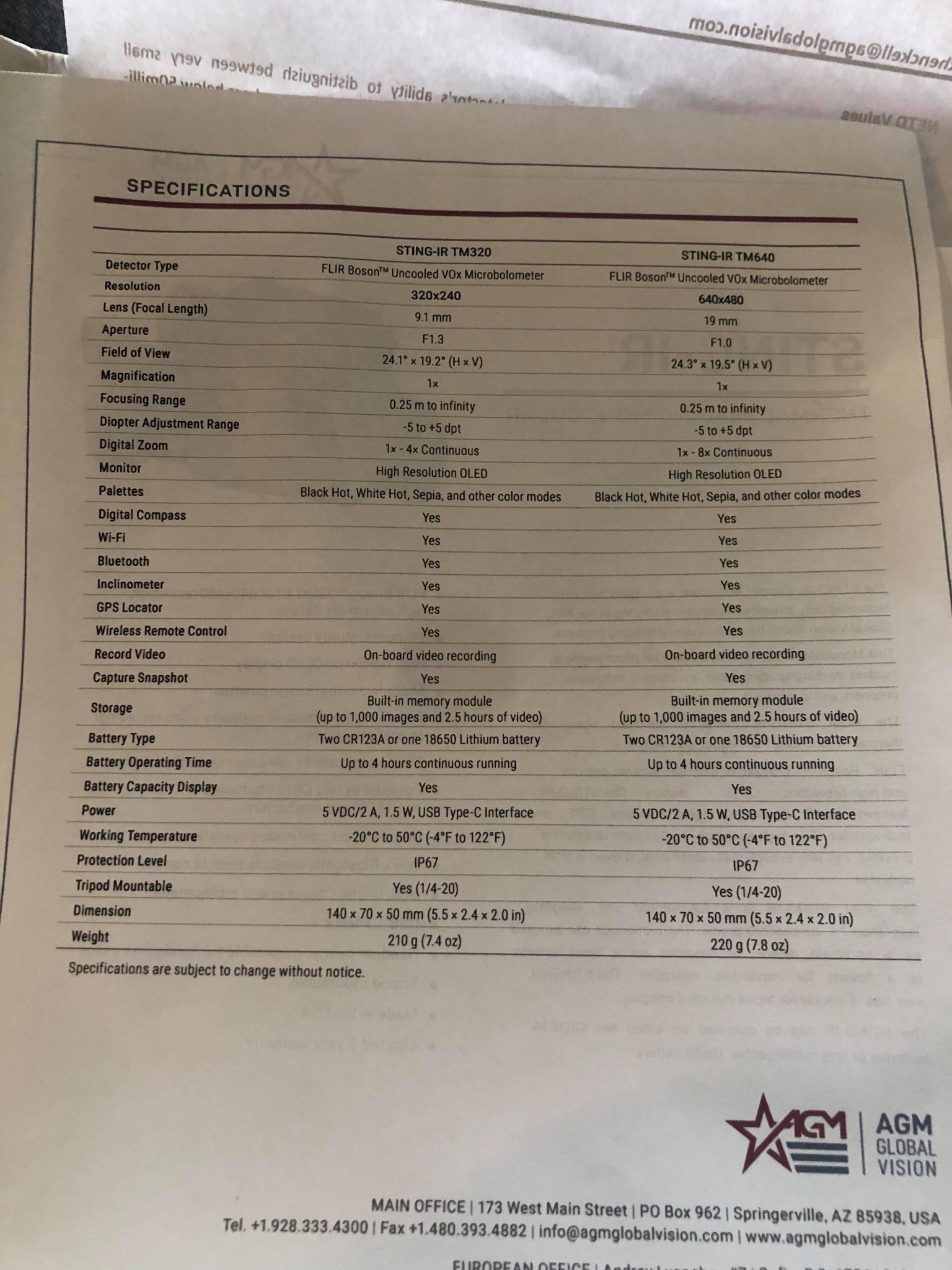

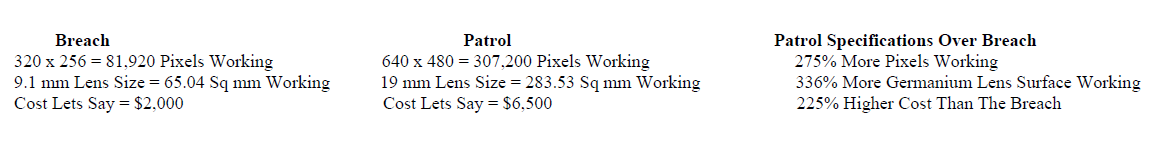

Well it is not necessarily the top of the line, but for the cost to benefit ratio I beg to differ that it is a shitshow.
I is a pretty good little light weight detector but is not good at PID.
Pretty much all light weight head mountable Thermals are running at 1X magnification. So even a 640 BAE cored device digitally 2x will be at 320 x 240 and only will get you so far out for PID.

Yeah, I own 3 of them. Here is pic of them on all 3 Versions of Bridges that Mod Armory has made. I am also likely to buy some more at some point in time.
Left To Right: Mod Armory Quick Disconnect Bridge, Mod Armory Light Weight Bridge Version 1, Mod Armory Light Weight Version 2

The patrol model is M300W
No issue with head mounting for me ... here is patrol with radius mounted underneath and 3xg magnifier clamp on front. I carry 3xg in pouch when on the move, but then can screw in front of clamp when stationary to provide long distance thermal range finder capability.
The trick to head mounting, is to adjust your Mod Armory IC bridge to the forward most position ...
Via the set screw and two holes located in the center of the bridge shown above.

A Patrol is a much stronger unit. Lets take a look at how much stronger.
So most definitely, a Patrol 300 should easily beat a Breach's performance.

Here is another option. Attached is a picture of the AGM Sting IR and data sheet. 640 has an MSRP of $4000, and 320 $2500. I have asked around for other pertinent details such as whether it can be dual mounted with a PVS14 and what the eye relief is and whether it can be used with eyeglasses. But no one has much info other than it is supposed to be released sometime this month. If anyone has any other info please advise. This is the first time I have posted a picture here so I hope this shows up! If not will redo. Thanks.
