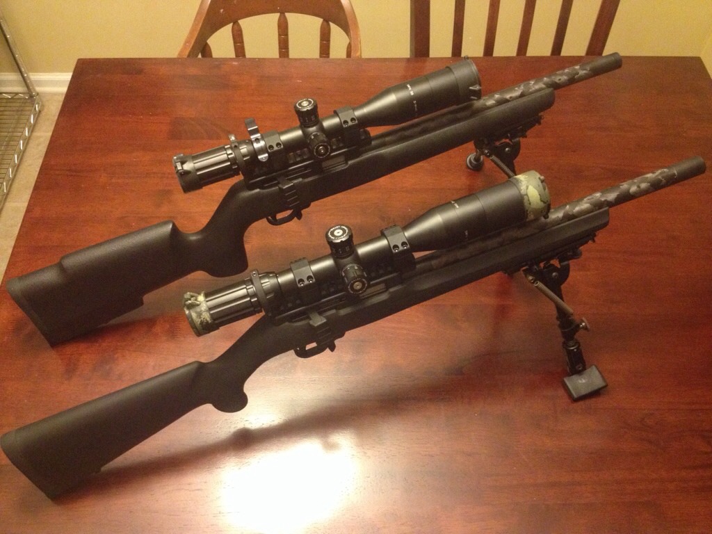

I got my hands on some decent match grade ammo for testing along with some subsonic. Will be testing on two PWS T3 rifles with similar set ups.
Rifle One is set in a Boyds Tacticool stock with round count around 1,000. Rifle Two is set in a Hogue Stock with round count of 300 or so. Both rifles have the same optic and rings combination, SWFA SS 3-9x42mm in Vortex Precision Matched Low Rings resulting in 1.8" HOB. Both rifles have Harris bipods and will be shot using rear bags from a 50 yard bench.
I'm heading to the range tomorrow and plan to clean both rifles, and refoul/warm them each up with 25 rounds of CCI standard velocity zeroing for that load. I will then bore snake a rifle once and shoot 10 shot groups through a chronograph of each ammo type. I'm thinking i'll run a dry bore snake one time before switching ammo types and alternate rifles so the bores have a few minutes to cool some between groups.
I will post pictures of the targets with the muzzle velocity results and environmental conditions as soon as I can.
Rifle One (rear), Rifle Two (front)

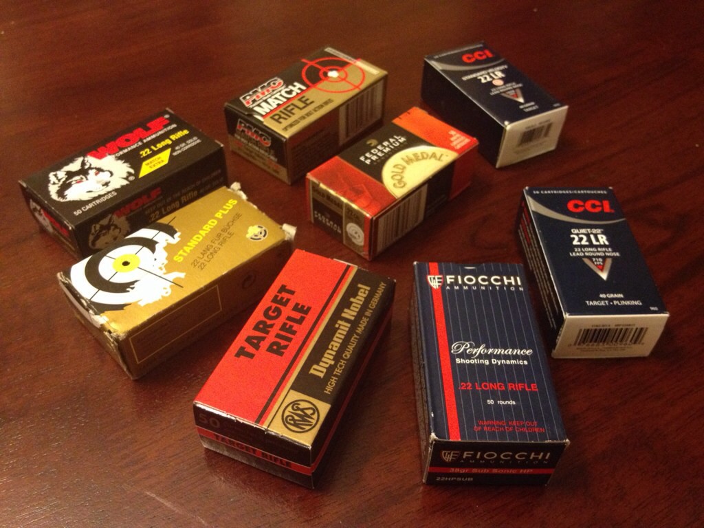

Ammo
CCI Standard Velocity 40gr
Wolf Extra Match 40gr
SK Standard Plus 40gr
RWS Target Rifle 40gr
PMC Match Rifle 40gr
Federal Gold Medal Target 40gr
CCI QUIET-22 40gr LRN
Fiocchi Performance 38gr Sub Sonic HP
CCI SUB-SONIC 22 LR HP 40gr (not pictured above)
