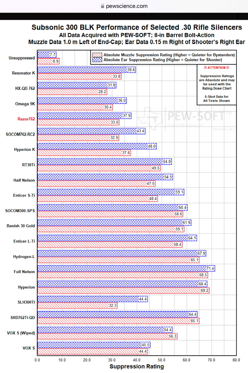

    Here is some information to share , the barrel on my rifles is 16” wish I had gone with the Q Full Nelson, or the newer replacement the Q Thunder Chicken

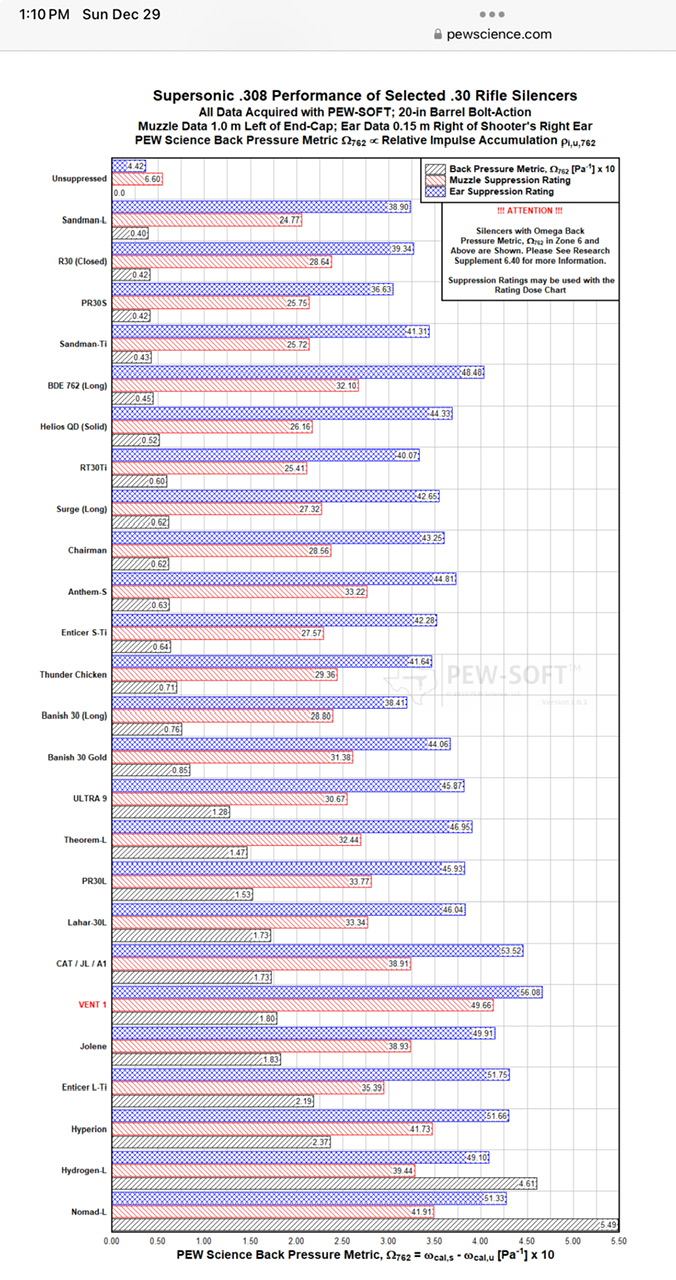

    Thats subsonic 300 blk, pretty sure those rankings change a lot on his 308 tests. Im not a subscriber any more, so I can only see some of the data. The Thunder chicken doesn’t break the top 20 in muzzle or shooters ear on a 20” 308.
