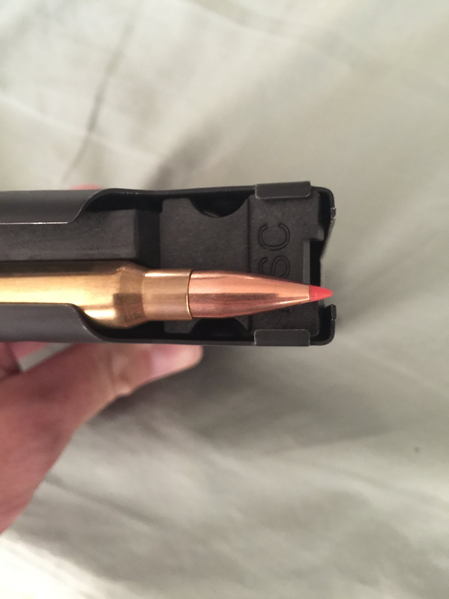

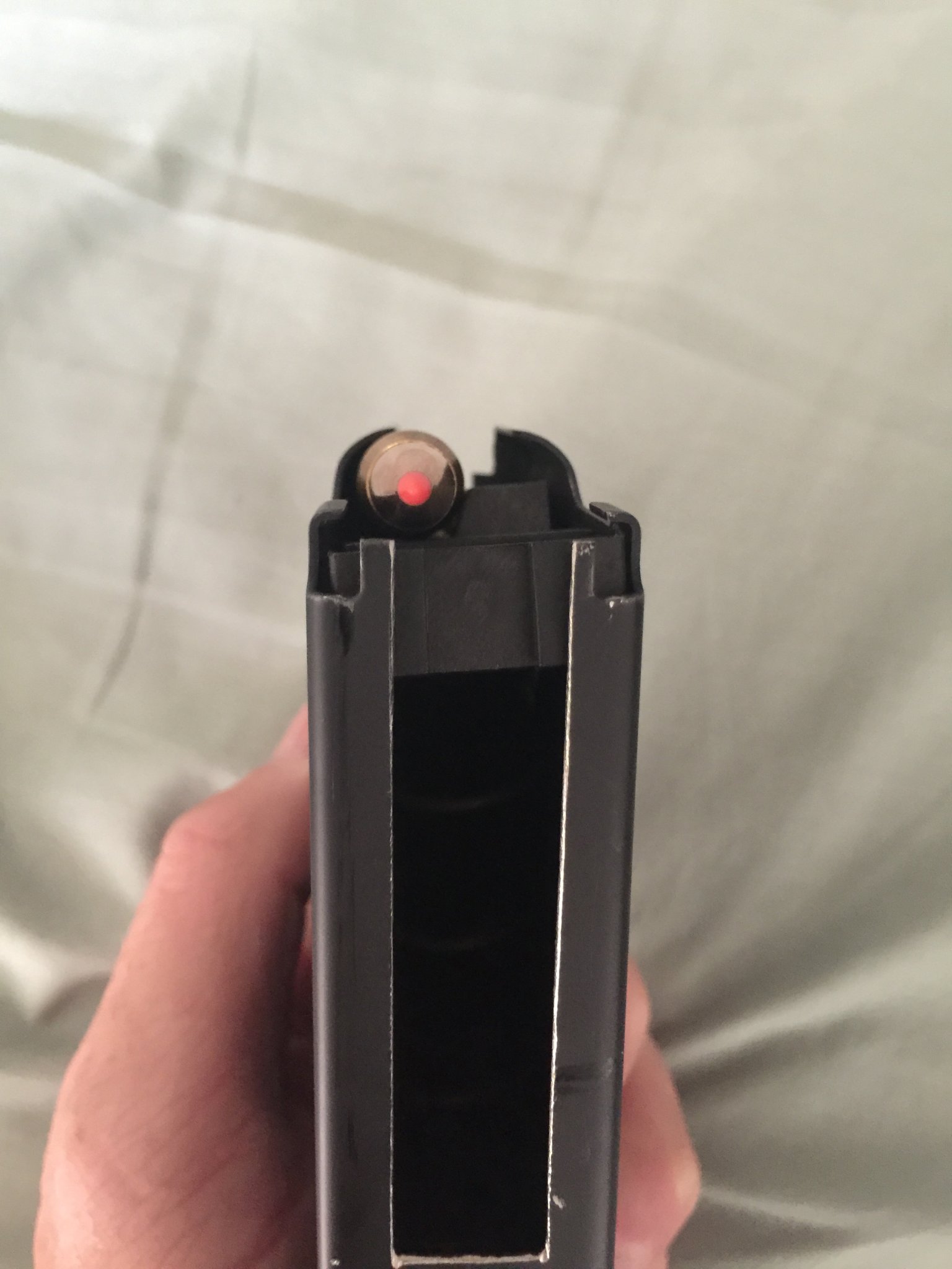

I'm not sure what ASC mags your running but all mine measure max internal length of 2.872-2.874. My 6 KAC's measure 2.866" internal.
When measured with calipers, the internal dimensions appear to be 2.874, and the loaded round is 2.868. I just remeasured these a few minutes ago. However, the corners of the mag body, as the sides bend around to the back, are not sharp, there is a defined radius. As a result, the loaded rounds do not sit flush with the back wall of the magazine. This eats up internal space, but is not obvious when just measuring front to back in the mag.
20 round magazine (Stainless steel)
The floor plate just says
ASC
NEW BRITAIN CT
Black ASC follower.
I bought the mag because it was supposed to have an internal length that would accommodate the long coal I was going for with this rifle. The rounds don’t fit without the mod shown- I tried. Reliability testing of the mag is still ongoing. This is my n=1 observation of ASC mags.
