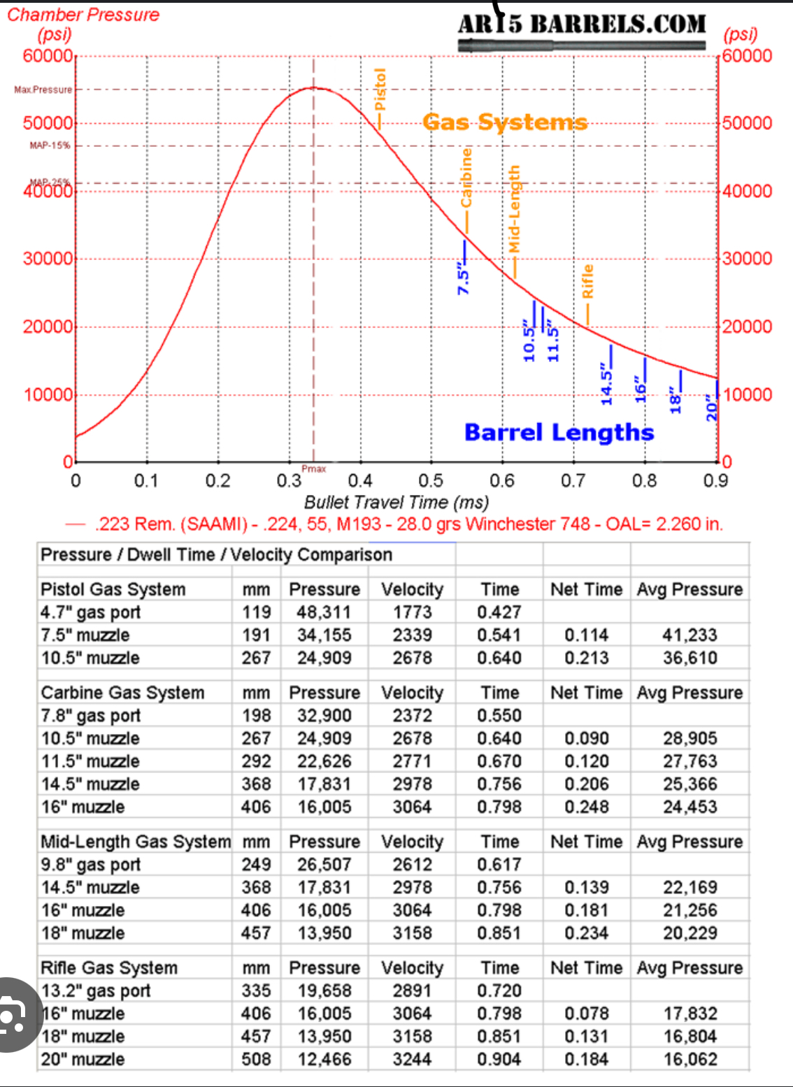

Just a quick search for port and chamber pressures at different port locations yields a lot of information. I’m not sure how accurate the info in this chart is or their test procedures.
