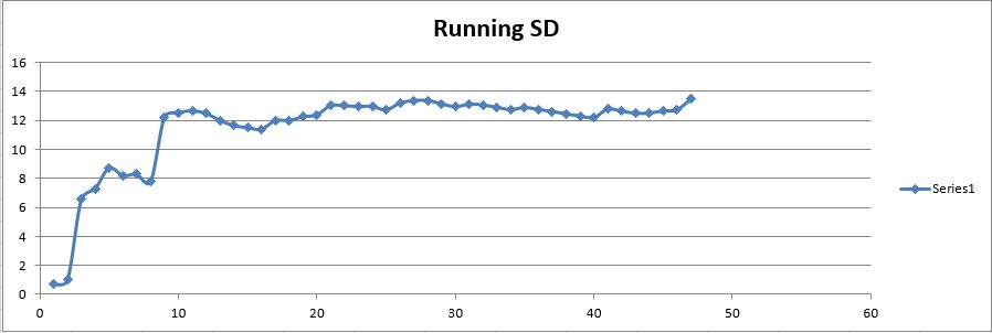

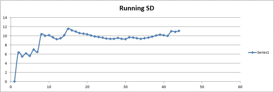

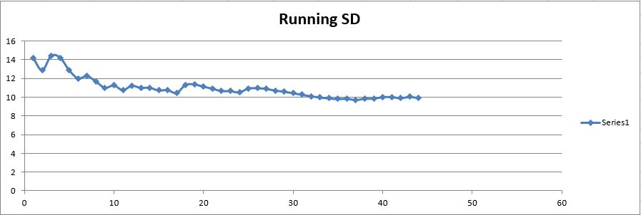

    Same load, same gun, 3 separate tests. This is velocity data. Shots are in order along the bottom, along the left is the running SD in FPS (i.e. at 2 shots is the first data point, at 10 that's the SD for those 10 cumulative velocities up to that point, etc..). I was testing new cases vs. once fired, vs. once fired stripped clean. New cases in the middle below for those curious.
    0-10 shots is noise. About 15-20 you start getting stable velocity data. I only shoot 30-35 for these tests anymore. There are other metrics that still have more variance beyond 15-20 (Dispersion, mean radius and radius SD mainly). This cost you nothing. Interpret your own conclusions.

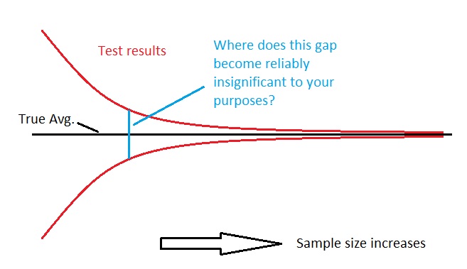

    What exactly am I to gain by tracking those extra 20 data points anyway? It certainly seems that the SD has mostly stabilized by the time it hits 10 data points, at least this is what your small set of three charts seems to indicate.
    Interestingly, coming from the automotive OEM arena, I completely understand that 30 data points is the minimum statistically acceptable number of points need if one is expected to be able to show stability and a true SD. Typically 100 data points are required to show process capability.
    What we should keep in mind however, is that a process that has been shown to be stable/in control can yield useable results using fewer data points. This is especially useful when making incremental changes or improvements to a process. It allows one to test multiple incremental changes and narrow down to those that are improvements versus those that are not.
