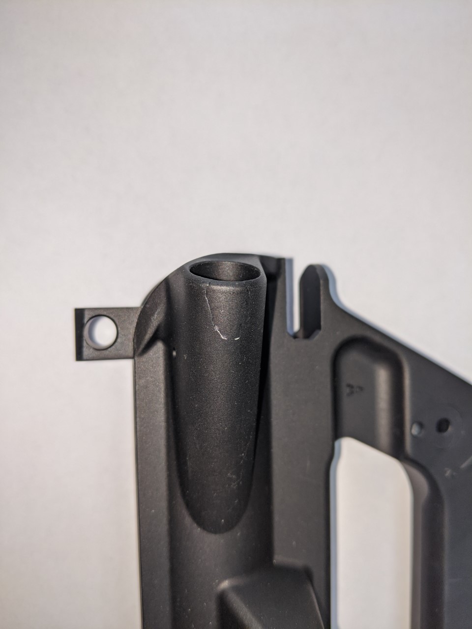

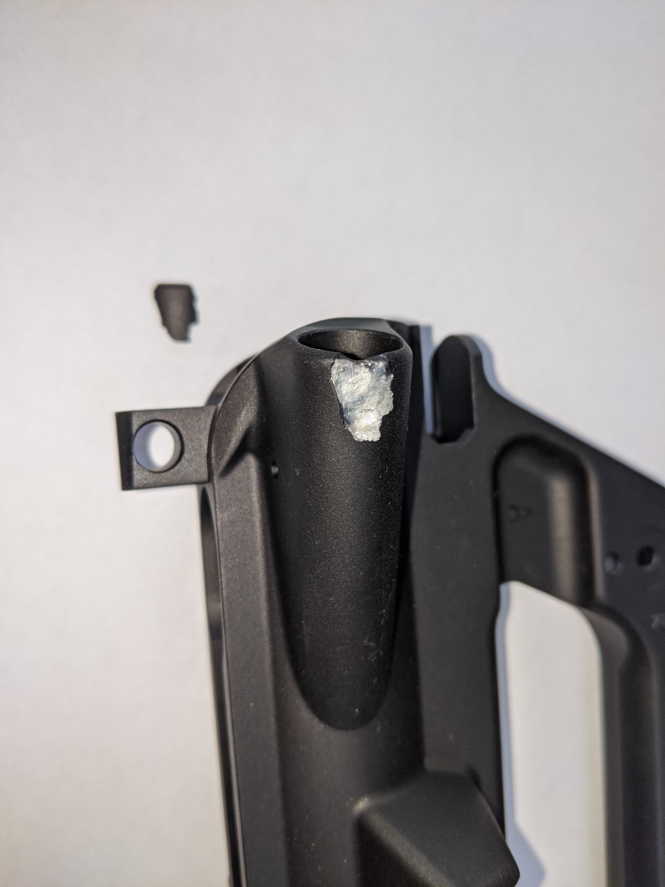

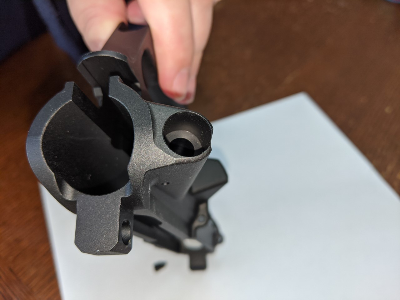

Hey everyone,
I got a C7 retro upper from Brownell's and when they shipped it, a chunk got taken out of the forward assist area. I would like to fix it if possible because Brownell's customer service has yet to respond about this, and a lot of reviews mention how oftentimes the receiver is out of spec and won't fit on people's lowers. This one fits fine, so a maimed bird in the hand...
Attached are some pics:
This is only for range fun, I don't care about aesthetics, but I don't know if this will be a problem later on.
Questions:
1. I have the little piece that chipped off. Could I JB weld that sucker back on?
2. Would it be better to just fill in the chipped area with JB weld or similar and sand/grind it down later?
3. Just ignore it, spray paint it because it won't most likely cause any future problems?
Thanks,
Greg

The short answer is yes it can be patched but not fixed. Well, maybe. It's not a structural component. Maybe somebody is really good with welding can build it up and then reshape it and maybe a little behind it or Dura coated

No JB weld. No paint. Black oxide for color. Spray paint is succeptable to heat unless you use the engine grade, but u should be able to get a military grade oxide coating cheap.
As far as the chip, find a TIG welding shop and it should be cake to fix. Instead of JB weld, if you go that route use steel stick. By the same company. Its steel impregnated JB weld. But i wouldnt do that. Get u a welder to fix it. One little zap
Id charge 20 bucks and it would take about 5 min. Now, if you have a sample of the metal he would be welding, it would be great to have a piece with which to dial in his machine.
Its 7075 T6 aluminum. Thats what the welder will want to know. Tells him what type of filler rod to use and how to tune his machine. He can probably just fill it and sand it out. Hit the spot with tool black or black oxide. There was this shit they used to finish M16s with that would work. Ask one of the Vietnam Vets what its. Called. It smelled like shit.

I agree. Im an avionics welder and have a pretty nice machine and id still rather have it replaced
Just for the sake of conversation if you were going to perform that repair you would heat sink the rest of the part but it is rather close to the threading. Youd have to sink it inside and out and have those threads covered. I forgot about that.
Welded repair is gonna show more than any other type, short of anodizing the upper again.
If you're not too particular about the cosmetics, a drop of cyanoacrylate and a black sharpie around the edges.

My question is how do you chip an upper like that????
Even the worst packing surely cannot result in a chip like that? Not without exigent circumstances.
Uppers just don’t chip like that!! I’d be worried that it is a pos die casting with metallurgical issues and make darn sure the new one is not from the same lot. Even a casting should not chip like that... not if it was poured and cooled right.

I don't know. It was laying in the bottom of the box with a 12 inch barrel with a front sight/gas block that was lightly wrapped. But they put a lot of packing paper above them to protect from the cardboard top? Not the greatest packing job I've seen...
I suspect that it was a combination of suspect metallurgy plus getting hit right on the end of the forward assist area with the heavy barrel..
