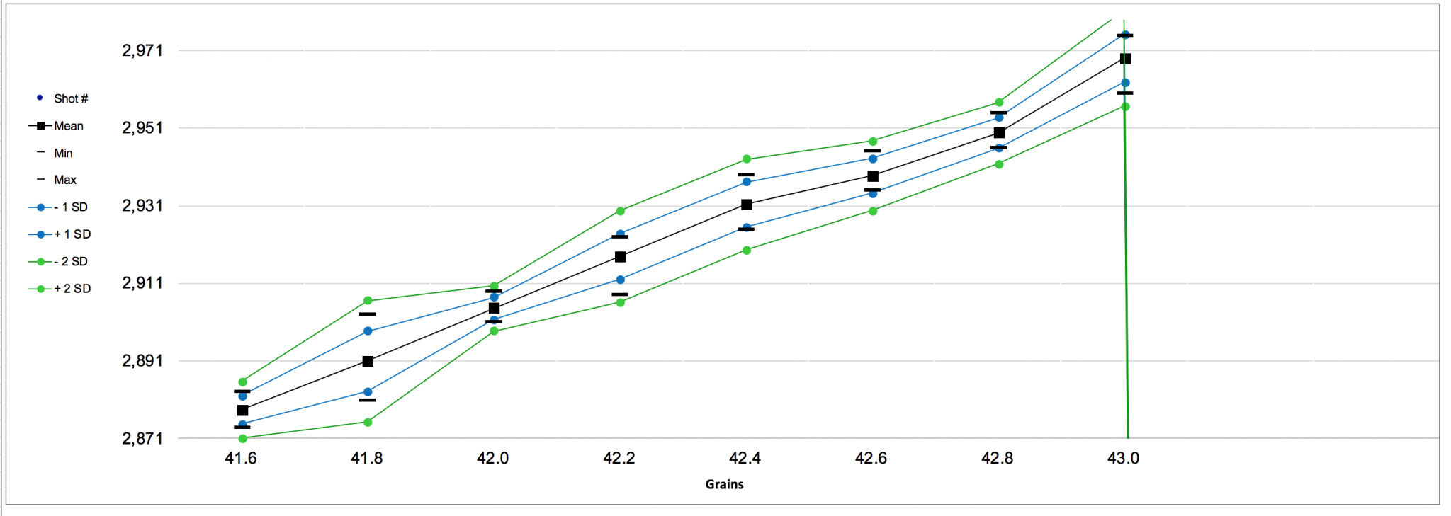

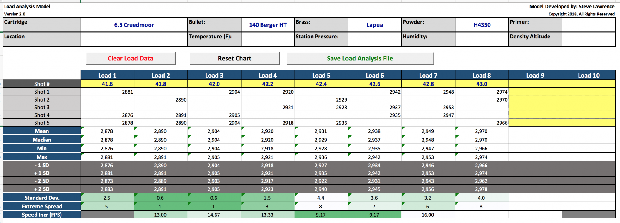

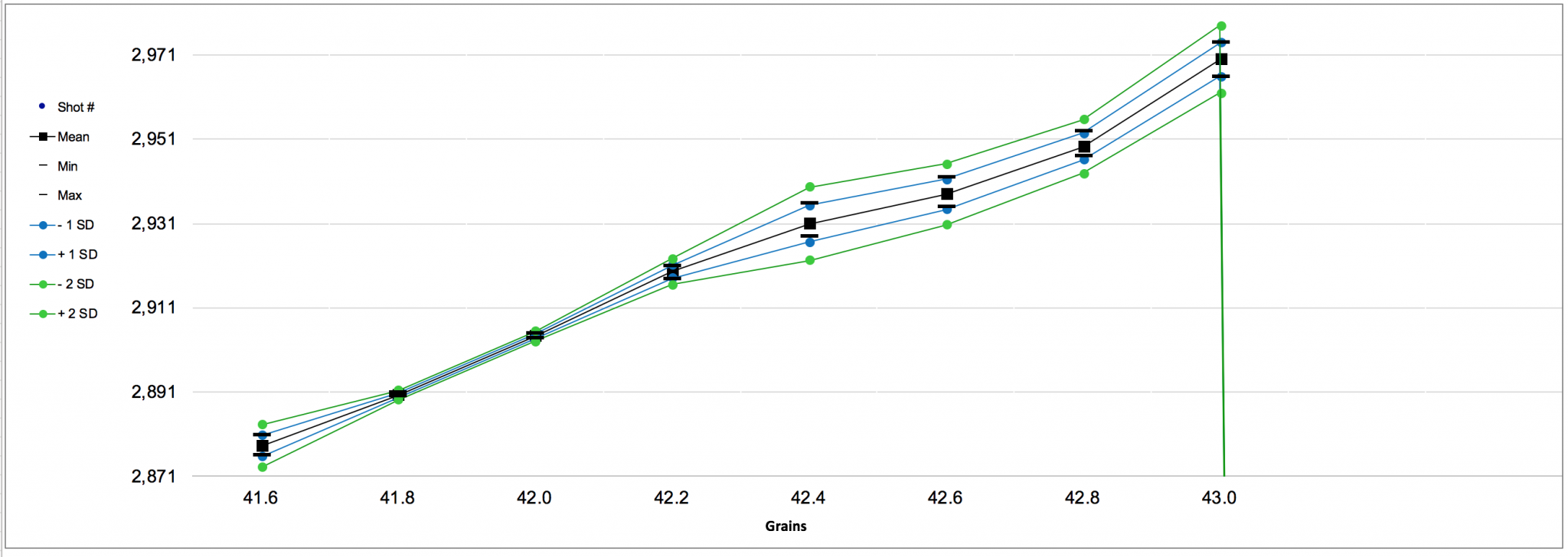

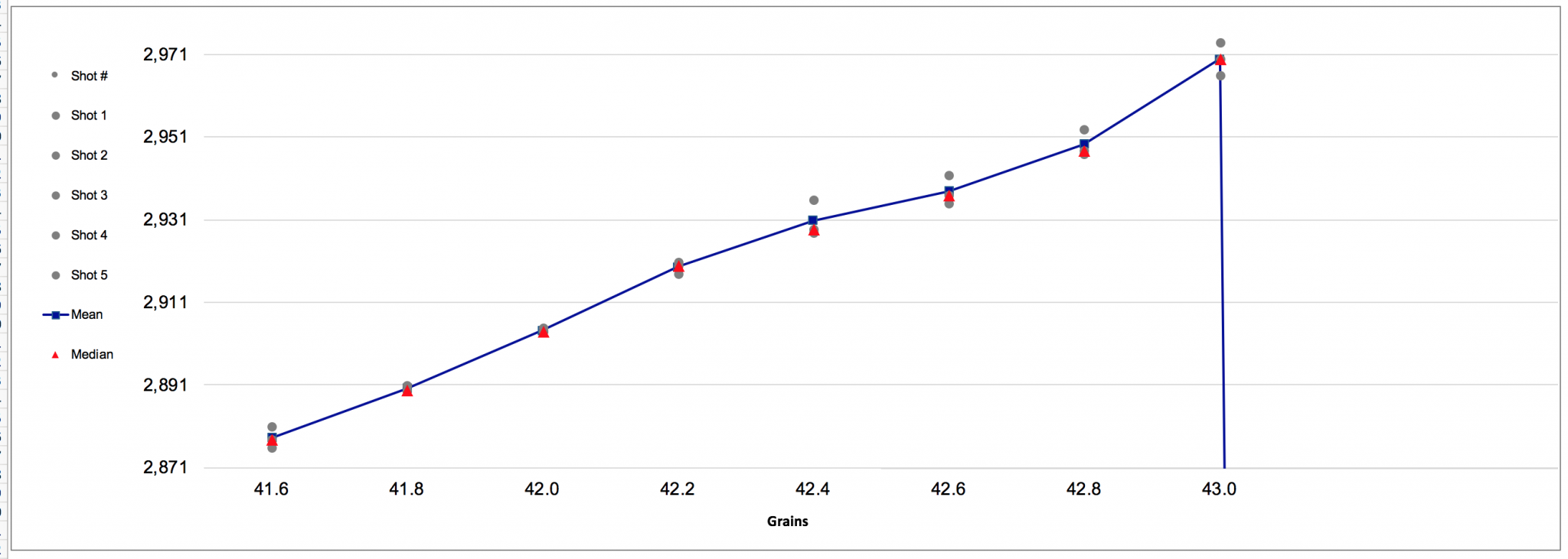

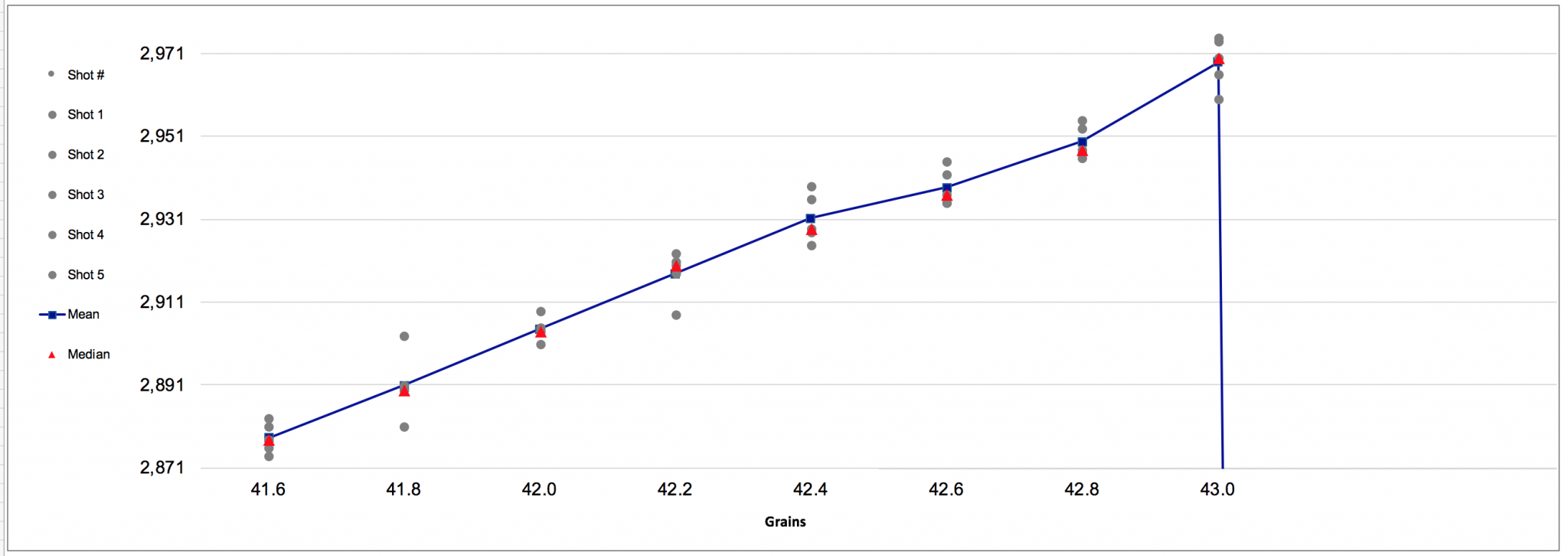

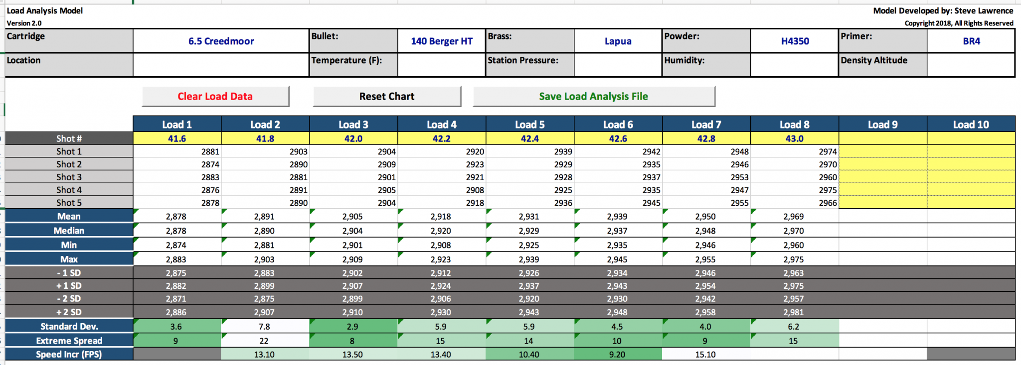

Here is the Raw Data from this morning.
Note, we are shooting the same brass, powder, and bullet weight. Only diff is I'm shooitng Berger vs Hornady. Not sure about your barrel length, twist, or primer.
I'm shooting a 26" barrel with 1:8 twist, BR4 Primers.
Data came from a Magnetospeed V3.
Reactions: parkerg31 and JOE62

This is awesome man I really appreciate it! Ill load a few at 42.0 since thats what you had some good results with and because it is not far off from my current load already.

Also, I’m actually leaning towards ~42.5. I like how it’s flattening out and still maintaining low SD and ES
