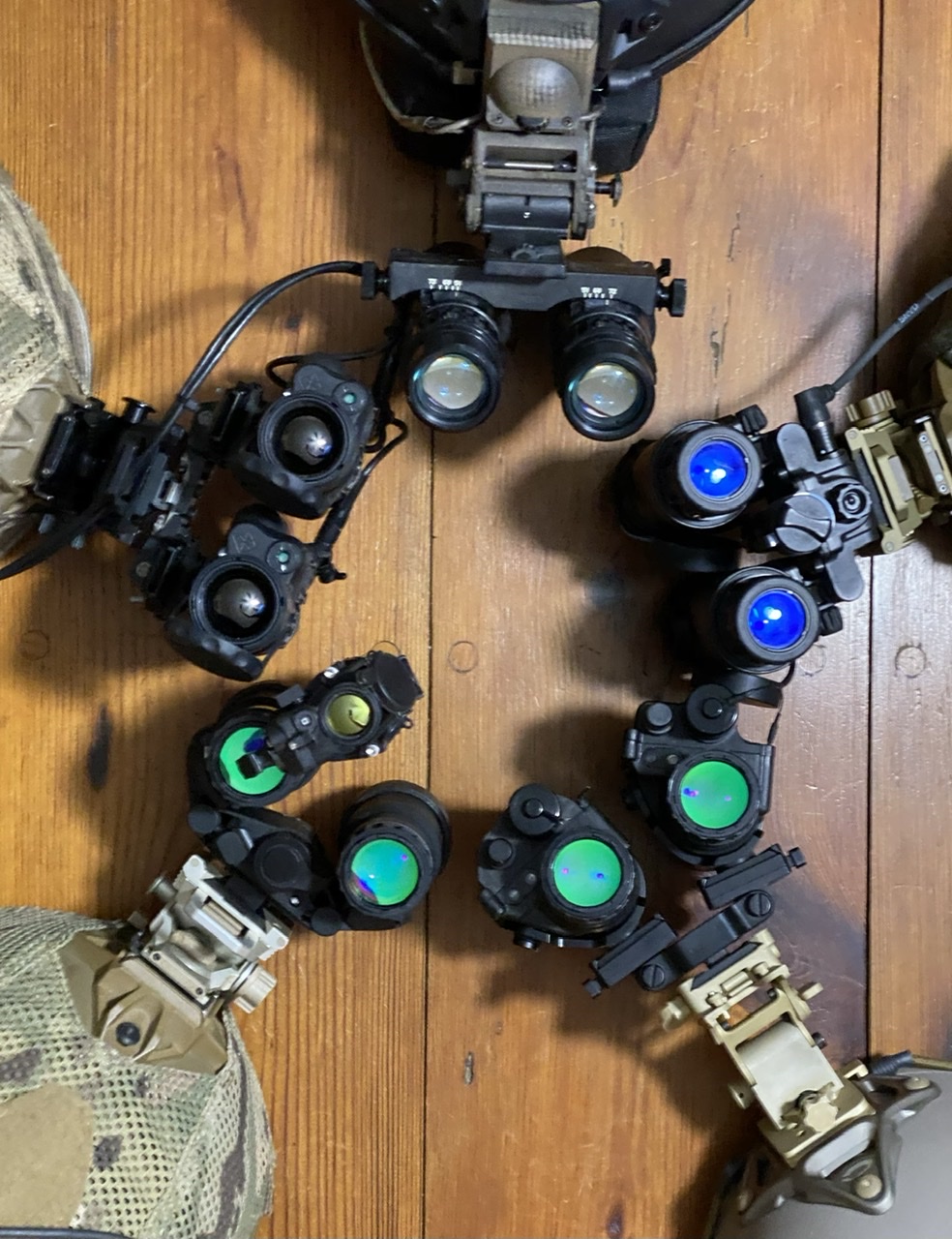

    In my personal goggles I get streaking in one of my tubes. It's also the louder of the tubes I have installed, not sure if that is a coincidence or not.
    I'm not sure if it is different for civilian goggles, but in Army Aviation we do not do any testing for it during the 6month (now 12month) inspections. I doubt civ maint facilities do much more. Mainly just check for unacceptable black spot blemishes, emission points, and resolution. Of course we also check for physical damage and do a re-purge.
    Your objective lens is what blocks certain wavelengths of light. Which is why you can wear them in an NVG certified cockpit. Some vehicle's dashes have the right colors to working ANVIS goggles, but don't expect them all to.
    Also, anvis-6s usually have Class A (or C) filtering on the objective lens, which let's in a little more light (in the red part of the spectrum) than Class B filter coatings which block that.
    The main difference between the two is just in how the objective lenses focus, as you can get different filtering on each type
    Yeah its probably just these lenses. Nothing wrong, it just is what it is.
    I've worn the same pair of 9s for forever now, so it stood out to me as WTF is this? when trying them on.
    I haven’t taken my 6’s out in 18 months. I’ll have to check it out.
