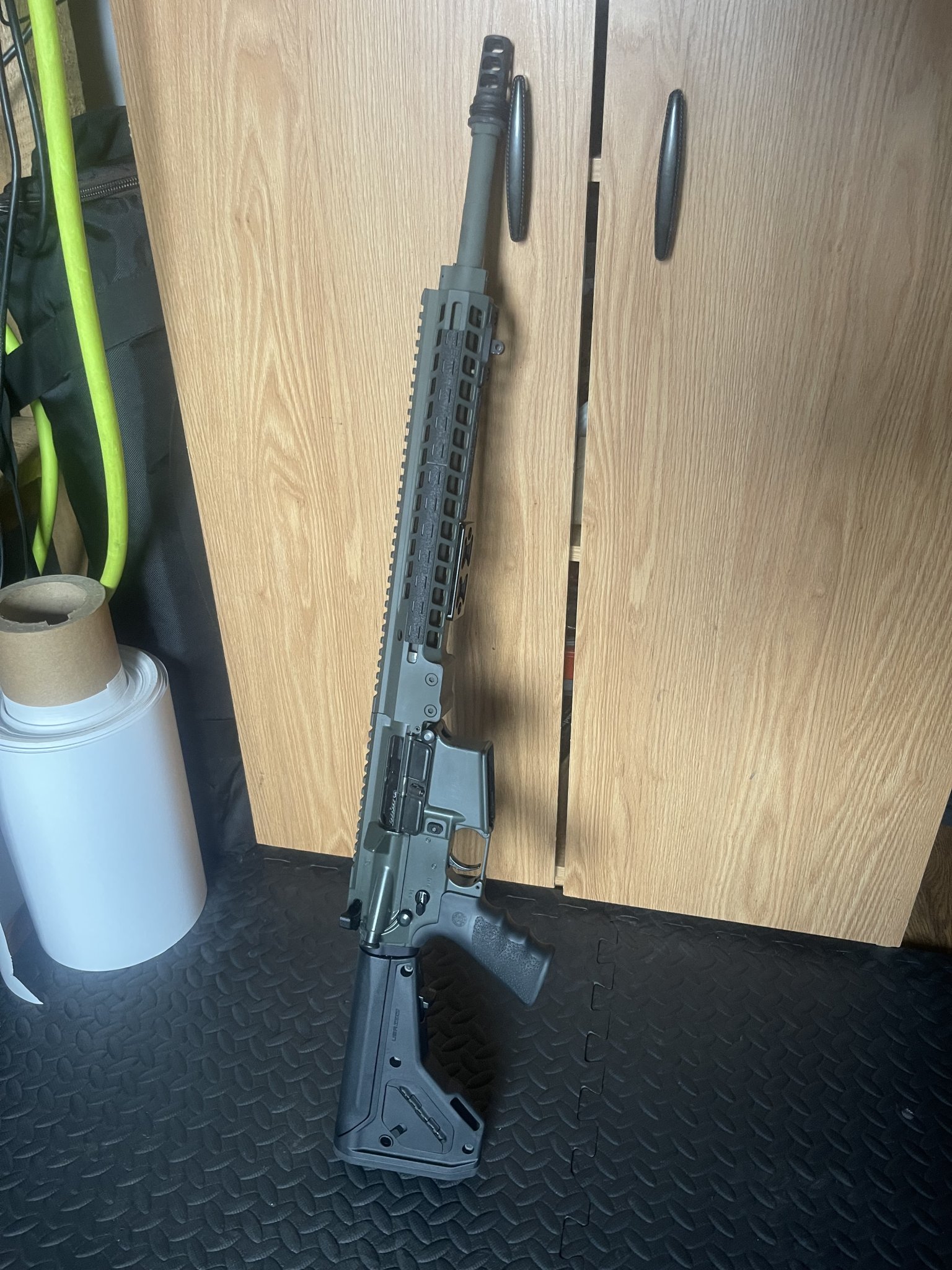

I have a Falkor Caitlyn that I won at an SHC event many years ago. Some of you here have probably shot this exact rifle.

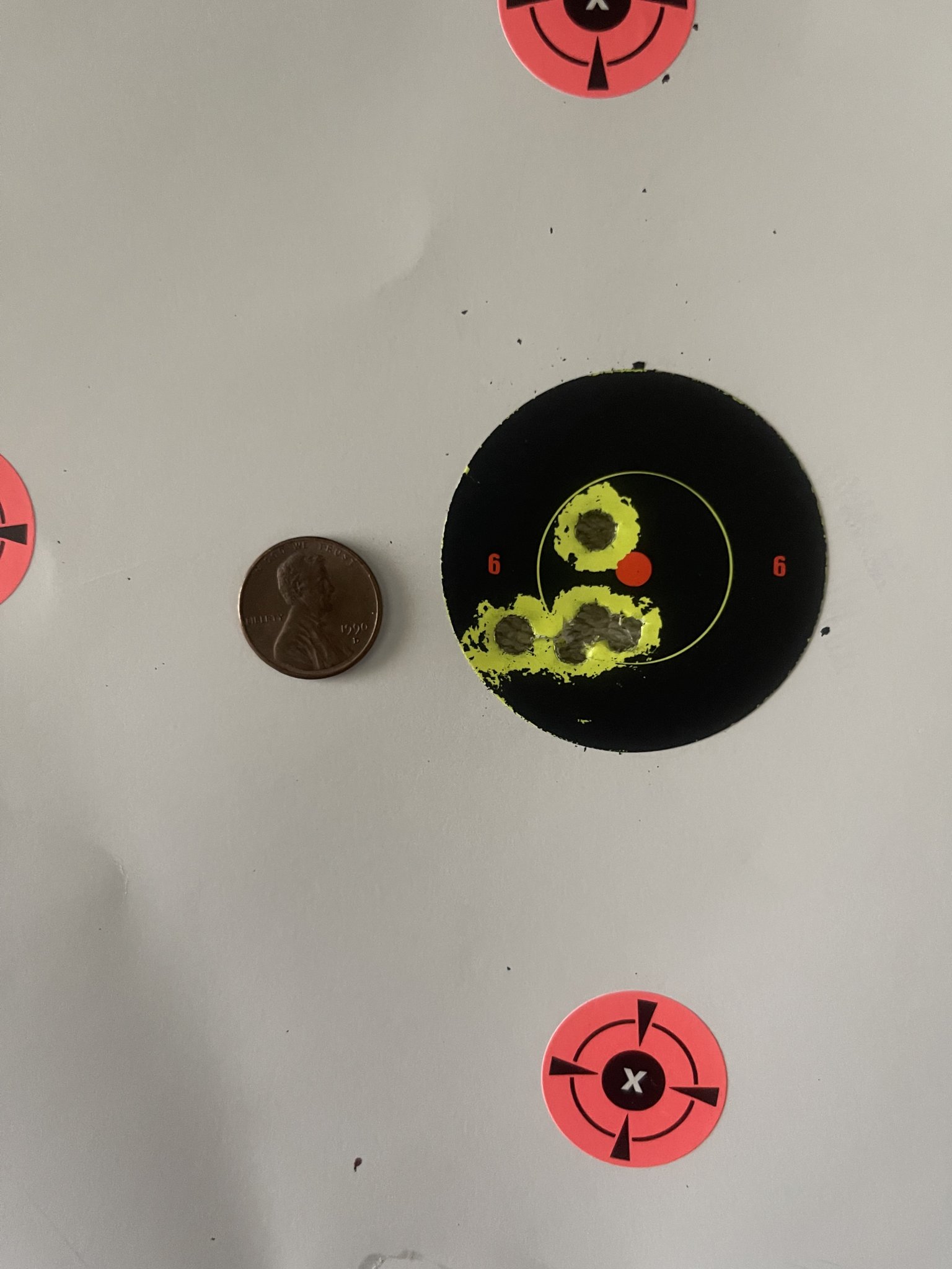

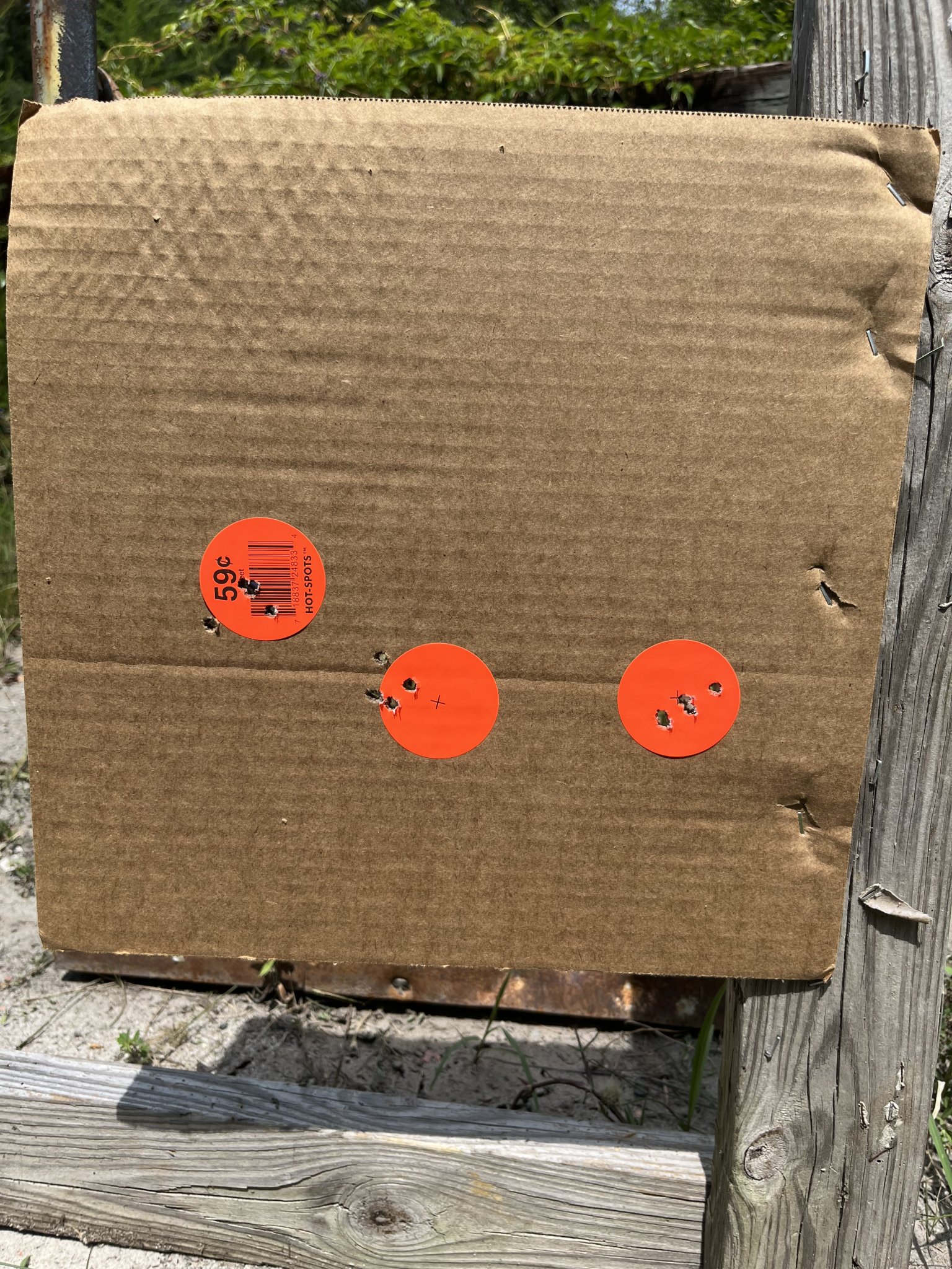

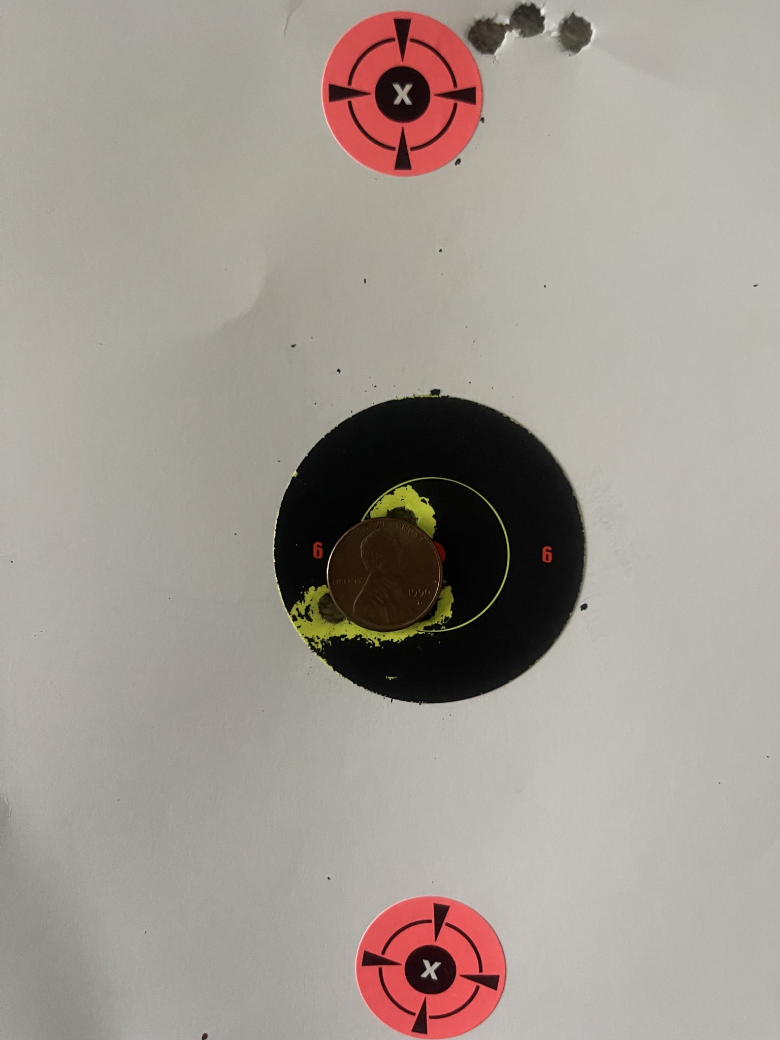

To mix things up from bolt guns, I decided to make this rifle an "SPR". Today at the range I shot some IMI Razorcore 77 and Blackhills 75 match HP ammo. I shot a lot more IMI than the Blackhills, but both ammo produced groups in the 1.25-1.50 MOA range. One group with the IMI was just barely sub 1 MOA. This rifle has a carbon fiber Proof 16" barrel for those curious.
While I understand these are not bad groups for an AR-15, I was hoping for it to be closer to 0.75-1 MOA. This seems to be wishful thinking at this point. However the barrel is likely way over due for a cleaning, so this may be a factor as well.

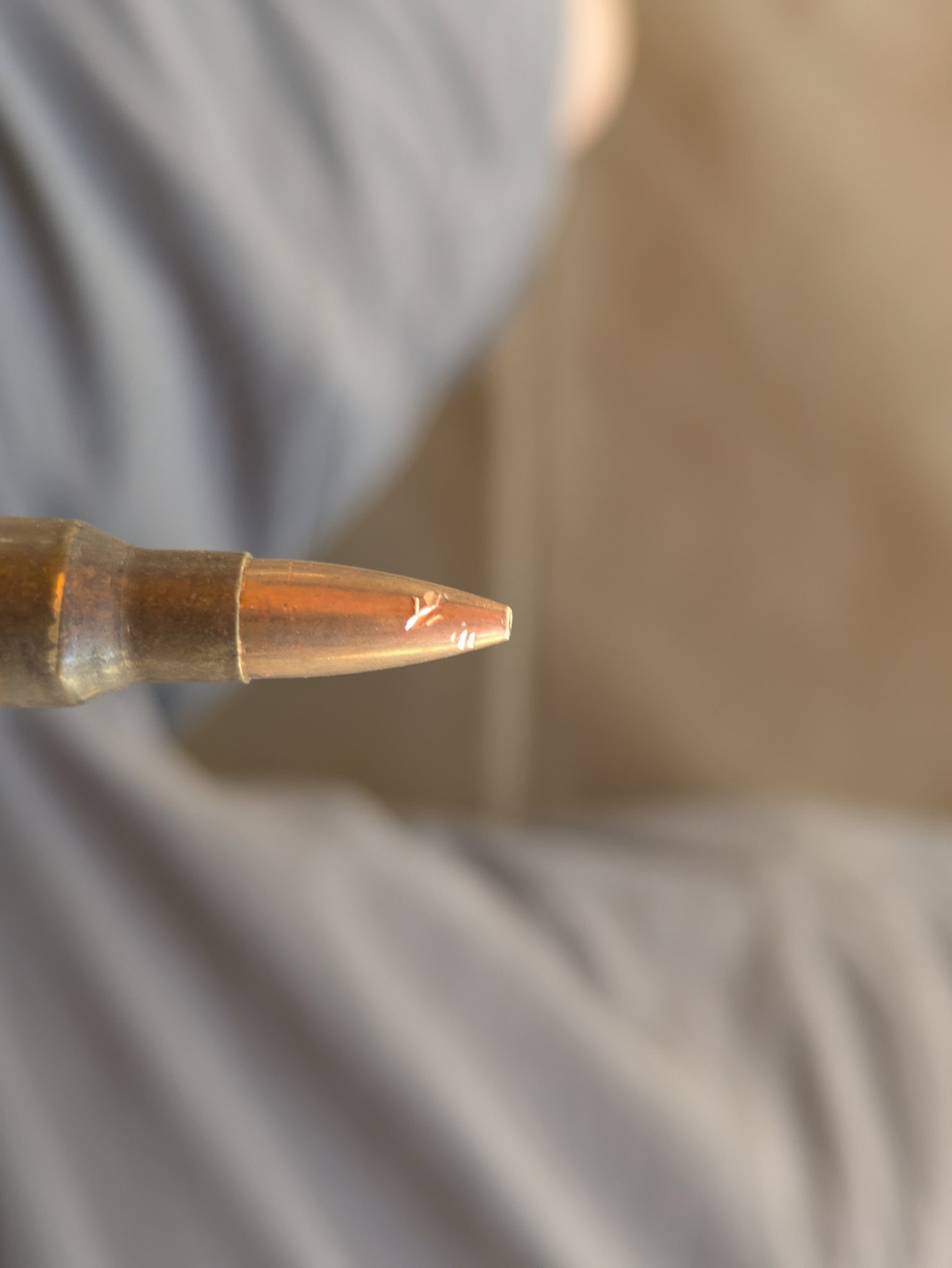

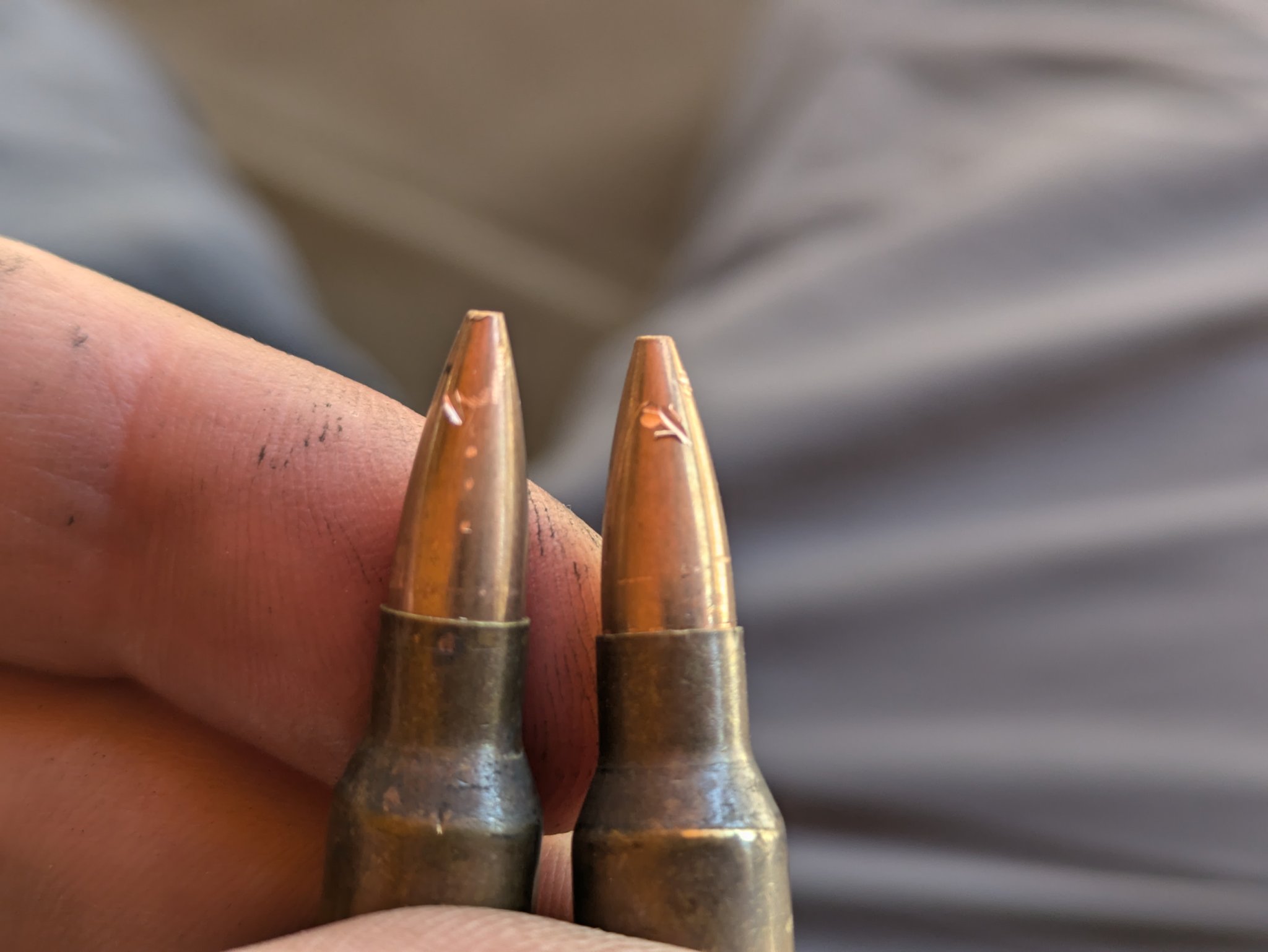

But while at the range, I ejected a few rounds that were chambered but unfired, and noticed some pretty deep gouges on the ogive of the bullets. My understanding is that this is caused by the feed lips in the barrel extension. I emailed Falkor, they didn't seem too concerned with it. I know that this is a somewhat normal thing with AR-15's, however I can't help but think that these gouges wouldn't have a fairly dramatic effect on precision. Maybe not as much at 100 yards, but I'm sure further out it would produce pretty noticeable results.
What does the accurized ar-15 crowd do to avoid this issue? Or is this just the reality with AR-15's that we have to live with? @MSTN
First thing you need to do is figure out if those gouges happened on the way in, or the way out.
When you eject a loaded round in an AR they do not get the benefit of a nice smooth feed ramp. As soon as the projectile clears the chamber the ejector slams it sideways into the lugs on the ejection port side.
Try sending a few home with the bolt release & then eject slowly, as soon as you can get your finger on the brass case push it over to counter the ejector & finish pulling it out.
If I gently put a round in the chamber by hand, close the BCG, and then eject, the projectiles don't get the gouge.
It seems the gouge only occurs when the ammo takes a ride across the feed ramps.

That being the case then yes I would slightly round over those sharp corners. I automatically do that when building any AR. Don't take too much off though, that reduced size lug already has a heavy load. I use a fine stone followed by polishing rouge on a felt.

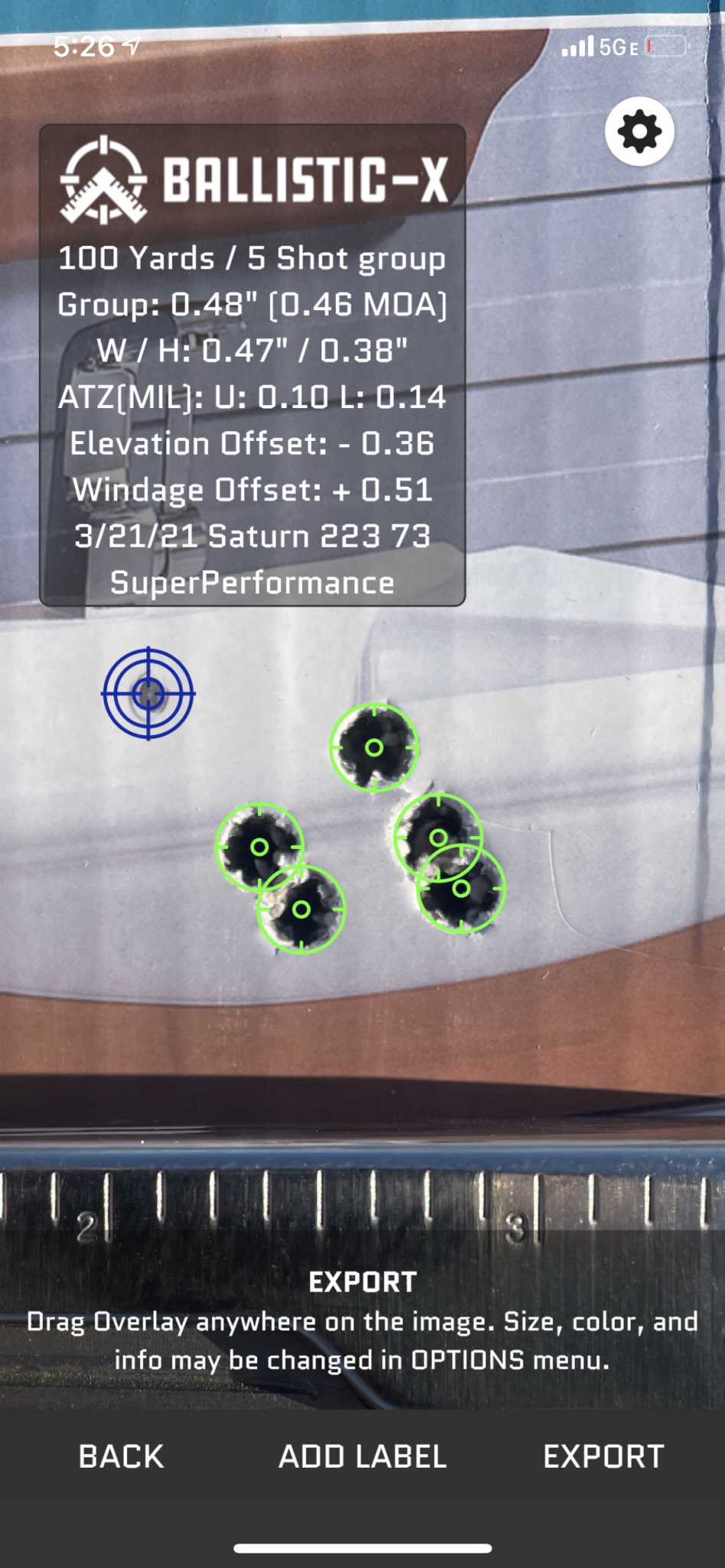

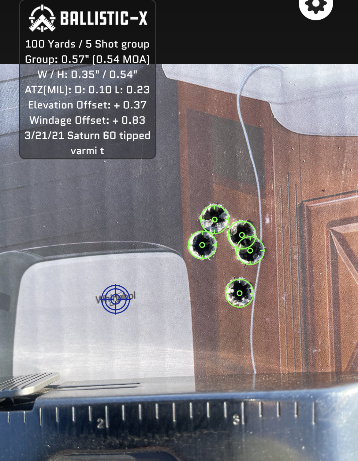

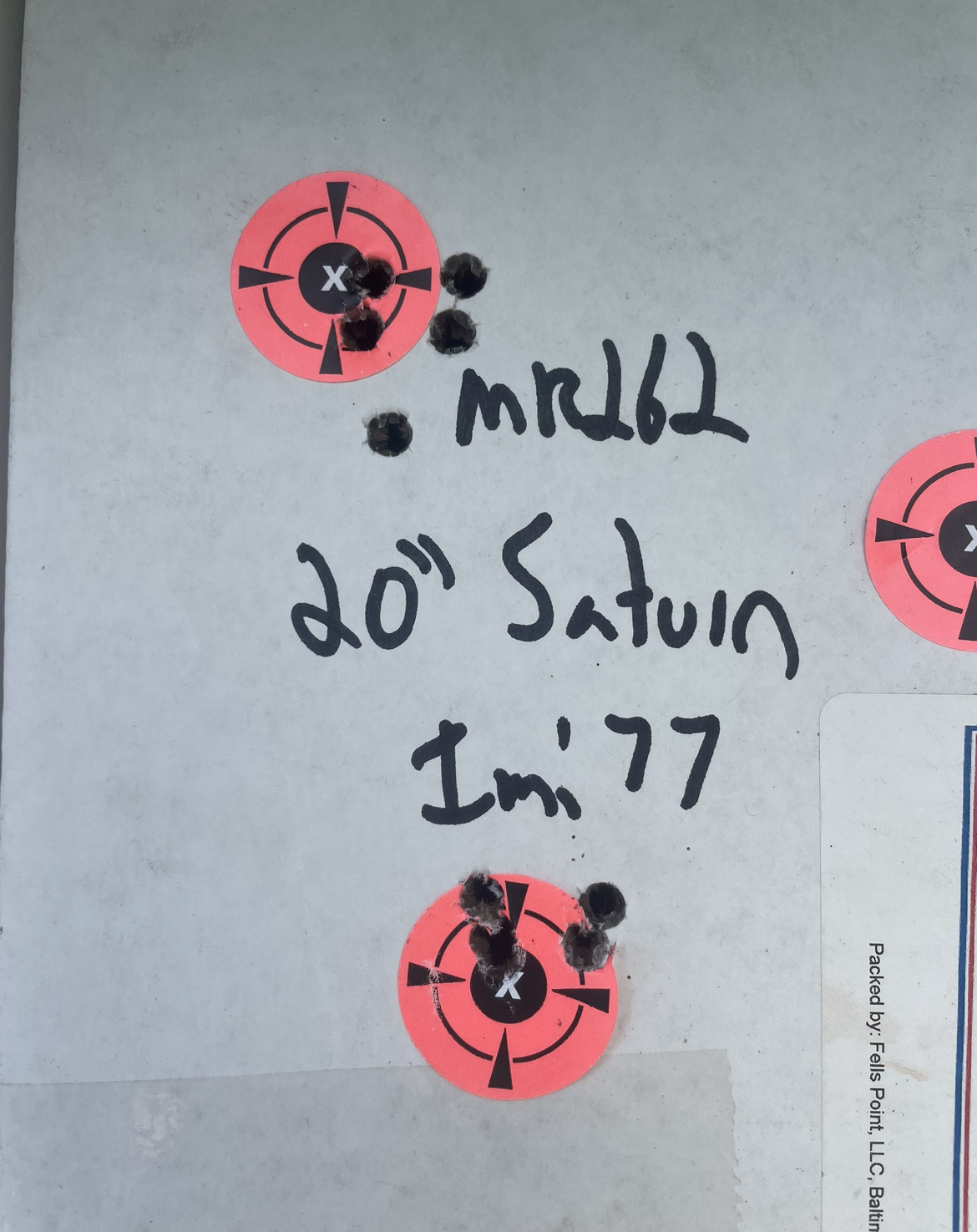

My bartlein barreled SPR/DMR will shoot IMI 77 grain moa or better all day. I have never noticed any issues like you have seen either with bullets while chambering. My barrel extension is a White Oak competition length.
Three consecutive 5 shot groups all sub moa, just barely, but they are.
Reactions: BurtG and kthomas
Those rifles are definitely more accurate than mine.

Those marks are almost certainly from your feed ramps. I’d test a few rounds just running them from magazine to chamber letting the bolt slam home. Mine were so bad it would move the OAL of the round.
I wouldn’t shoot it through a suppressor until I corrected that. You risk a fragment coming off or bullet coming apart if it’s damaged to much. Yours are not bad but you never know
If you’re looking for accuracy then why even test with the scuffs on the bullets.
If you slowly let the BCG forward you’ll likely feel it hang up on the feed ramp
Obviously test this safely or load dummy rounds without primer/powder

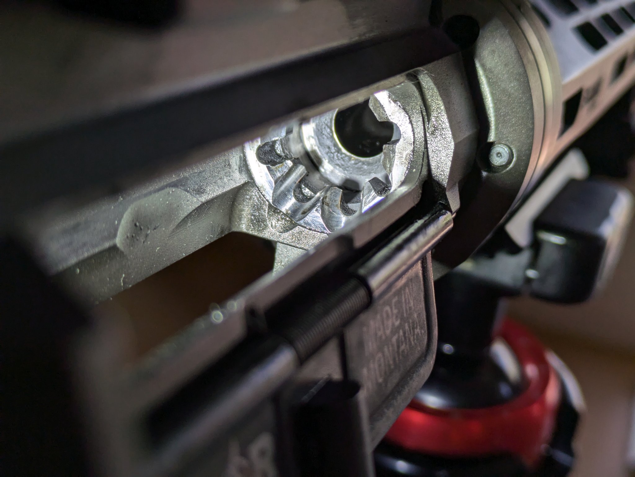

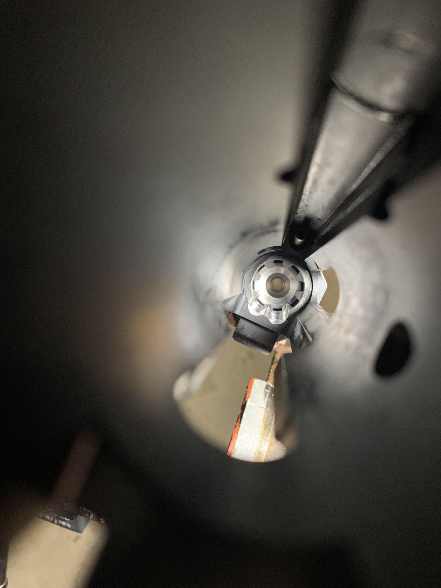

Are you seeing this?

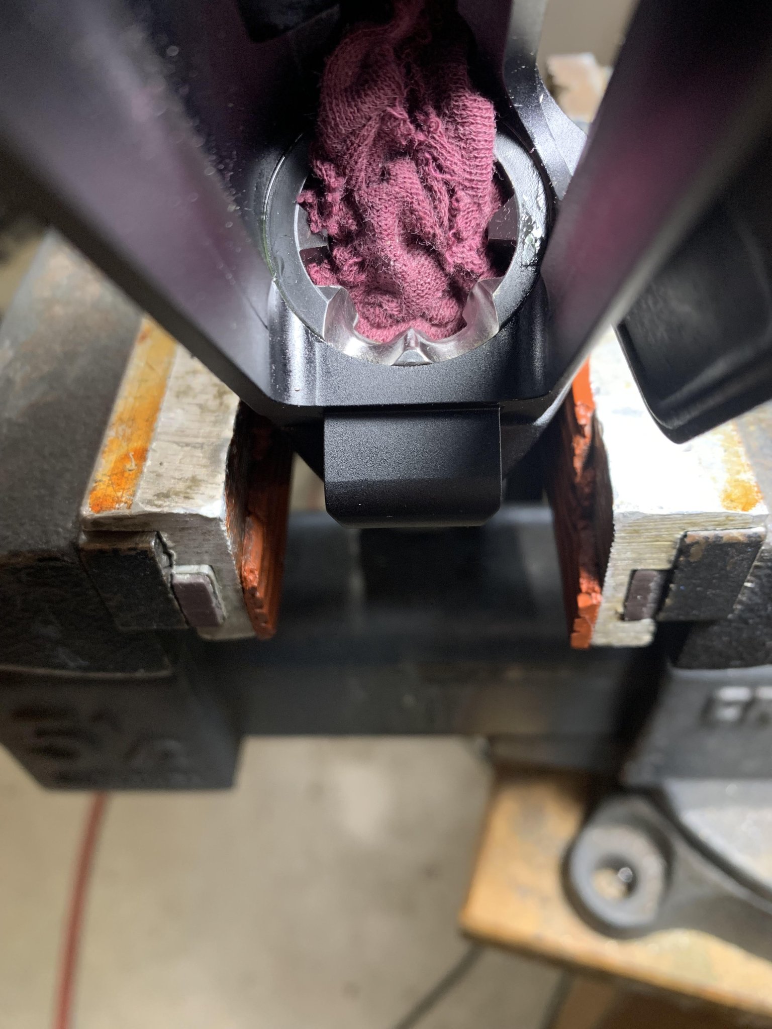

That barrel extension is fooked. If your bolt lugs look OK and you haven't stuck one of them action rod tools in there, then Falkor buggered this up during assembly. Probably jacked up the feed ramps at the same time.
Interesting, good catch.
Bolt lugs look just fine. I do have a reaction rod, used just once on the rifle to change out the muzzle device. So I guess it could've been caused by me, though I don't recall being ham-fisted enough to roll that edge like that. But hey, I've certainly have achieved dumber things before.
Unlike that one edge, I don't see any obvious damage to the feed ramps. What am I missing there?
That's a non-M4 ramped receiver with an M4 ramped barrel extension. It'll still work.
That is a large frame so M4 may not be the best description & yes having the ramps stepped back is acceptable to some.

Never mind the match to lower For @kthomas question. Look carefully at pictures to see how the sharp corners at sides of feed ramp were just slightly blended so it wont score the bullets.
Whatever was stuck up into the barrel extension looked to have been torqued in both directions to have peened both sides of the recess. To me, that would relegate at least the barrel extension to the dumpster, nevermind trying to polish out the feed-ramps.
Edit: The same tool (not you) that caused the damage to the locking lug recess may have raised an edge on the trailing edge of the feed ramps.
Appreciate you pointing this all out to me. Looks like I need to get this barrel extension squared away.

Yeah, look at how his 8 o'clock locking lug recess is peened. He's got bigger problems than trying to blend in feed ramps.
Your upper arrow I can't make out enough detail in the pic to make any conclusion.
The lower arrow, it looks like a chip in the lug, but on the mag well side. Cant tell from the pic if this chip/deformation goes all the way through. As long as the bolt lugs pass through the extension lugs smoothly without any drag I'm not throwing a Red flag. It's the back side of the lugs mating surface that really matter. Inspect the matting surface of the bolt lugs & maybe use a bore scope to look at the back side of the extension mating surfaces. As long as that all checks out I'd go forward.
Assuming the above is ok, I'd check head space next. If that's good I'd de-bure the corners that flank the ramps and run it.

Addressing your original post...The round was gouged because you ripped it back out of the chamber backwards against the sharp feed ramps... Of course its gouged. Nothing wrong with polishing the feedramps.

FWIW I have a custom White Oak barrel I had spun with an intermediate length system in 223 Wylde. I built it on Seekins billet upper and lower, with a BCM Mlok handguard. Using a Young Manufacturing chrome national match bolt carrier. The gun will shoot sub MOA all day long with 77g SMKs. Your feed ramps are ok? Could be a mag issue too

is there any shingling between the feed ramps on the upper and the ramps on the barrel extension?
they should be blended as smooth as possible with as little to no transition between the two as possible
are your rounds sitting too low and feeding too low? could you try different mags to maybe present the rounds higher so they don't jam into the ramps so hard

Can’t find many group pics but : Consistently a way under moa rifle and I’m not even a good shooter.
Load testing when I got the used rifle in :
Testing gas gun match ammo
OP , do you have another semi that shoots well ?
Semis are a whole nother animal in terms of accuracy forgiveness for perfection shooting position
Here’s a Douglas I have when I zeroed it :
Then this group shows what happens when I get lazy especially with follow through
I can catch a fingernail where those feed lips connect. There does seem to be slight shingling.
I can have a look at different mags.
