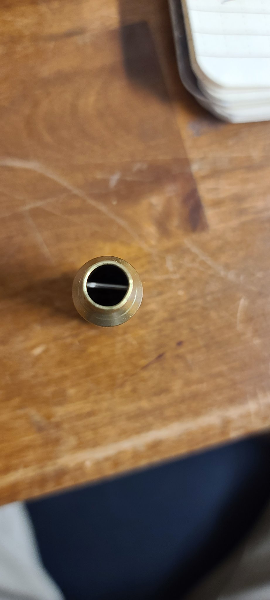

Question for the guys using SS tumbling media
ForgeValley
Major Hide Member
  • Jan 22, 2018
    2,436
    3,841
    WNC
    This ever happen to you?
    That's a piece of media stuck in the case mouth.
    I just started using SS media, and my process was to tap each case to make sure all the media was out. Clearly that wasn't a good process.
    Any thoughts on what would have happened if I had loaded this case and fired it?
    Stop using that crap and tumble the cases without it. It offers no benefit.
    I think that is some good advice, because even if it offered some benefit I'm not sure it's worth the hassle and potential risk. Looks like I'm going back to straight wet tumbling with cleaner. :)
    Sure, you’d have scratched the bore, plenty of folks have done it. Not good.
    The thing is you need to lube, resize, inspect, prime and charge the case.
    If that piece of steel is still there after all that then its on you.
    From my experience, if you need the inside of the case necks clean then use the pins, if you
    dont need the inside clean then there is no reason to use them.
    You should be inspecting cases prior to loading them. I use a media separator and it usually bangs the cases around enough to dislodge stuck pins. Sometimes I get what you see and/or pins stuck in the flash hole, but not very often.
    A good practice is to tap the necks on a hard surface once the brass is dry. But if you still have a pin in there and load it, nothing will happen. Wet dreams of pins gouging up the bore are a product of mechanically inept Democrat retardation. I’ve been cleaning cases like this since SS tumbling came to the reloading scene and have never seen bore damage. It’s not a concern.
    Brass juice cleaner with no pins gets my brass every bit as clean as lemishine, dawn and pins, and you don't need to go through all of the extra steps. Went away from pins for rifle brass when I realized I didn't want to blow out an induction annealer with one, then just realized it is better overall. I am sure there are other cleaning formulas that work just as well, but the Brass Juice is good.
    I haven't had that happen (yet).

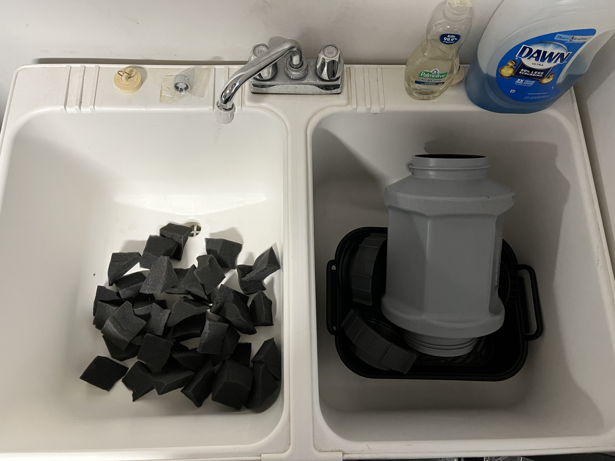

    The "secret sauce" I use (and recommend) is that I cut up some old Pelican foam that I had kicking around, and I add a bunch of pieces of foam to my tumbler lastly before I close it up and start tumbling. The foam floats above the cases and pins and takes up the open space and volume inside the tumbler. The foam stops the cases from building up much momentum and keeps them from crashing into each other as much or nearly as hard... no more fucked up case mouths.
    I get them stuck like that every now and then in my 300wm. I load several others and it does not happen. after seeing it for the first time, I double check. mostly because I had a case split rite down the side out of nowhere. Primer was normal and base had no ejector mark. I always thought it may have been a wedged(or not) pin in the case, as most people I asked replied with "shit happens". Rarely an acceptable answer in this sport.
    In my experience with SS media, this happens all the time, needle nose pliers always at hand. Worse is that two pins will get stuck in the flash hole. This requires the same pliers, but it can be difficult to pull them out. I have never lost a case to damage and the SS media does a really good cleaning job, so I stick with the pins, My $.02.
    That has never happened to me. Looks to be very easy to dislodge. What’s the issue?

    happens to 6.5 cases
    not good if you anneal with an AMP and it falls out, expensive mistake that would be.

    I use the pins and I've found a few cases that had the pins stuck in the neck. I have also found 2 pins stuck in a flash hole. I just make it a point to look closer for this. I use a small pair of needle nose pliers to remove them.
    If you had loaded and fired that piece of brass you could have possibly damaged your barrel.
