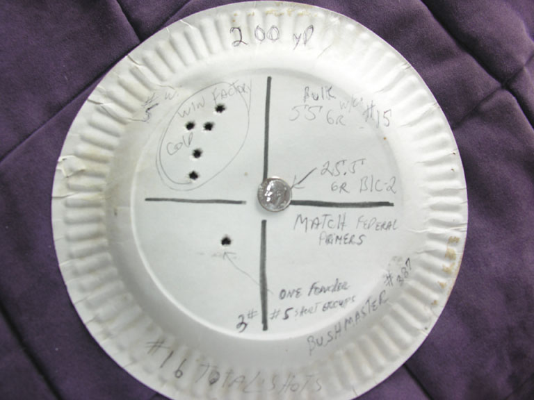

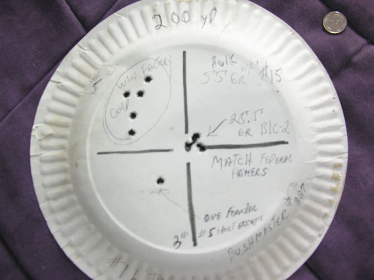

    I did this off the dirt NO mat at a LEO BBQ/Picnic Accuracy demonstration one afternoon ,so as to demonstrate the benefit of loading your own . With BLC-2 Bulk bullets with cannelure no less and 1990 LC cases . Note the classic Paper BBQ plate target ;)
    Back then MY Bushmaster wore a Simmon AETEC 2.8X10 44mm scope ,not exactly a precision piece of glass but did well enough on 6 power at 200 yd. .

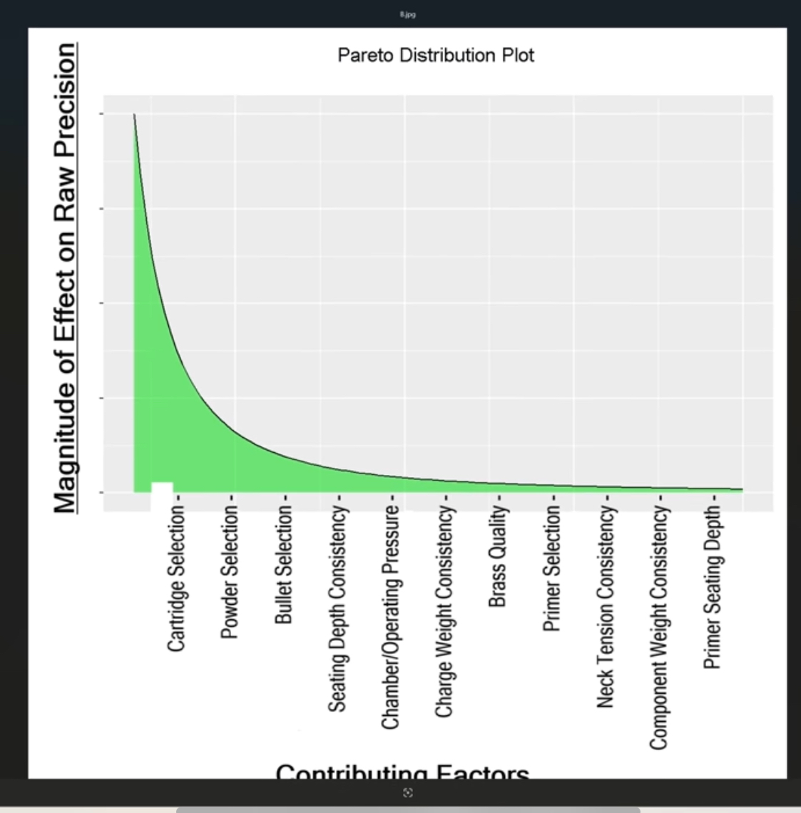

    Don't know if you saw this in another thread, but the graph produced by Little Crow Gunworks should give you some idea as to the relationship of things that effect things like SD's and precision the most:
