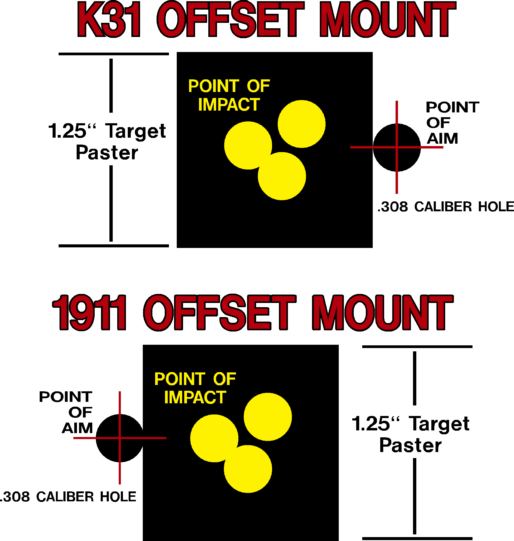

The Diopter sits dead center to the axis, but if you use a scope on the Diopter mount you'll need to check the FAQ for correct zeroing. It's the same as the M1D Garand.
The attached rendering is the sight picture setup virtually all of us here at SP use for Swiss Rifles as well as for the M1D Garand Sniper.
The offset of the mount is 11/16", so leave it at exactly that POI at 100 yards and it will remain so out to 1,000 yards. No need to zero it on the bullseye. If you do, the POI will change the further out your target is.

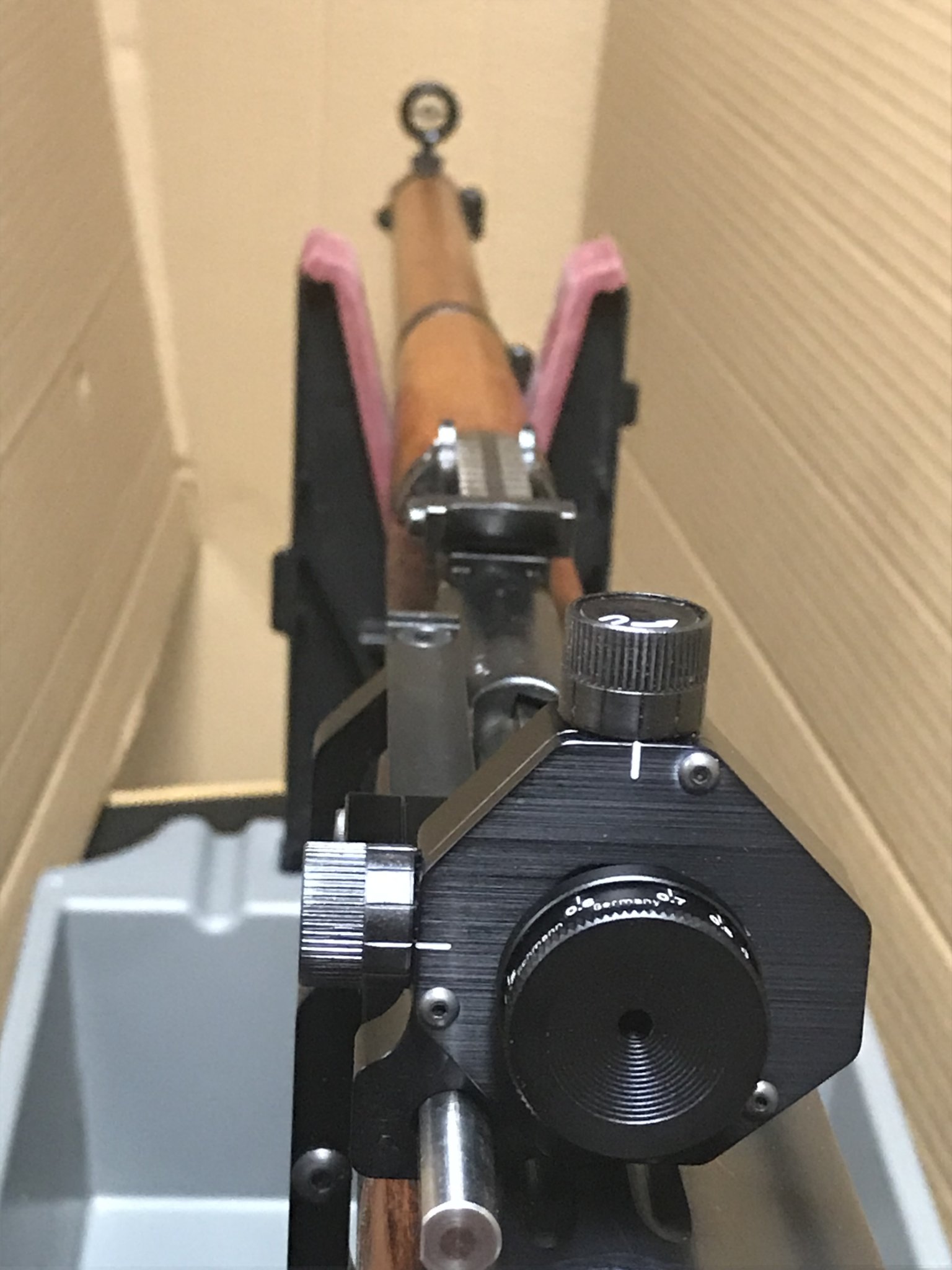

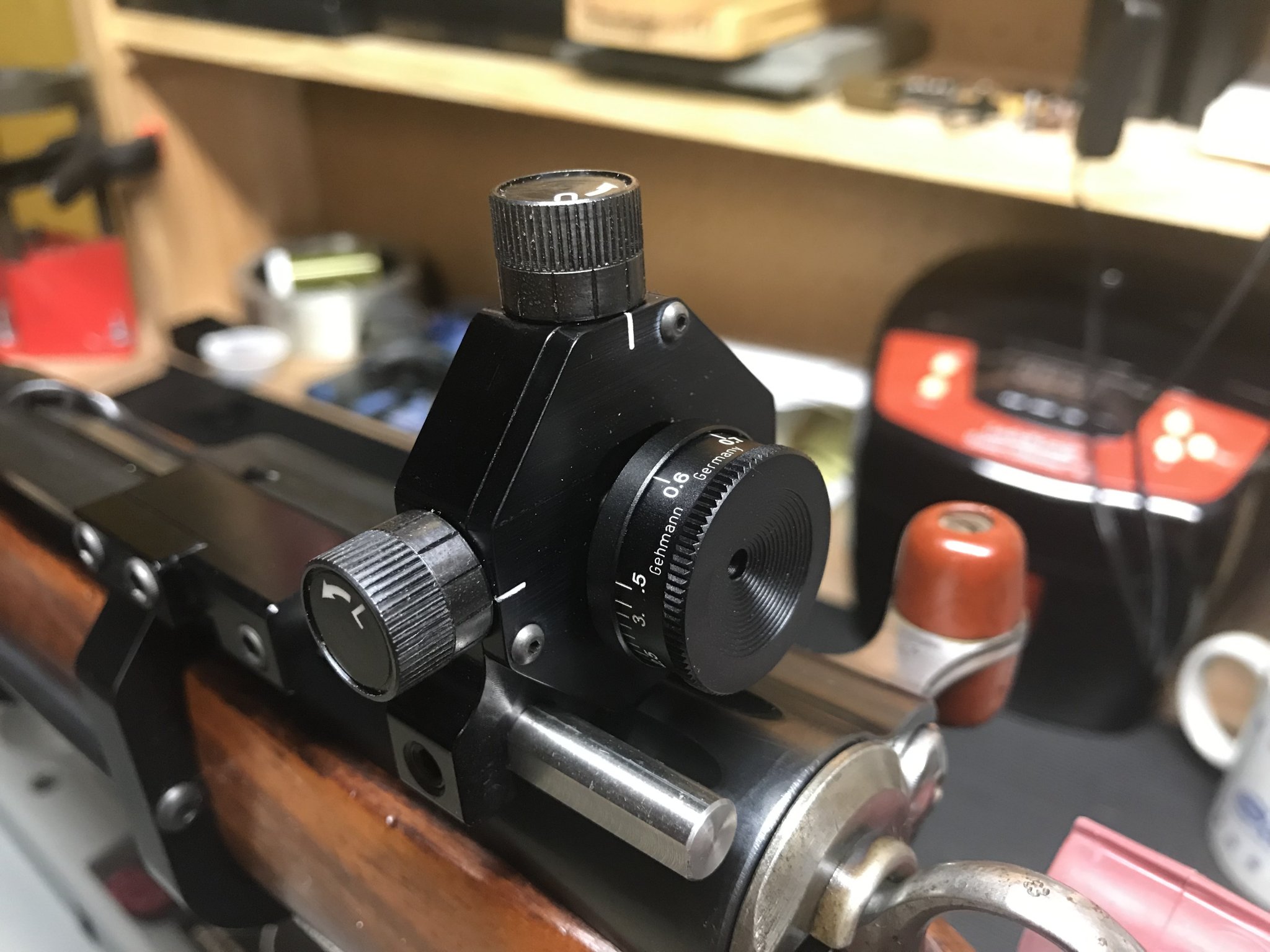

Installed. Easy enough. Certainly a quality product. Is there a rule of thumb on rear aperture eye relief distance? Obviously, moving the diopter fore and aft has the same basic effect of that you get by adjusting the actual diopter...so how does one find a balance? Perhaps I’m missing something.

One more question if you don’t mind. How does one remove the diopter lens from the main mechanism if I wish to change or update it?

Get as close as you can to the rear aperture without getting hit in the face, or exerting yourself to reach further forward.
Ie: lay your head down on the gun, and bring the aperture as close as you can get it.
...but besides. On that rifle, you can’t get close enough to the rear sight to dent your eyeball.

The front aperture that comes with the diopter kit is a random size, just what happens to be in the aperture bin. It will all depend on the distance to your target as to aperture you use. If you bought the aperture kit then you have a selection. If your target is at the 300 or 400 yard range, you select an aperture that just encircles the target itself. Your rear iris should be no further from your eye than your scope. The objective is to close down the rear iris just enough to leave a small ring around the center of the front aperture and target. This should put you in good alignment for repeatable points of impact.
