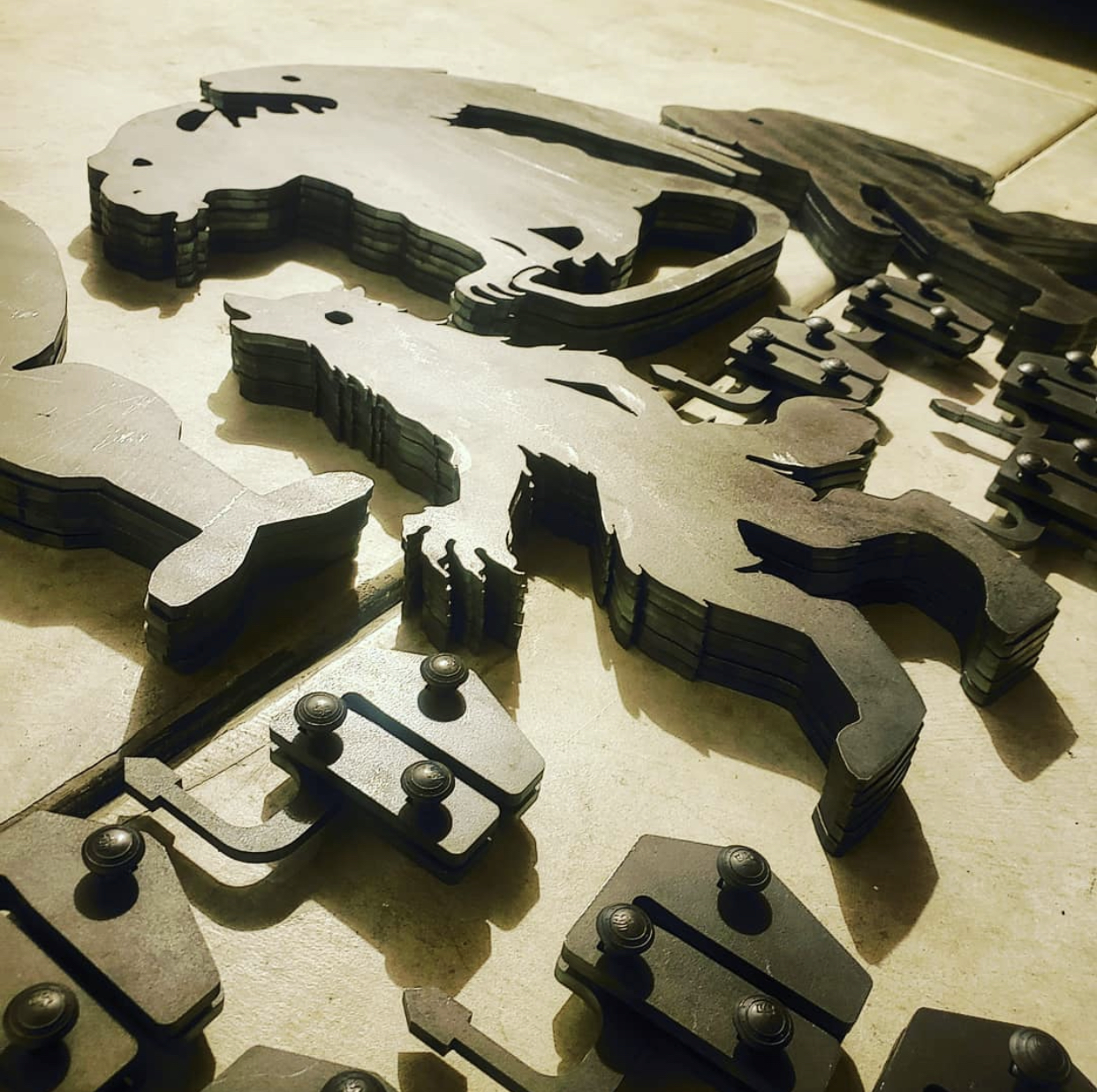

thats a cool ass target! water jet?
plasma, we cut a bunch of different types for our club. Hardtargetco did them for us. It’s a local target company in SoCal. Hit me up if you want their contact info
aliens, werewolves, gargoyles, bigfoots, all different size IPSCs and other shapes.

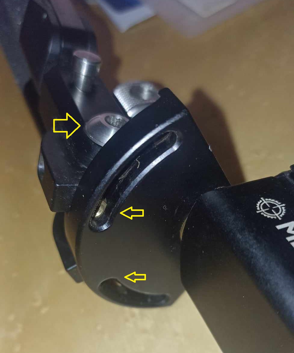

Does anyone know what kind of threads are used on the Gen2 MDT bipod for leg angle push knobs
Do you need to add a thread locker to them?
After having them fall out, nearly all the time, and my range routine since i have the Ckye pod includes checking P*S that they are not loose every single time ,i finally lost them irretrievably this time around.
I haven't seen a bigger POS than this MDT Ckye pod ever and then some. Been a pain in the ass since i got it lost both pins on the 3rd outing(luckily fell off in the rifle bag)
Today i actually found the large bolt for leg rotation loose as well, unthreaded 3 turns or so. Seriously what gives? do you need to carry allen key taped to the bipod?

For the leg bolt, you can use 65-70 inch pounds, and no loctite will be needed. However, if you do, just reduce the torque value by 20%. As for the width adjustment pins, you can use some blue loctite to keep them from backing off. If you need a new set of pins or still having issues with the leg bolt, please reach out to us at [email protected]
