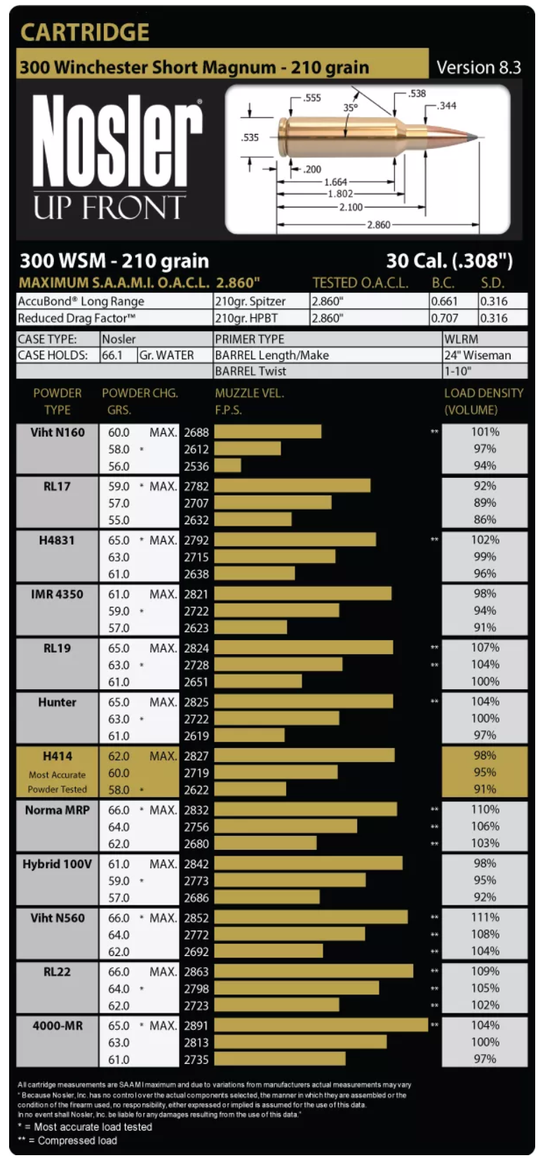

    Here is the Nosler data which might help, you might have seen it already.

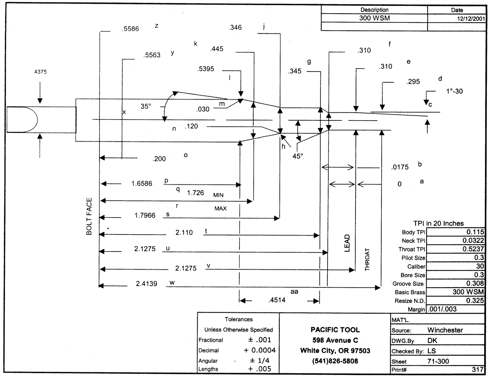

    @XTR what reamer specs are you planning on going with? I am not an expert when it comes to reamers but from what I can tell a SAMMI would be about as good as gets if running out of the AICS mags. As far as I can tell it has zero freebore, which I think would be the best possible solution with the bullet seated so deep in the case. But I am not sure my thinking is correct.

    Looking at the Nosler data above the Long Range Accubond bullet they are using is 1.550" long and they show a OAL legnth 2.860, so I think at 2.950 in a AICS mag you could still get decent velocity out of long bullets.

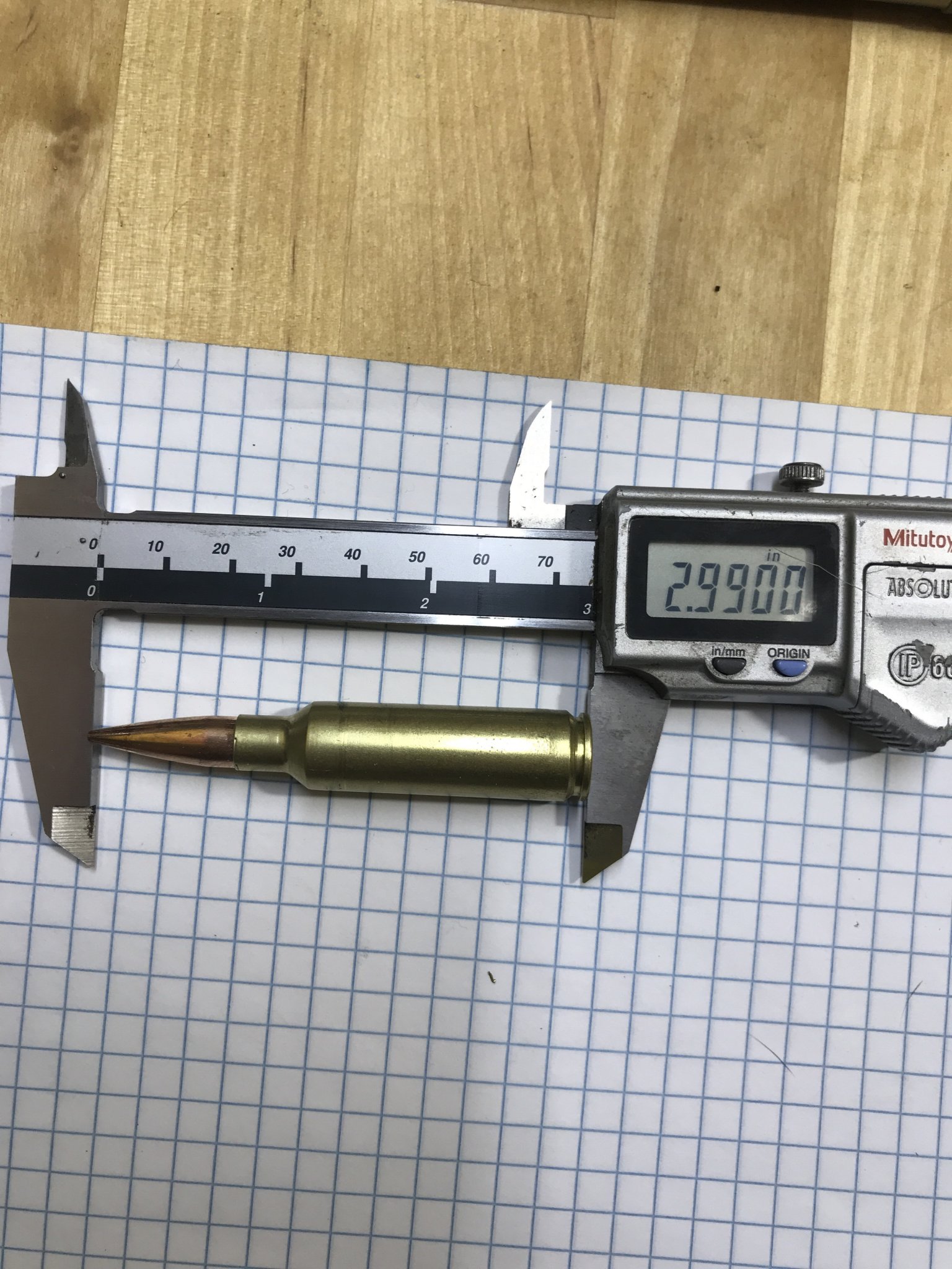

    This fits in a model 70 bdl just barely.
    .230” freebore
    210 hvld .010” into the lands
    2850 from a 26” barrel
