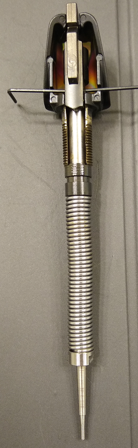

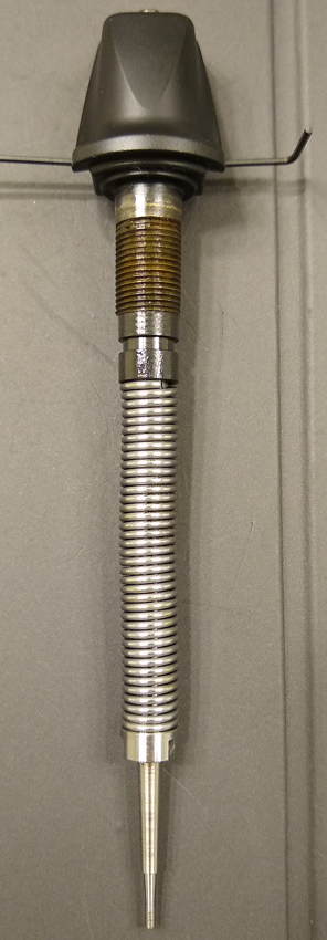

FYI,

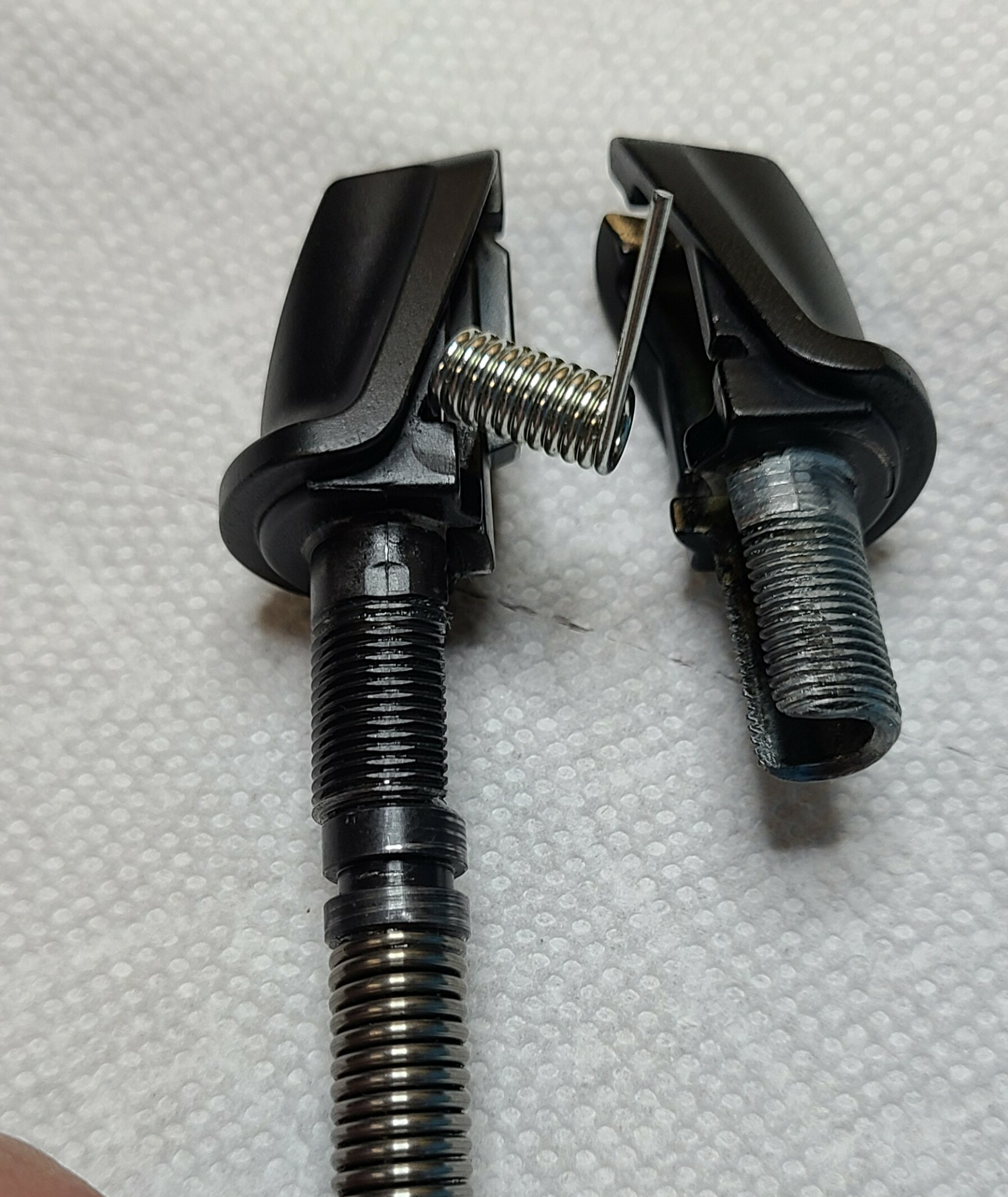

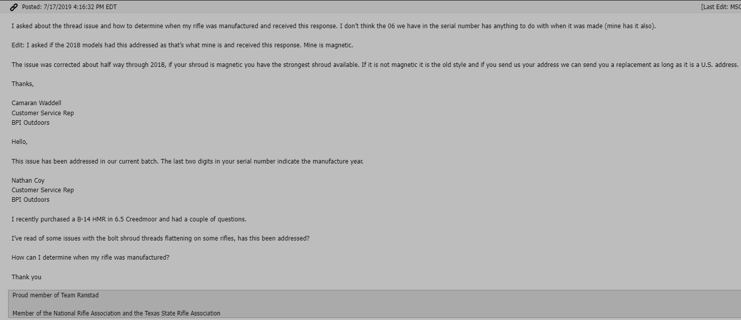

This bolt looks bad after 300 rds. Threads start to flatten. It looks like the changes made half way through from 2018 if we can believe the posts below.
They come like that NEW the threads do not wear flat spots on the side of the shroud.
The shroud on the left is the new steel shroud the one on the right is my old non steel one with over
3K rounds on it. Both have flat threads.

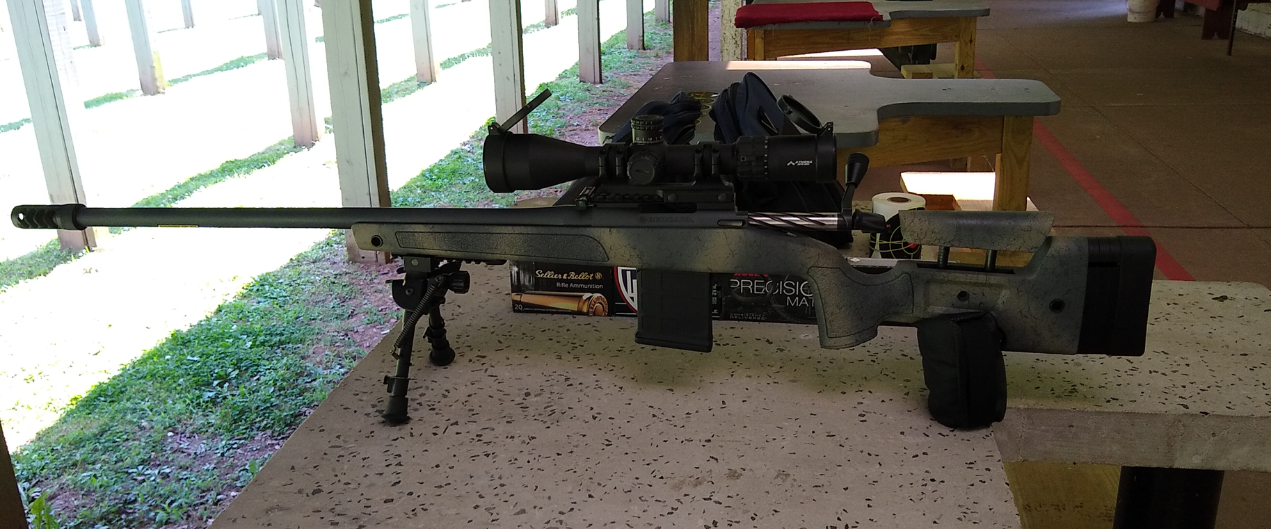

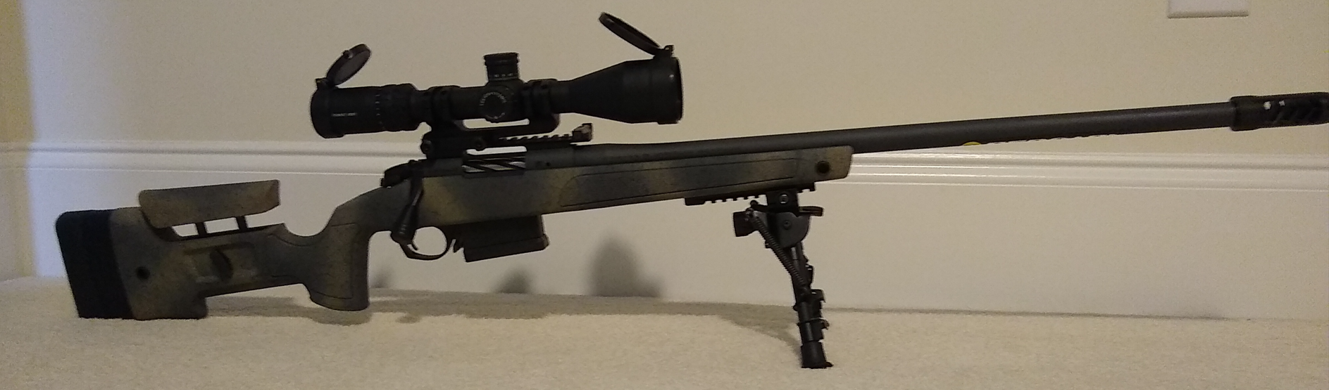

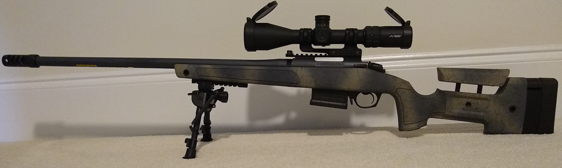

I got my Bergara Wildness last week and set it up.
I used to have a Bergara HMR Pro in 6 CM and really liked it. You should like yours as well - for a first upgrade, look at swapping the trigger. Moving up to something like a TriggerTech Diamond will make a big difference.
One thing I noticed about your pics is the mount you used for the scope. Why are you using a cantilever style? It's forcing your scope up pretty high and there is really no need for it.
The main reason is I can skip the scope ring alignment and lapping process. All my AR and AK used the similar style scope mount. They worked pretty well.
Modern high-quality rings also avoid this issue if paired with a quality base.
Not trying to knock your choice, just wanted to let you know that most of us don’t align or lap rings and still get great results.

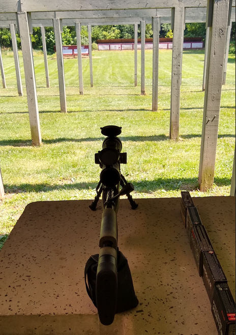

Hi,

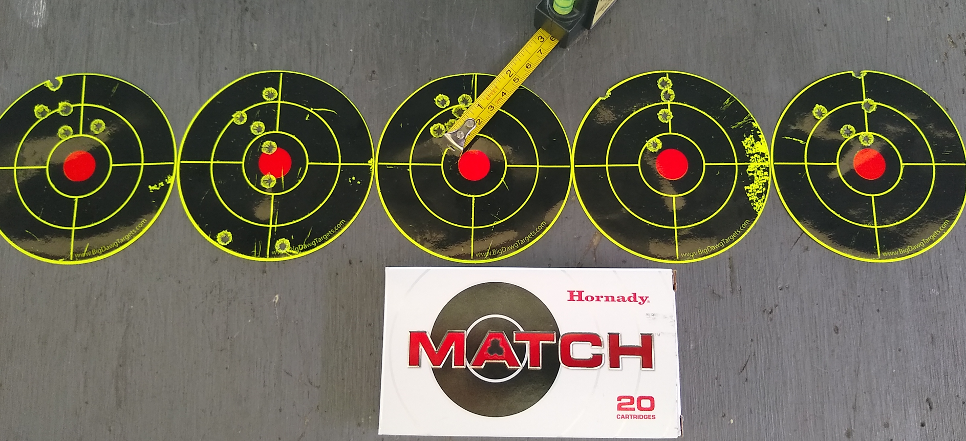

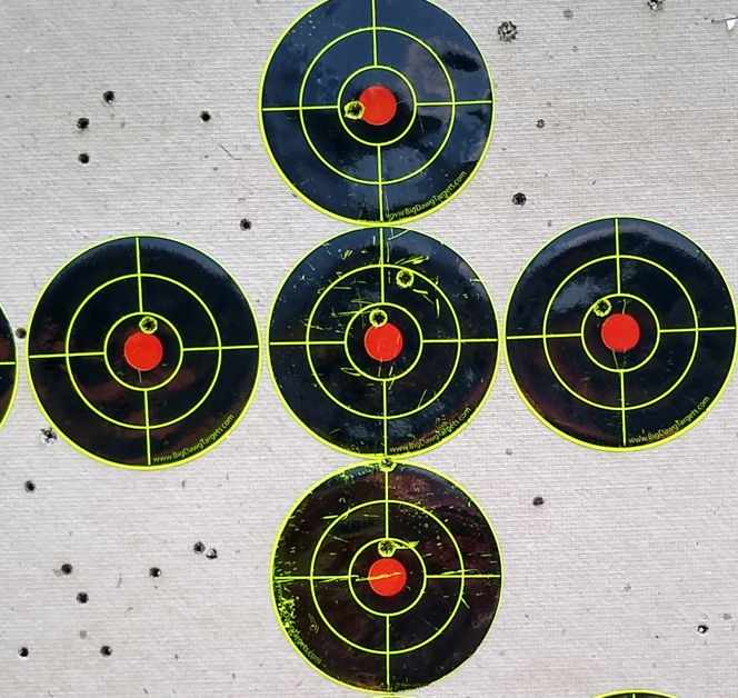

Today is the 2nd trip to the range. 65 shots fired total. I zeroed the rifle at 100 yards and did 10 5 shots group. The first 5 groups are all with Hornady ELD Match. The result is just OK for now. Hopefully it will get better after the barrel is seasoned.
5 groups of 5 shots: Hornady. 2 mins break between each group.
Best: 1 moa.
Worst: 2 moa
Avg: about 1.25 moa
5 groups of 5 different ammos:
Not sure why all the shots are 1.5" high. The rifle was zeroed fine. The rifle was zeroed at 50 yards on the first trip. Today It took one shot to zero at 100 yards (center target). Then the scope was adjusted 10 cm left, right, up and down while aiming at the same spot. So the scope seems to work fine. It is puzzling why all groups are high when the real shooting started.

It's you, not the rifle.
Reactions: oso1
Chinesium. Optic.
Would you please explain why a cantilever mount is not good for a bolt action? Bergara rifle has the adjustable comb.
Your reasons for using one are wrong.
Again, you don't know what you don't know but come to the forum with the most precision bolt action rifle knowledge in the world to argue why you're doing what you're doing.
Reactions: oso1 and JakeM
You just helped make @308pirate 's point. An adjustable comb (cheek riser) is not a reason to raise your scope higher.
Two interrelated reasons why a cantilevered mount is inappropriate for the vast majority of modern bolt-action rifles:
1) The engineering of it all.
Cantilevered mounts were made for when you don't have the ability to have a mono-piece rail and need to mount solely at the rear of the action. The engineering issue with this is that you are putting the entire recoil force against one small area of the pic rail. While not an issue on an AR firing 223 and a smaller scope, with larger calibers (more recoil) the forces acting against a ~2lb optic take their toll on all the mounting hardware. You might get away with this, or you might not, depending on a variety of factors.
2) Scope height
Your scope is very high - and the mount is the reason. Any cantilever structure has to be more beefy due to the nature of their designs. In the case of mounts, that beefiness comes at the cost of scope height. Scope height in itself isn't necessarily bad, but the higher you go and the longer ranges you shoot at, the more opportunity there is for error due to your rifle/scope not being level.
Personally, I try to get the bottom of the scope bell to be about 3/8" off the barrel, give or take, depending on the mount. The only one of my rifles that's higher is my 375, and that's only because at extreme elevations I need to be able to see past the end of the barrel.
Reactions: Aggaron
