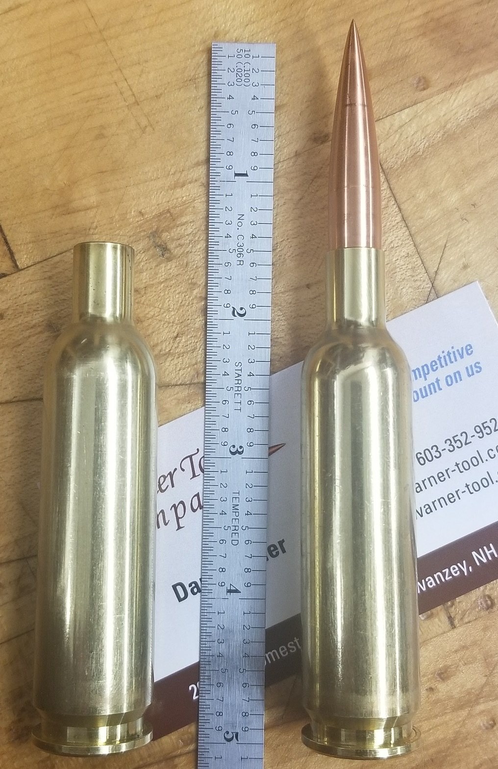

What 375 chambering do you shoot? I'm building a 375 BAS from Rob Vestal.
Matthew488
Warner 375
