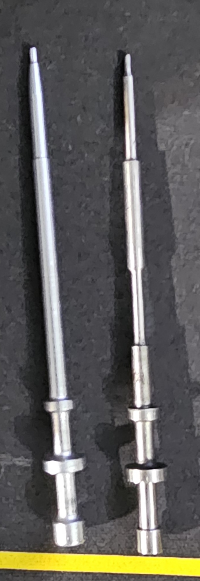

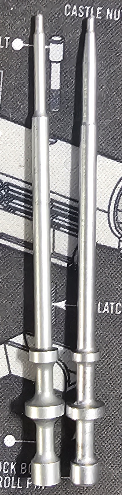

I’m all-in with AR’s. Have a bunch of 5.56’s. I’ve moved on to AR-10’s. I already have two .308’s I’ve done and currently building a 6.5cm. Bolts. What is the opening size for firing pins re: ..308’s vs 6.5cm….Noveske sent me a headspaced hp bolt but no firing pin. Also, can I use dual ejector bolts in .308’s?? The pin size is obviously different in my visualization. I know firing pin size is different between the two. TIA
add:

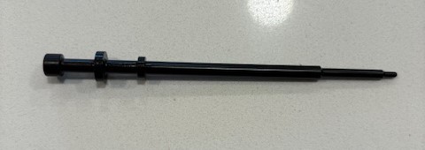

There isn't really a spec for AR-10/308 firing pins, other than a particular manufacturer's own spec.
The original DPMS LR-308 bolts were a 0.080" bolt face firing pin orifice with a 0.076" firing pin tip diameter. Those were not suitable for anything other than a .308 or similar pressure cartridge. Not very common these days in anything other than bottom budget brands or surplus.
The 0.070" bolt face firing pin orifice is probably the most common today. Those typically use 0.067"-0.068" firing pin tips for the better examples, but can vary with budget bolt/FP makers. These can be marketed as "HP" by some, and you can even find some using 0.062" firing pins in 0.070" bolts, which is really bad. The higher quality ones will work with 6.5CM pressures if the barrel has a proper gas system design. I would consider the KAK LR-308 firing pin as being the most common design example.
Actual high quality "HP" bolts and firing pins should be considered proprietary and not interchangeable. Those orifice/tip diameters can vary, depending on the manufacturer.
The bolt is probably a toolcraft bolt and they take the reduced diameter .065” firing pin. And yes you can use the bolt for .308.
There are 2 with reduced diameter pins that use different bolts. JP has their design and others with hp bolts/pins include aero precision, KAK and a few more that escapes me right now. Different hp pins in pics. Only 1 is non.
That bolt is from Rubber City Armory according to Noveske. I bought another bolt w/pin from RCA today.
Seeing so many variants, I think the best thing for OP is to contact Noveseke and have them send one out.
Noveske told me they do not sell individual pins and they sourced that bolt from Rubber City Armory.. I have sent Rubber City Armory a email. No reply yet. I did get another dual ejector bolt today w/pin from them (RCA).
Update: Rubber City Armory called me this afternoon. The tech told me that they do NOT sell AR10 bolts to Noveske, only 5.56 bolts. So, I will get back with Noveske. Jeez.

Thanks. I got one. I also recd the pins (I got from KAK) and the first bolt w/pin I got from RCA yesterday
(after talking with their tech I ordered a second one too).
They look to be identical except the color. RCA’s is dark while the others are silver,
same color as what you see w/5.56 and Aero’s .308 BCG’s.
I spoke with the tech and traded emails at Rubber City Armory. He told me it’s not mandatory to utilize a
dual ejector bolt for 6.5cm. It’s the pin size as I understand it.
Anyone care to share insight to this?
Add: but it looks to me that it’s the dual ejector that requires the 0.065 pin.

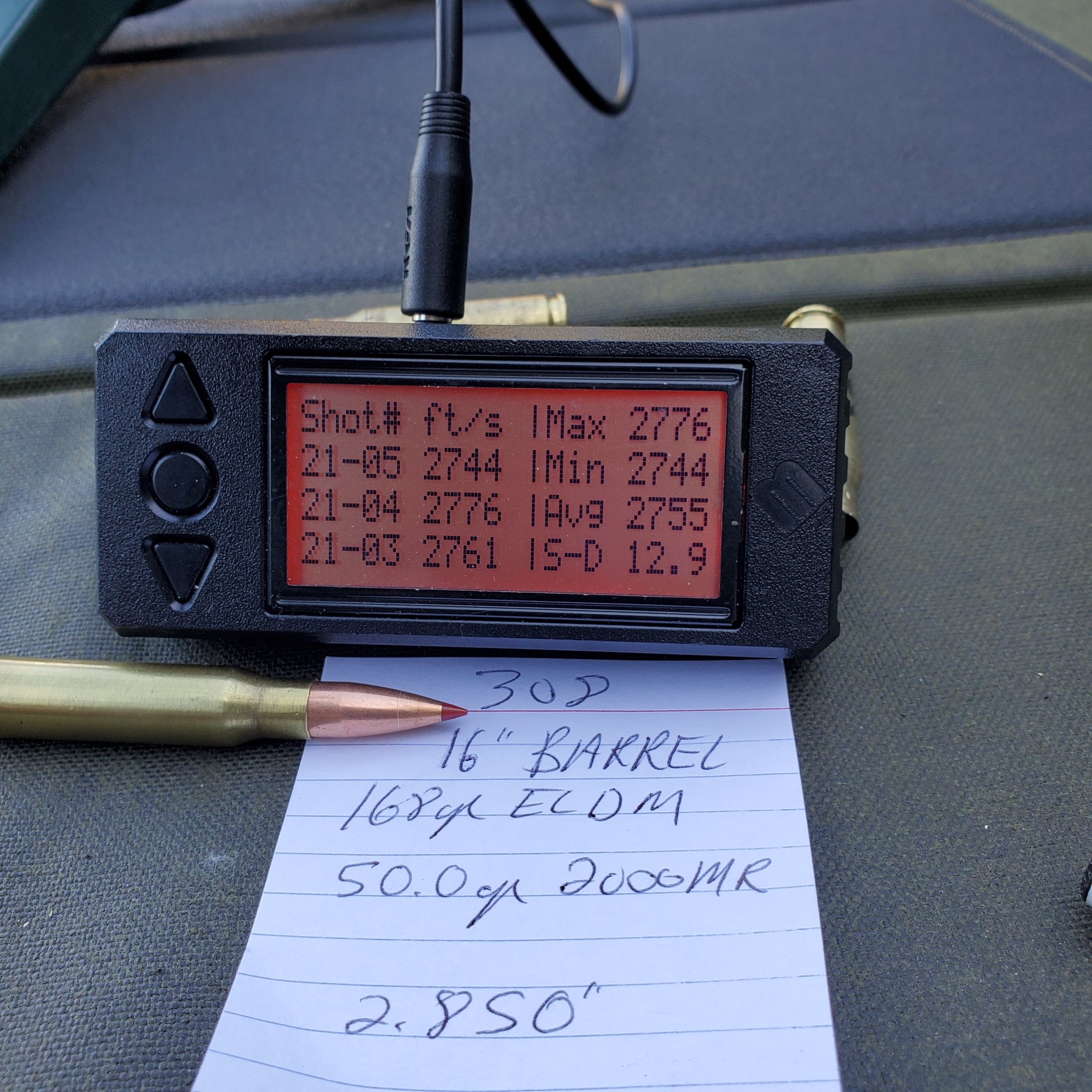

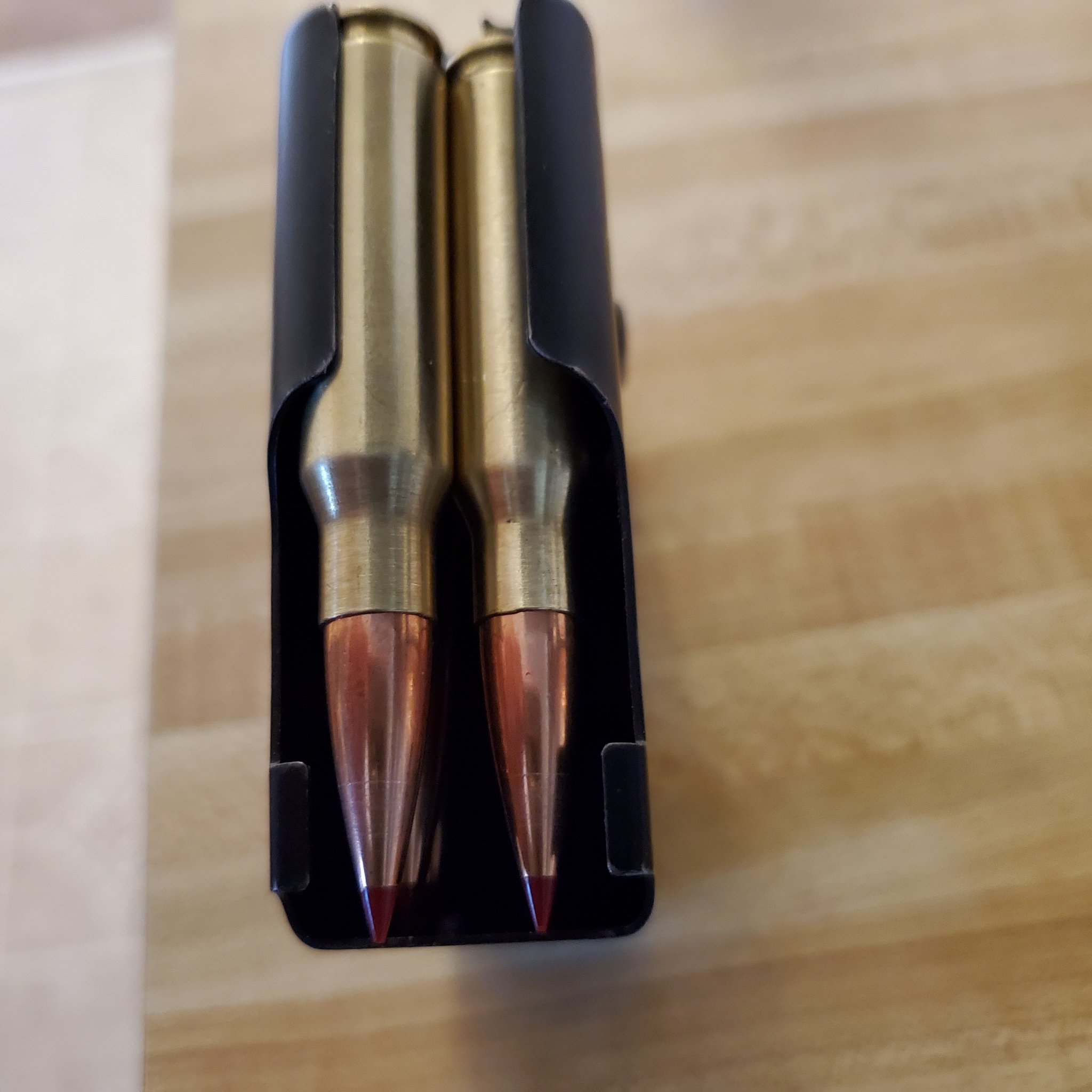

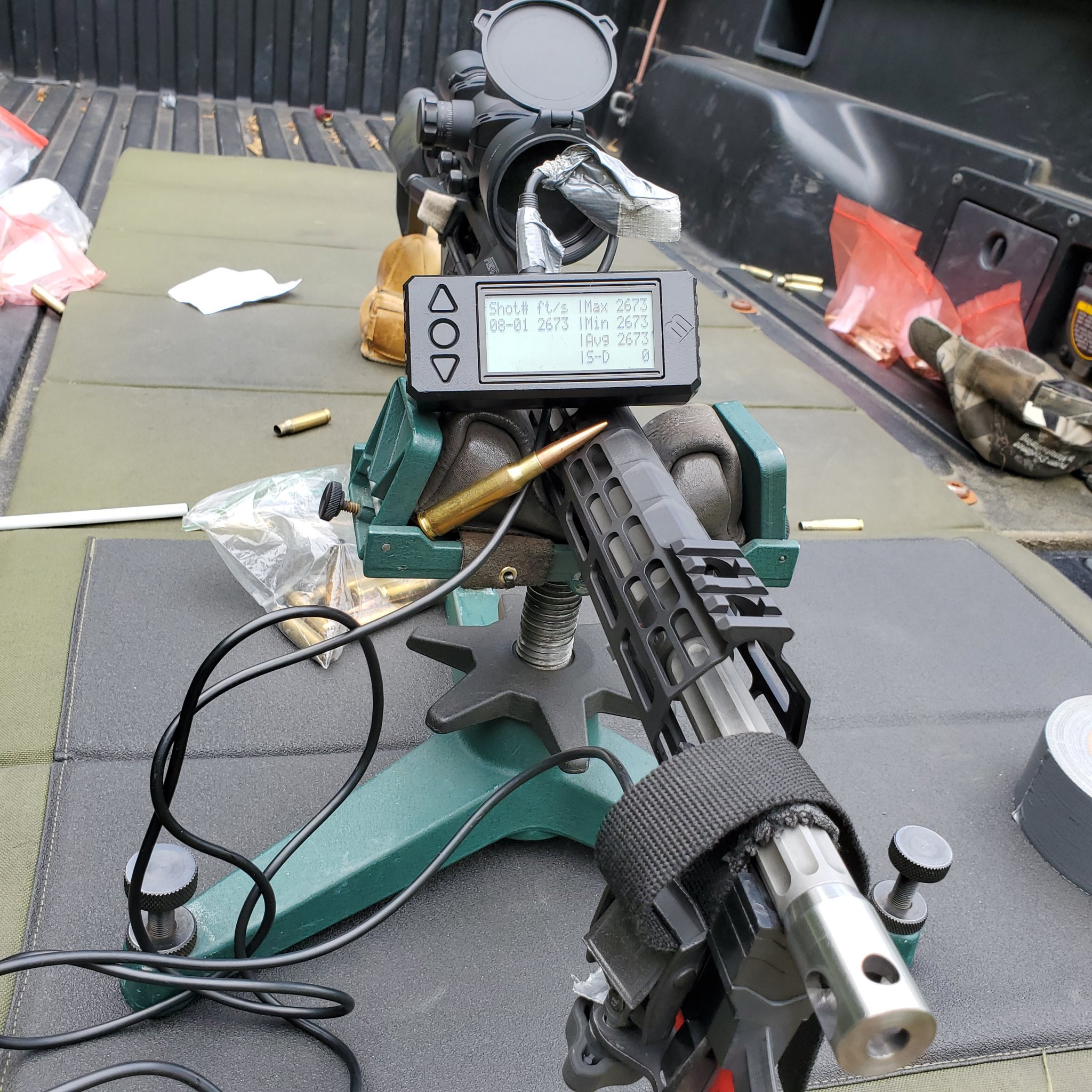

I use the Toolcraft high pressure dual ejector bolt in both 6.5 CM and 308 it has an .062" firing pin, vs the .075," they work great. I like the small firing pin dia. as the preferred option, the dual ejectors come with it. They are not designed to push the limits...but I do anyway, so if they offer any extra assurance that's fine.
Do not do what I do...most of my loads are in the +p category, but they work in my rifles...not necessarily yours, and you mudt be an experienced handloader.
I Run these as at 68,000 psi according to QL in AR 10 ...16" 308...shooting 208 eldm at 2442 fps Ave. 155 gr 2850 fps, 168 eldm 2755 fps. from the 6 lb 3 oz AR 10 with some .5" and less 5 shot groups...the AR 10 is 7 lbs 12 oz complete with a Leupold Mark 4 3-10X. 1200 yd capable with a light AR 10. And you can use cheap LC brass to achieve this. It has a magnesium upper, titanium bolt carrier, ti muzzle brake, 15.5" carbon fiber hand guard, and No it's not inaccurate pencil barrel, but a fluted SS WC barrel 11.25 twist.
A delight to carry and handle lighter than most of my AR 15s...and accurate, just dial & smile set up.

QL doesn't account for freebore/lead. GTR might be able to run that way, but I don't use it.

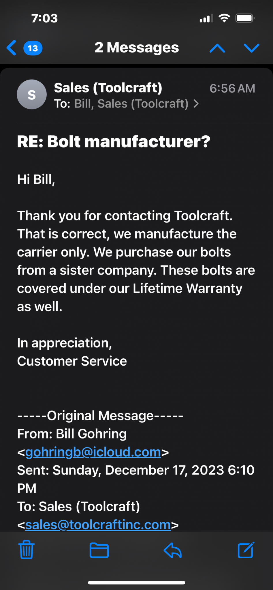

I emailed Toolcraft, I’m intrigued now. I’ll post the response when I get it.
I thought that it was generally accepted that Toolcraft only makes carriers. Form their website: "Toolcraft manufactures the finest quality AR10, AR15 & M16 bolt carriers at the most competitive price.", nowhere do they state that they make bolts. I don't see a problem with that, it's not like they're going around buying bargain bin bolts wherever they can find them at the lowest price. I would imagine that the bolts are made by a reputable sub-contractor specifically for and to Toolcraft's specs and QC, and warrantied the same as if they were made in-house.

Yep, QL is only a gustimate...it say so right on the computer screen...and I alter most guns chambers, dies, recievers, muzzle brakes, magazines, etc...so there's not much standard...so don't do what I do.

This their response. Apparently they have a sister company. I assumed they did manufacture them because of how they word their bolt kit add on arm or ally. Definitely misleading a little bit, but it won’t stop me from using them.
I think PSA acquired Toolcraft as I understand it. Forgotbtheir holding company name though

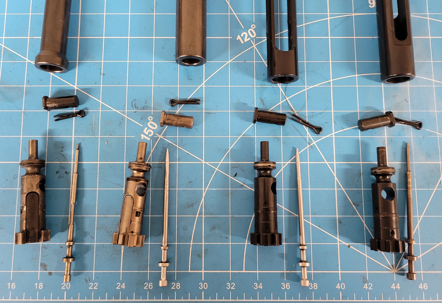

FWIW... so far the BCG's and bolts with the Tapered SD Tip FP's I have are..
Lantac "308" Enhanced complete BCG...
https://www.lantac-usa.com/product-page/enhanced-bcg-full-auto-style-308-7-62-nitrided
CMC / SanTan ( identical, w/ 3 exhaust ports ) "308" complete BCG...
https://cmctriggers.com/product/cmc...ppressor-optimized-milspec-black-nitride-308/
PSA / Toolcraft ( both a 308 and various single and dual ejectors 6.5CM versions over the years... ( Current production 308 PSA BCG's are not HP )
https://palmettostatearmory.com/psa-nitride-6-5-creedmoore-bcg-with-double-ejector.html
And a just bought w/ barrel, matched head-spaced bolt from Craddock for a 308 RTR barrel. It has a Tapered SD FP tipped as well.
Some where I bought 2 spare SD tipped FP's as well... long ago, and I have no idea from where. Maybe Arm or Ally.
The first time I saw a tapered SD FP .068" was back in May of 2018.... in both a complete PA10 ( 308 ) and PA65 ( 6.5CM ) bought from PSA.
As mentioned earlier, the Lantac "308" bolts sold as individual parts, ( both nitrated and NiB ) are a .081 FP hole... and the replacement FP's sold individually are .076.
So typical non-HP parts.
FWIW... The 2 Tapered spare SD Tip FP's will slide into the non-HP bolts firing pin channels just fine... but the gap at the small tip to larger bolt hole will be excessive.

Example Toolcraft bolt in AR 10 308 18" shooting 200 SMK at 2670 fps. Ain't no light load, but handles the pressure just fine.

Yep, single feed, like many of those shooting those long bullets...
I "can" feed 2.960" out of my modified AR 10, incase you really wanted to know, and run the 200s there.
But if you insist on standard mag feed, I change to the 6 lb 16" AR 10 and bullets like 208 ELDM my 16" AR10 runs those at 2442 fps, and fit the mag or 168 ELDM at 2756 fps in the 16" AR 10 also mag feed, and very accurate...But all with the same Toolcraft bolt.
Picutred 208 ELDM and 155 gr Starting loads with the 155 gr went over 2800 fps, top load 2929 fps wasn't accurate in the 16" AR 10, again same Toolcraft bolt, couldn't do better with any high dollar bolt made from the same material, and heat treatment, that was probably made by the same company, only the lazered logo is the difference, with many.

Another oddball tip size....
JP Enterprises 308 ( Non HP ) Firing pins tip sizes, for all 3 products linked... .0735
https://jprifles.com/buy.php?item=JPBC-PINS-308
https://jprifles.com/buy.php?item=JPFP-308TI
So those will fit.. ( I assume, since JP does pay attention to their parts ) the NON HP Enhanced JP bolts... IE...
https://jprifles.com/buy.php?item=JPEB-308
https://jprifles.com/buy.php?item=JPEB-308 S
I'll check the jp's I have and compare against other pins and bolts.
Reactions: bfoosh006
L to R
1: JP HP
2: ToolCraft HP Dual Ejector
3: No Name LMAS non HP marketed
4: Faxxon non HP.
Notes: 2 & 3 are probably both Tool Craft. The firing pins and bolt apertures in the bolts are identical. Both firing pin tips are .0675" and correspond to .069" bolt apertures.
After searching around on the internet...#2 and #3 might be Azimuth made bolts and Tapered SD FP's .
Azimuth also makes / supplies 308 BCG's for quite few "big" names... Wilson Combat, some of the Aero Precision, KAK , Odin Rifle works, Battle Arms Development.
Azimuth has produced a Dual Ejector bolt as well... with the ejectors closer together.

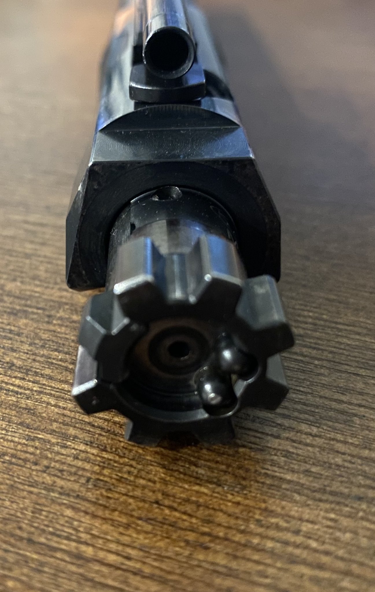

Teufel820's photo..
The "tell" on a Azimuth 308 sized bolt carriers are the slightly rounded / radius-ed corners on the back of the gas key. And a "slab" cut surface on the bodies left side.
And the undercut at the back of the main body, and the shank.
FWIW... this pic shows a Tapered "SD" FP as well...
Teufel820's photo..
View attachment 8441953The "tell" on a Azimuth 308 sized bolt carriers are the slightly rounded / radius-ed corners on the back of the gas key. And a "slab" cut surface on the bodies left side.
View attachment 8441948View attachment 8441948
#2 was purchased as a bolt kit without carrier. The ejectors are not close together like your picture. It is this bolt: https://www.armorally.com/shop/toolcraft-6-5-creedmoor-nickel-boron-double-ejector-bcg/
I don't know who ToolCraft uses for subs and you could be right.
