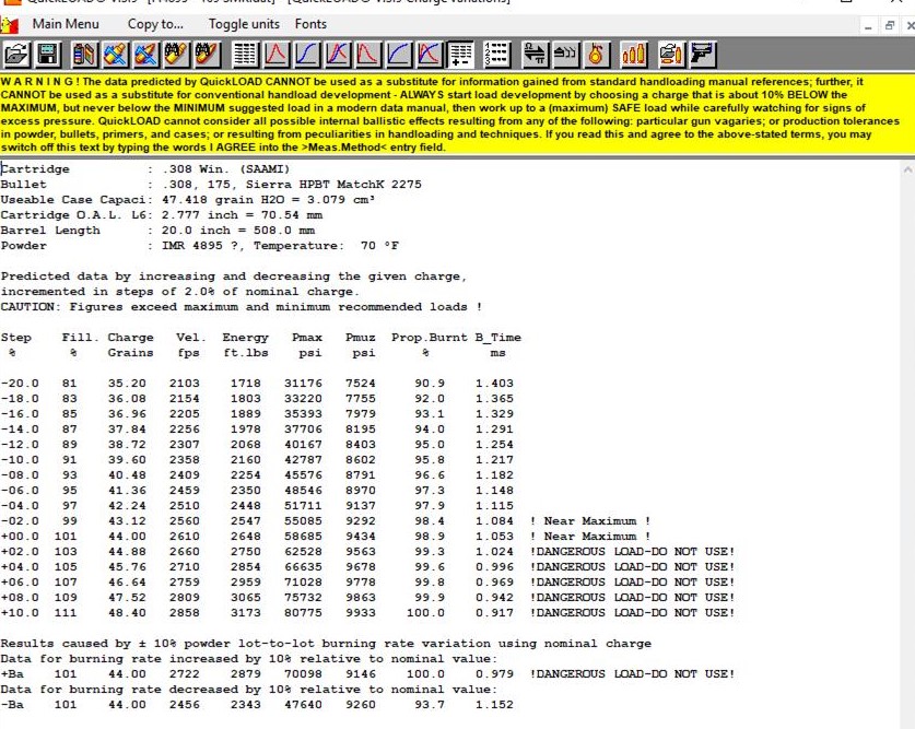

I concur that the heavy bolt lift is a sure sign of being over pressure. Why that is can be a couple of things, like . . . carbon ring build up, high temperatures, a powder lot that with higher burn rate, any combination of these.
Without known velocities, it's really very difficult to judge where you actually might be on the pressure curve. Below is a QuickLoad chart that might give you some idea, BUT. . . without actual velocity data, I can only use the default number for burn rate which is surely well below what your powder is doing.
