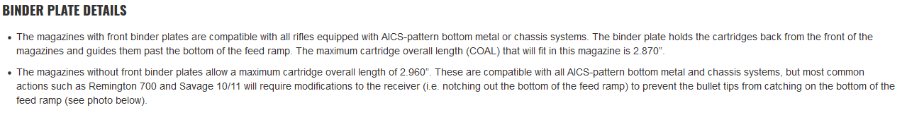

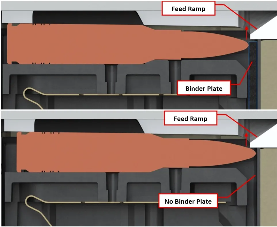

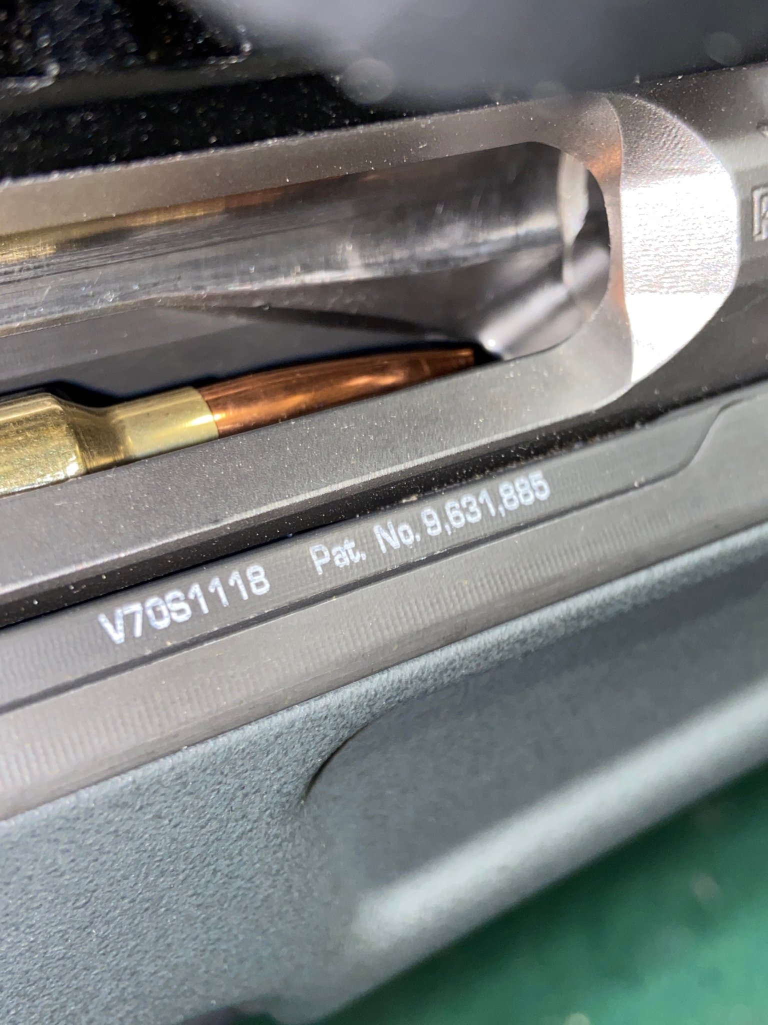

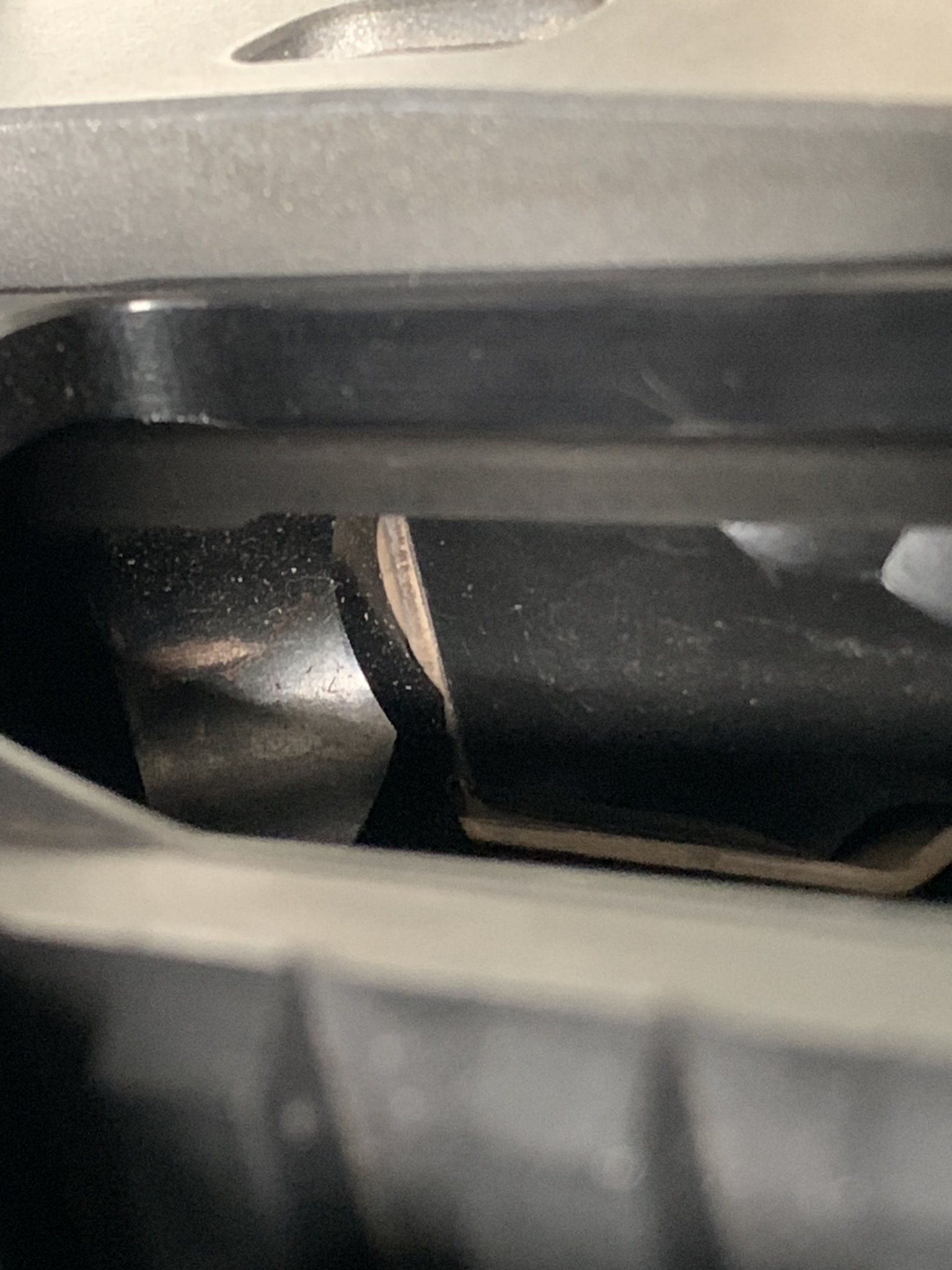

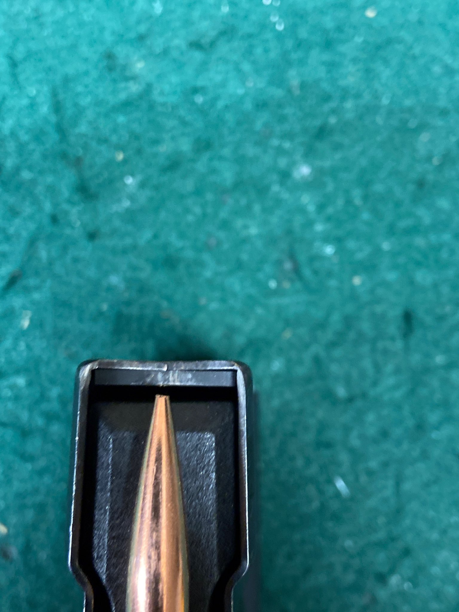

    You can look into your ejection port and see where the action starts to cover up the mag/binder plate.
    Here you can see that the binder plate (tan) keeps the tips well back from the feed ramp but that the front of the mag may be hidden under the lip ever so slightly. See if you can see the front inside of your mag is close to clearing or if it’s way covered up.

    Good image of that on MDT's site that illustrates this.

    @spife7980 @KZP - hey guys, just following up.
    So, this is loaded at 2.859....just about .010 less than max mag length for binder plate mag and there seems to be plenty of clearance in the mag.
    And, even at max mag length, I have tons of room before slipping under feed ramp. I could even use non-binder plate MDT mags and longer COAL with no worries but I own binder plate mags already and until and unless I see a need to get a lot closer to the lands than most folks loading Berger Hybrids, I'm thinking I'm just going to stick to what I have in hand right now.
    So, my plan is to load up my charge weight test rounds at 2.860, .010 less than mag length, .060 off of lands and see how that goes for a start.
    Am I missing a pitfall here or......???
