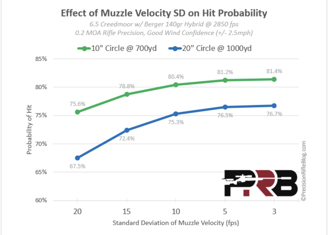

You’re saying you can shoot the difference of 1% improvement in hit probability? Not likely.
That's a good chart with some useful info. And it goes hand in hand with what Feniks has said here though, and doesn't contradict any of it. If you think it does, you aren't listening/reading. I think you and most everyone else here also know dam well that he didn't say what you're claiming he said; that's a strawman argument and just your attempt to pick a fight.
Feniks is right about the reason a lot of knowledgeable shooters quit posting here, because of foolishness like this. You're just looking for an argument without even knowing what you're arguing about.
For anyone else reading along and not sure……
If the target is big enough, of course it doesn’t matter.
But that’s with anything. You can say SD doesn’t matter at 2500yds if you use a 25ft tall target.
Also, where he lacks understanding in his copy/paste scenario is that it assumes an actual known and completely valid SD.
We can almost never have a known sd without hundreds of rounds fired. And even then it’s not perfect.
Let’s take the normal 5 shot string and compare a 5 and 10sd.
5sd = 3-14sd
10sd = 6-29sd
So, now we aren’t just talking the difference between 5 and 10sd. We are talking the possible difference in 3 and 29sd and anywhere in between.
Or for each one we are talking 3-14 and 6-29.
Even on the better, as you can see by the copy/paste job, it’s no longer 1%. It’s now in the 4% range.
So, if you want to keep that 1% at 1% and you’re shouting 5 shot strings, you’ll need a maximum of 3.2sd to be 95% confident your margin of error is 1% or so.
And, if you shoot a 5 shot string and get a 10sd and think (like it seems out special guest above thinks) that it’s a 1% difference only…..and therefore no need to try to get better…..
You’ll be scratching your head the time when it’s a 20+ sd and now your 1% just turned into 6-10%. Oh and that’s also assuming zero wobble, a perfectly center zero or offset input, no mirage, no light refraction, no ammo temp increase, aerodynamic jump properly accounted for…..etc. otherwise you just added some tenths of mils to you error.
Special thanks to @LV Precision for helping with the visual.
