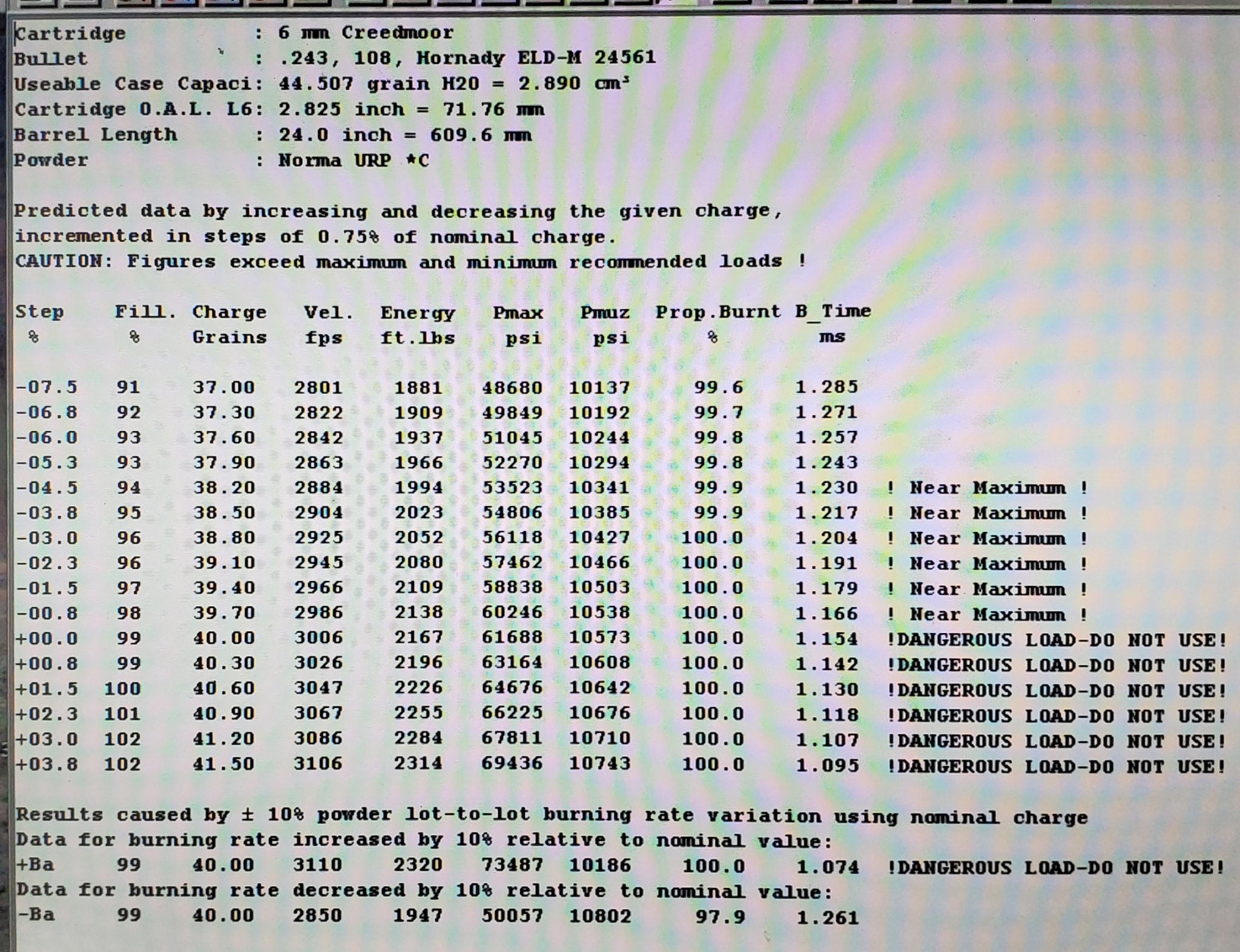

Hello could someone with quick load please run this for me? I would greatly apricate it.
6mm creedmoor
Nosler brass 48.1 grains H20 capacity
108 Hornady ELD M bullet
Fed 210m primer
the powders I would like to see numbers on are norma 204 and Norma URP
the COAL is 2.825
Thanks for any help on this . I want to see some rough load numbers and velocity and pressure before I purchase 204 I have some URP on hand to try.
You did not specify barrel length so I'll set it at 24"

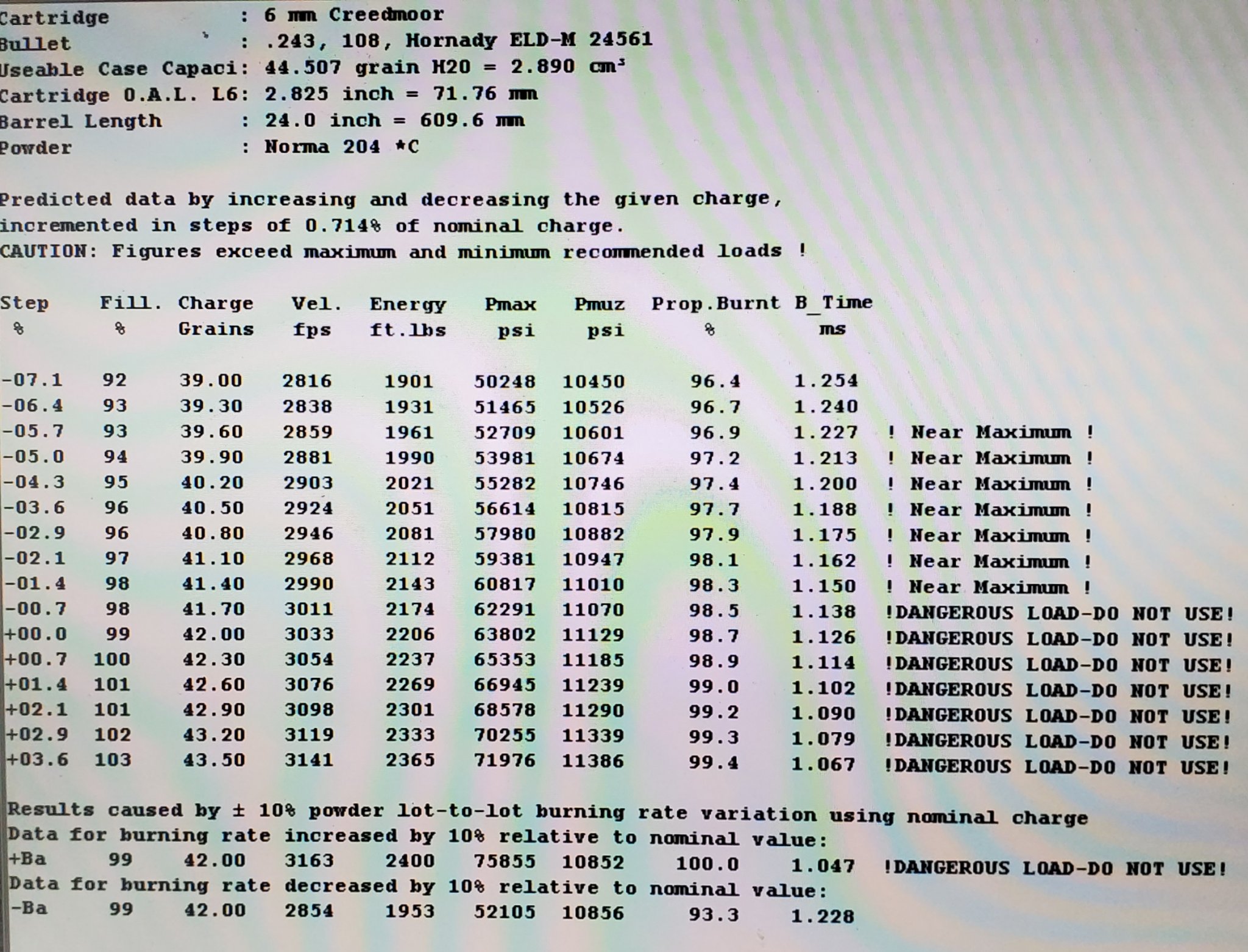

Norma 204
