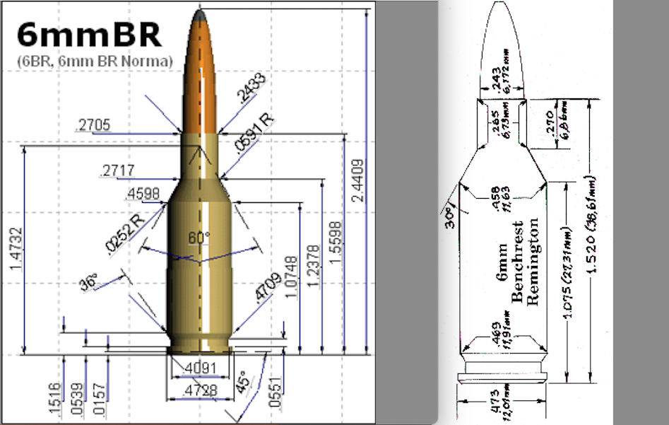

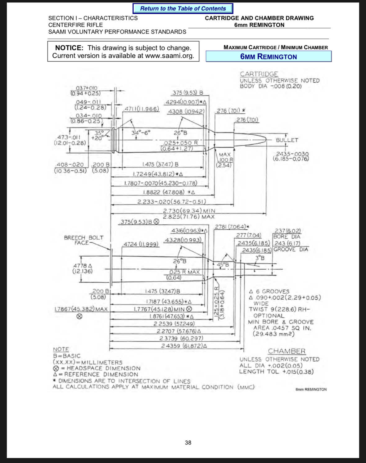

The dies are the same the Norma chamber is long throated for 105 grainers. The Remington, for short benchrest bullets 68 to 90 grs.
Brass brand capacities are somewhat different.

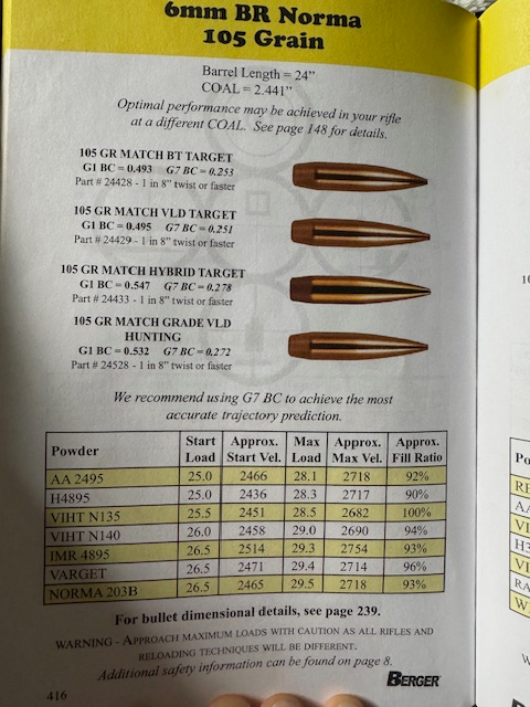

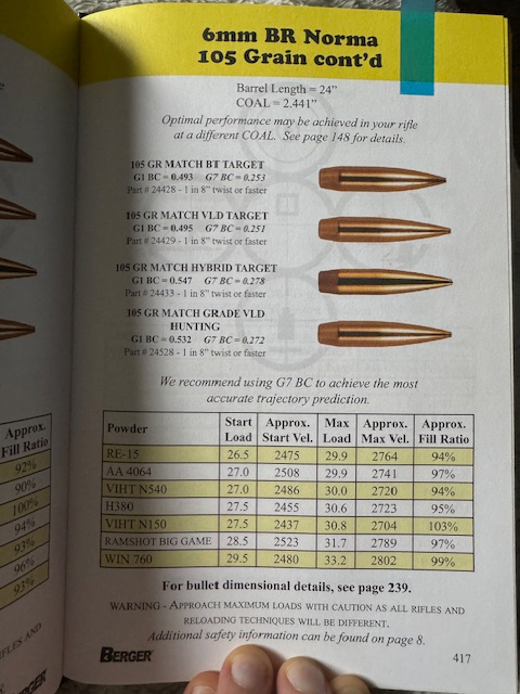

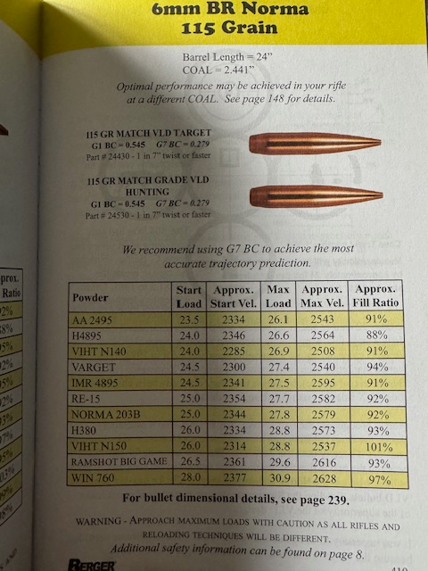

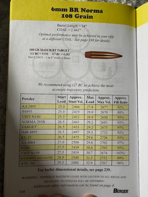

I'm only wondering how come the velocities are so low? My target loads run 108s at 2970 to 3020 fps.
My high velocity loads run 110 SMK at 3085 fps. 115 DTAC at 3020 fps. Or 58 gr Vmax at 4100 fps. Alpha brass is holding up well, not too concerned about brass life, or barrel life, it's part of shooting.
Because this forum is mainly for practical/tactical and PRS type shooting. The trend is to run slower. You're trying to insert your personal goals/beliefs on a forum population that doesn't share your goals.
Not to mention, Dashers running that hot are often over 65k psi. Not every barrel, but many of them.

So why run slower on purpose, if accuracy is acceptable at a higher node, would you not use it, to gain an edge in LR shooting, with respect to drift and trajectory? Trying to save on barrels?
I was truly amazed at the low velocities, so I don't get it.
Yep, it's not my deal to run slow and many loads will be in the 65,000 psi range.
I do not care that everyone likes to run slow here, but me, ...but why? What is the advantage in your game?

Seeing trace for adjustments and follow up shots under time works better if speeds are somewhat slower. Compare the marginal advantage of 100fps more vs. seeing exactly how your bullet is traveling. The latter is a better advantage.
Different goals equal different approaches.

You are missing the point. I actually ENJOY reloading (maybe even more than shooting). You can take the easy route. I want to enjoy the drive to get there. I want to have actual data to do my own ladder test. Not just take a recipe that works.
Do you buy legos already put together for you as well?

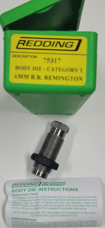

Exactly. I have yet to find a die set labeled 6mm BR Norma. Yet people keep on saying the cases are diff when we all know it's just the throat.
Throats vary, I own my own Reamers.
I spec'd mine out for my needs. Twist rates vary according to your needs. The Die doesn't care if it's a 6BR Norma or 6BR Remington. Send 3 fired, unsized cases to Harrells and they'll get you a Die to match your chamber. Any 6 BR seater will work. I use an Arbor style and a Forster. Tons of verified load data from a lot of VERY accomplished shooters.
