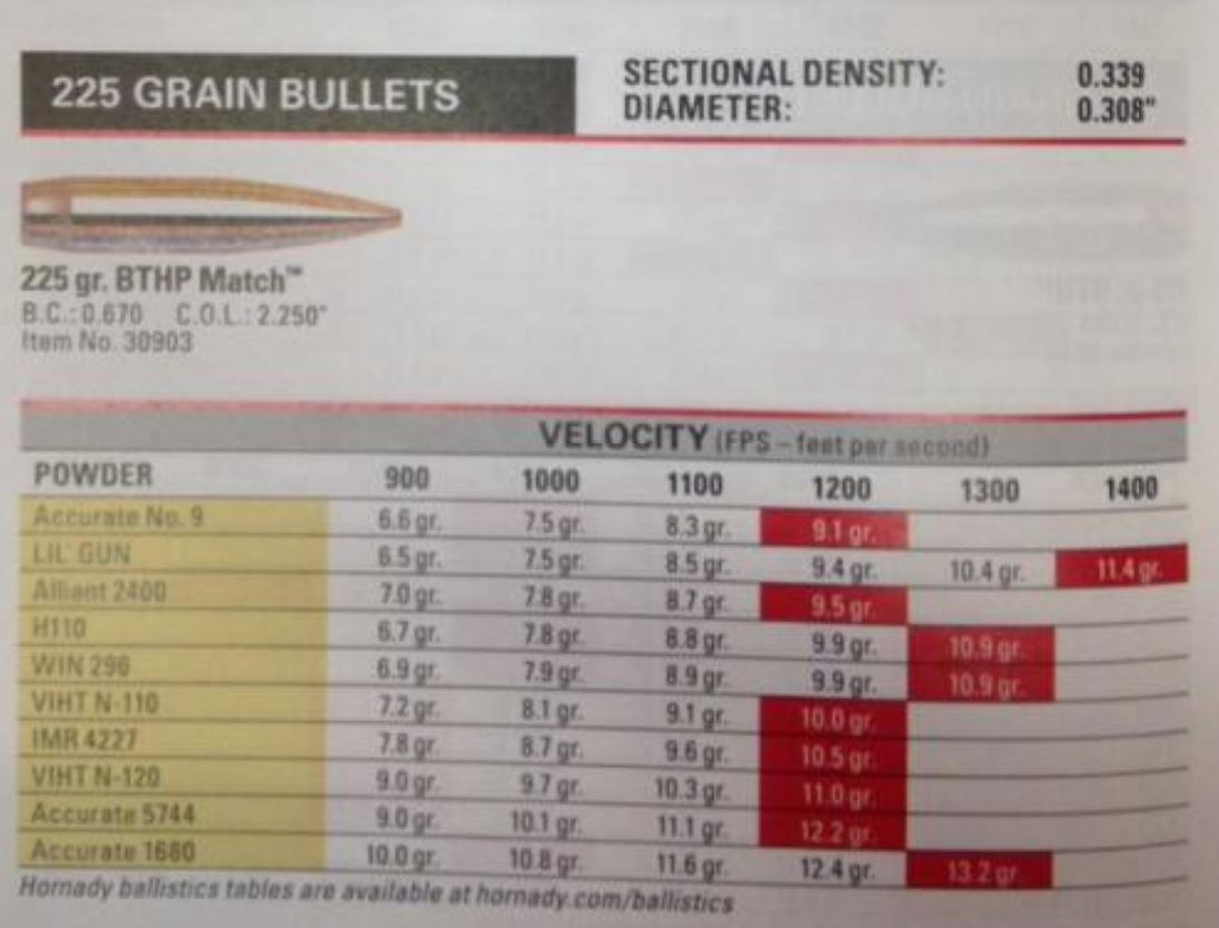

For a gas gun a 225grain Hornady bullet and some Accurate#9.
In my 9" SBR that's silly quiet.
Barrel length matters when it comes to picking the best powder for this job.
How many grains of accurate #9? Velocity?
I checked (after midnight when I got home) and I couldn't find my old notes yet. I am not sure where I placed them. I am definitely in the right ballpark with what I said above though.
FWIW This powder/bullet combo was listed in an old Hornady reloading manual (the 9th edition to be exact). The current edition is the 11th.
They have 7.5 grains listed as giving 1000fps but that is out of a much longer barrel than mine. I can't recall exactly but I know it was between 8 and 9 grains out of my 9" barrel. I think 8.3 grains...but I cannot confirm until I find my notes.
