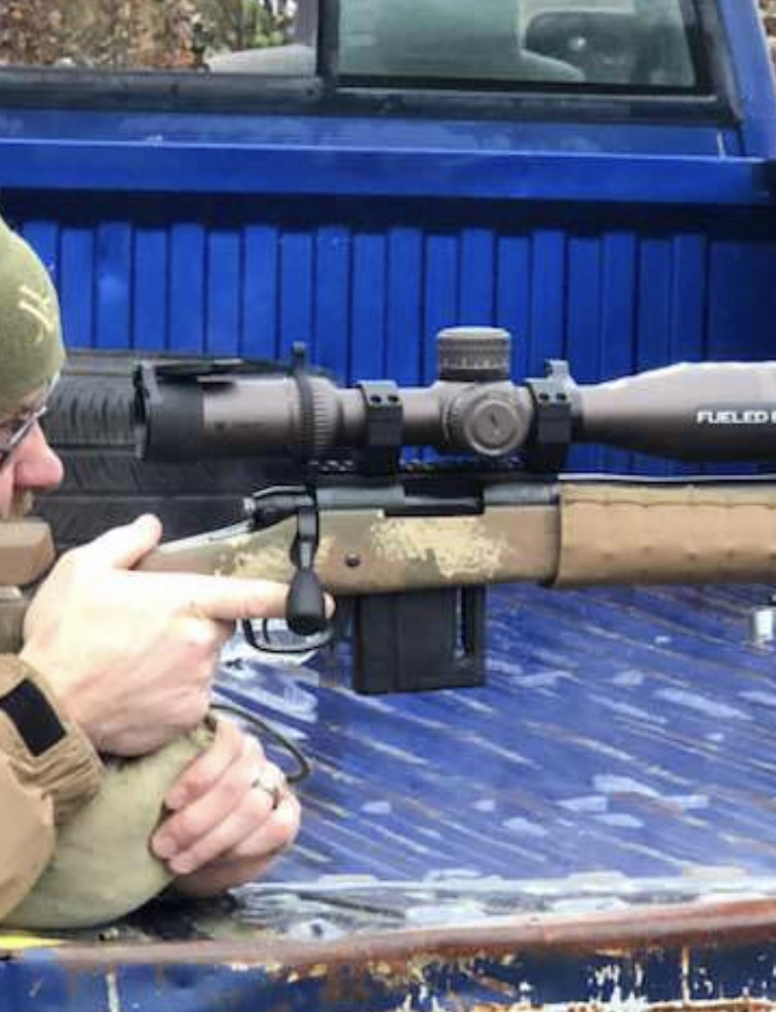

    Kinda like this. You can see the bolt handle inlet has more sweep than is needed, too.
