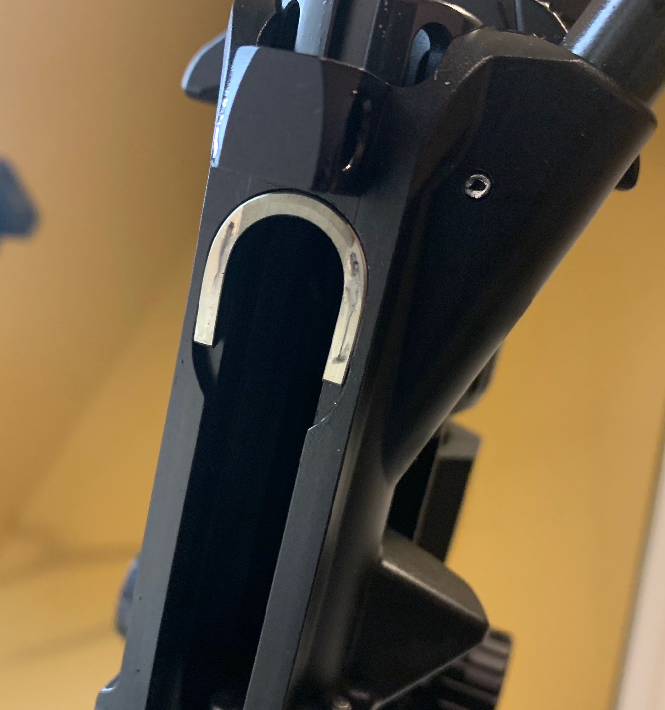

    I fit Accu shims to all my builds. I'm not a big fan of the plunger adjusters. The Accushim takes out all rock.
    No glue or anything. It's just slightly wider then the recess in the upper so it just presses in and stays no problem.
    They do require hand fitting though.
    They come in a nice little kit for like $8.
    I bought 6 last time. AR's breed like rabbits.
