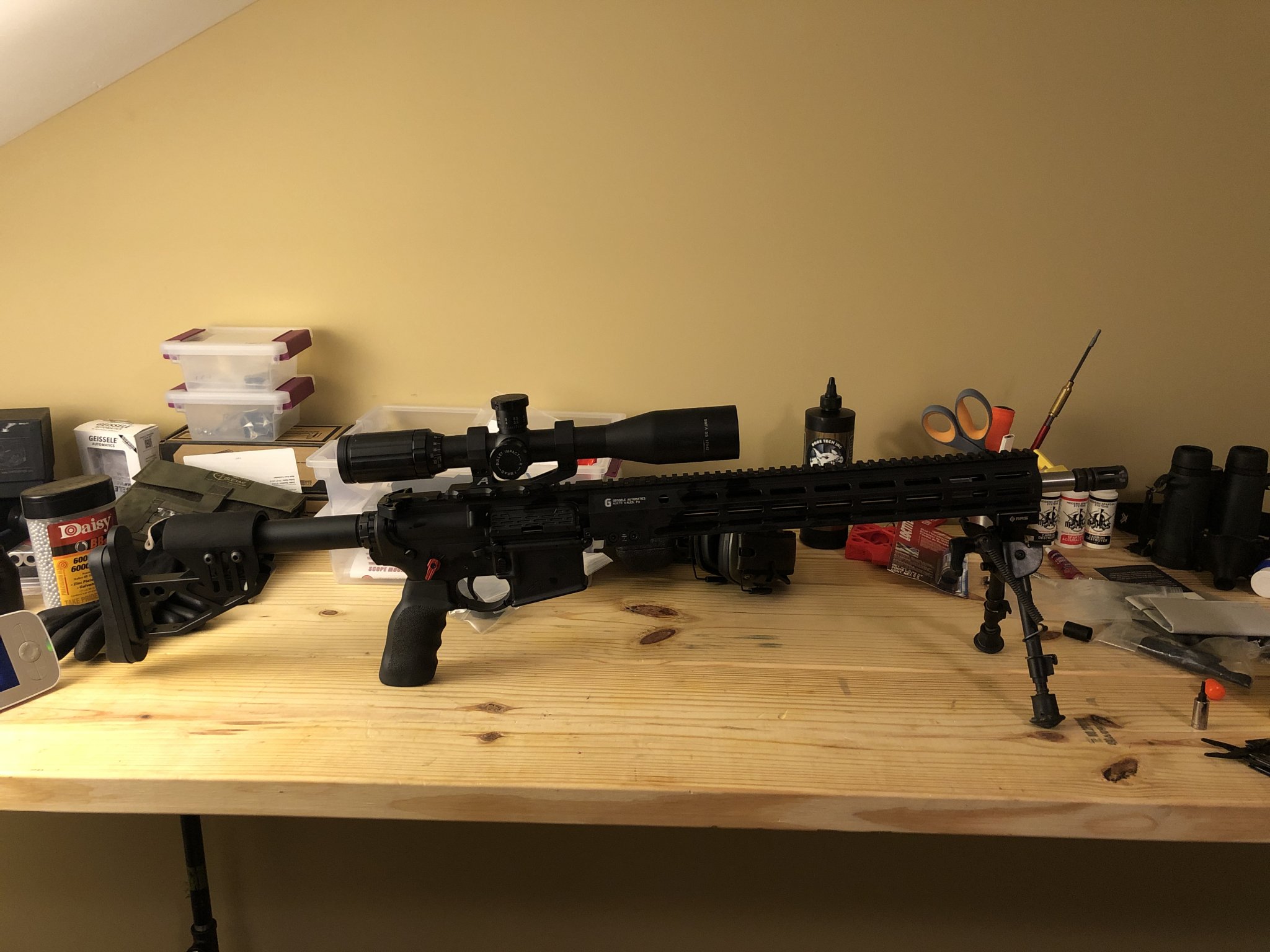

Heres a pic of a 224V I build with Craddock 22” +2 gas with Superlative .875” GB and Seekins SP3R rail. The back 1/4ish of the GB was inside the handguard and the majority hung out. I liked theway it turned out because there wasn’t exposed gas tube.
That looks great, in a 70’s hot rod kinda way. I used to not be much of a fan of the partially exposed gas block but definitely coming around on it.
