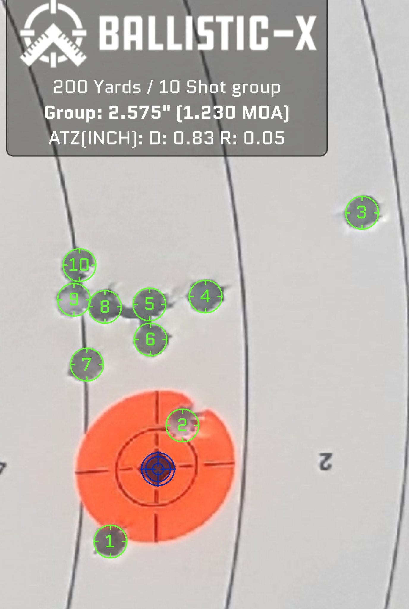

I see no heat drift over the course of 60 rounds shoot in roughly an hour. Shooting 200 yards with factory ammo since I do not reload yet. The below is 62gr Frontier, shot towards the end of the session. Leaving two fliers aside this would be fantastic.
Edit: I have an older 18", solid, not fluted.
