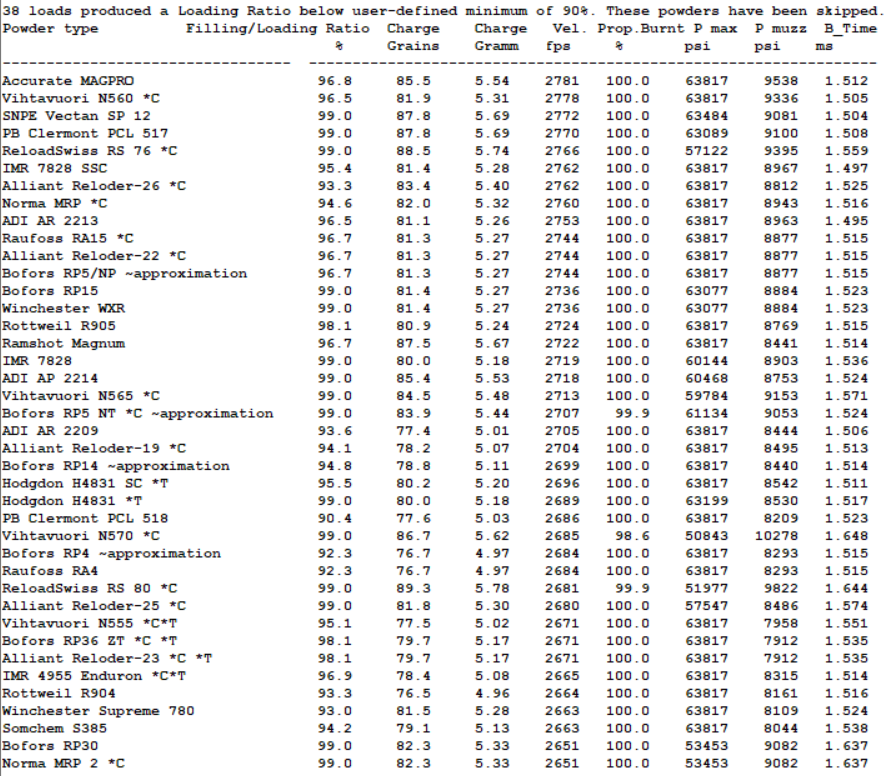

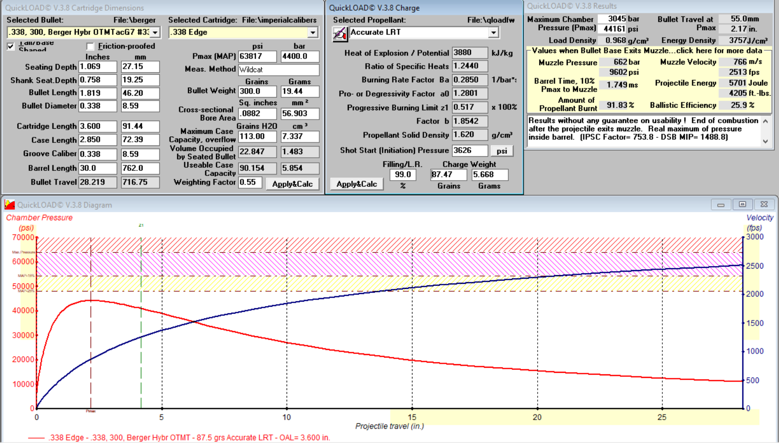

Quickload says you'll be hard-pressed to get anywhere close to that, but ground truth always beats simulation.
I don't see Hodgdon's Superperformance in QL, but seeing that it's similar to H4831, it's likely way too fast. You'll probably get similar speeds to LRT, but with less volume and much higher pressures.
