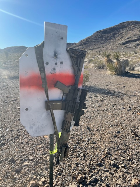

    I predominantly use 55g hornadys w/H335 in various cases for night shooting w/the nods/laser at close range stuff. Otherwise my primary load uses the 77smk, 25g AA2520, LC case, R7-1/2 and runs equally well in my Mk12 and all carbines.
    Heres a typical group at 500m with that load and my “urgi”
