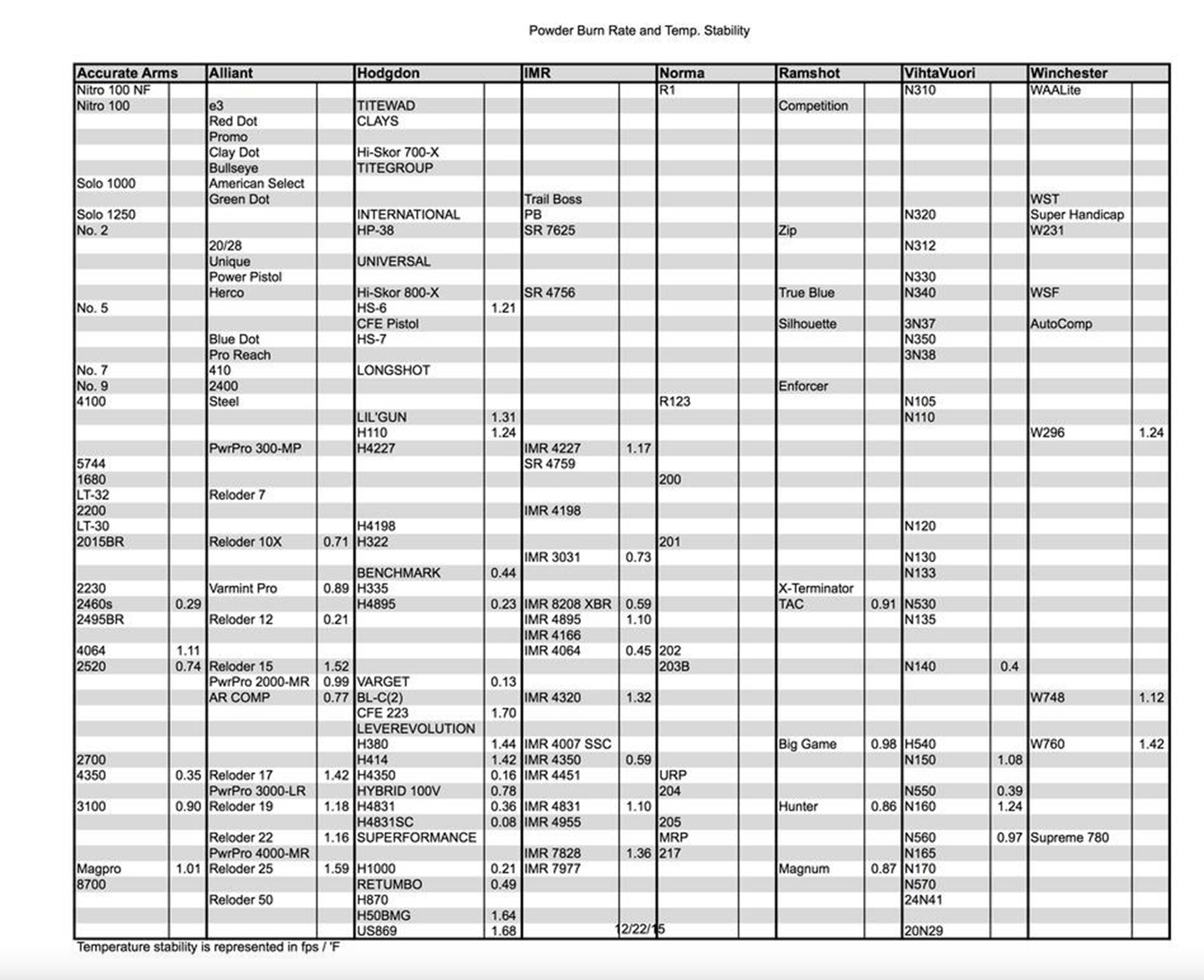

There's a chart out there that has Ramshot Tac at 0.91 fps per degree from 50*F on up.
GRT numbers come out to be about 0.895 to 0.93fps per degree change from 70*F to 140*F
0.504 to 0.54 fps per degree change from -4*F to 70*F
Up to you to decide if you want to track powder temp.

FWIW: This table went around a while back. The footnote says the units are in fps per degree F.
So for example, it shows TAC at 0.91 fps/degF, which roughly agrees with the above posts.
Lets assume the OP was doing his work in 90 degree summer, and got 3000 fps.
If he shoots in 60 degree weather, then the math looks like 3000 - ((90-60)*0.91) = 3000 - 27.3 = 2972.7 fps
If the OP is shooting at say 300 yards, it would most likely be negligible. If he is shooting at 600 or beyond, then it barely starts to show.
The WOA SPR bbl is a pretty good one and not real sensitive to small changes like this one from a harmonics view. It would amount to roughly 0.3 MOA vertical difference at 600 yards.
