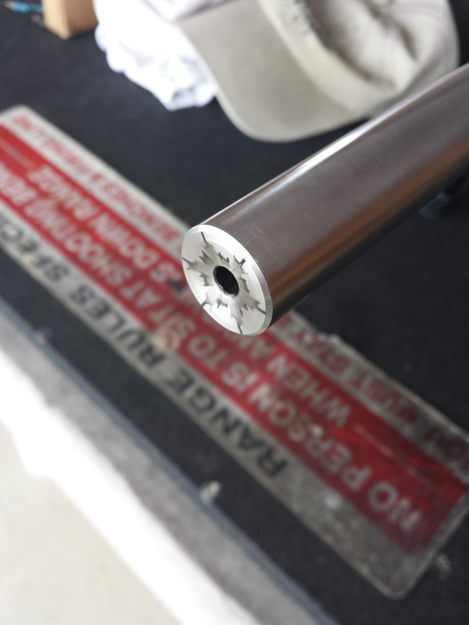

I use Tac in various bullet weights from 55 to 80grs and from below zero up to around 90 degrees. Only thing I notice it seems to burn less efficiently in the cold. Western 556 Nato load data is where I get best results with Tac.
The pattern in the pic shows up in cold weather only.
Nice snowflake pattern!
