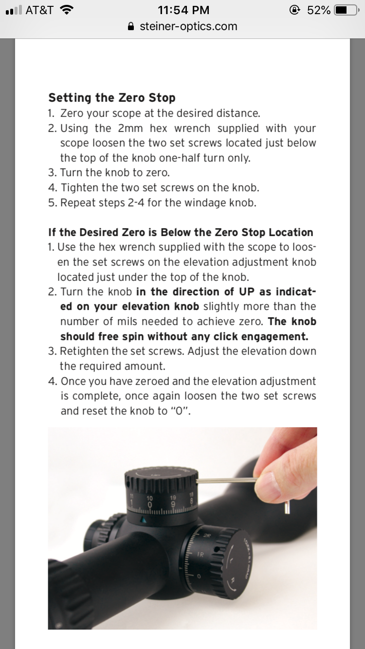

    I don’t know anything about that scope, but are you hitting a zero stop that can be adjusted further down? Seems odd you’d be out of travel with only 20MOA. How much total travel does your scope have, and can you account for all of it?
    Assuming it’s the p4xi 4-16 Steiner it’s got 30 mils so it should be a long ways from the end.
    I suspect the zero stop is locked and blocking your adjustment prematurely as well.

    Same scope here. Mounted in Hawkins Hybrid 25moa mount and after zeroing, I only have about 9.5 mils of elevation which seems low to me. I did mess with the zero stop but maybing I'm missing something too. I am curious to see what you find out.
    Stupid question, but did you make sure the mount is installed the right way?
    9.5 is about what you’d have if the mount was wackwards.
