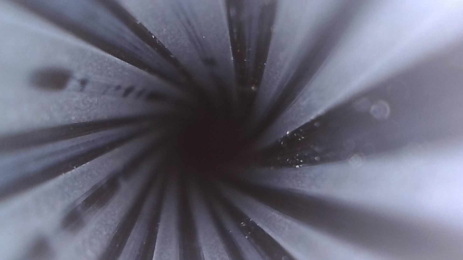

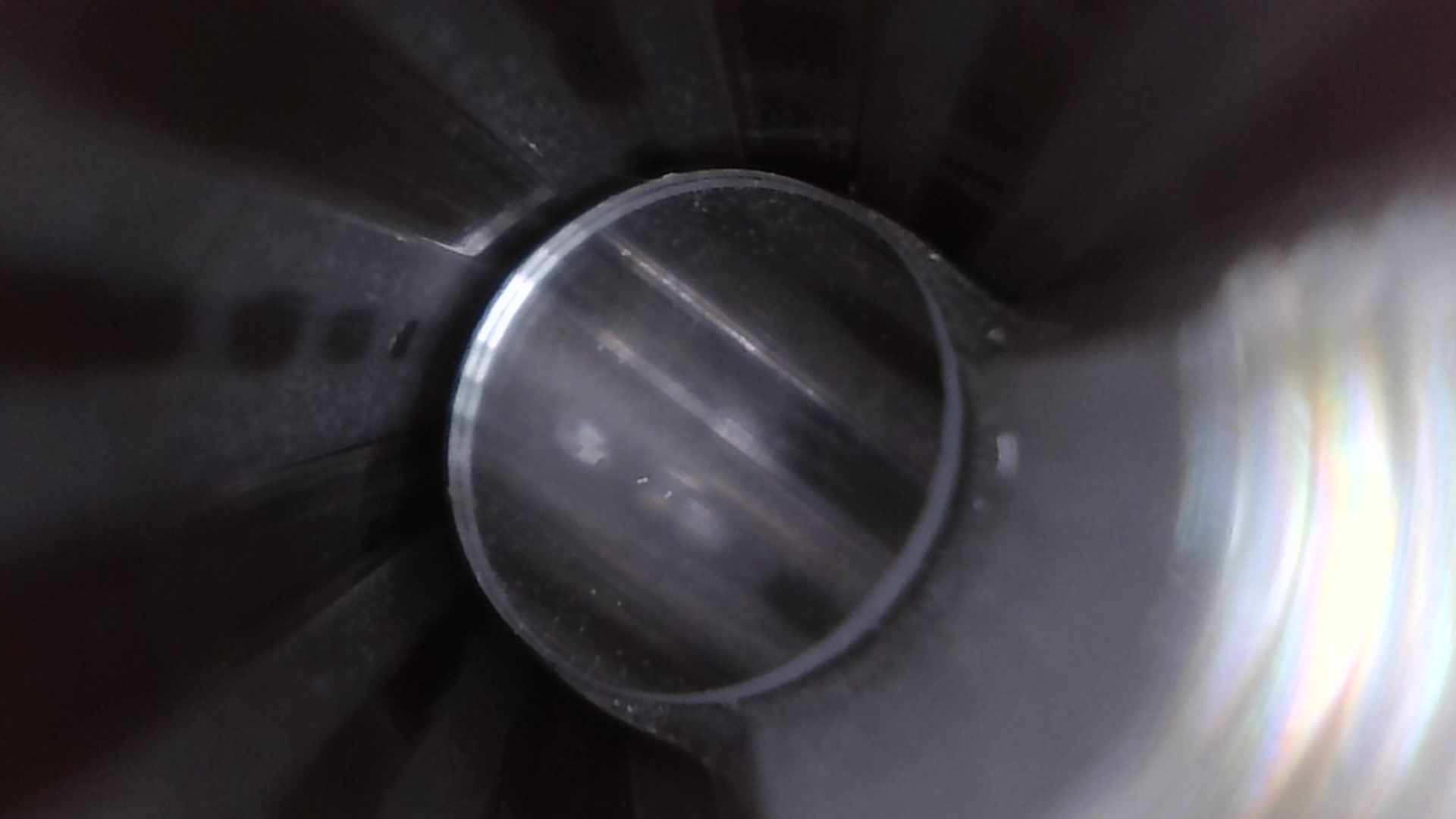

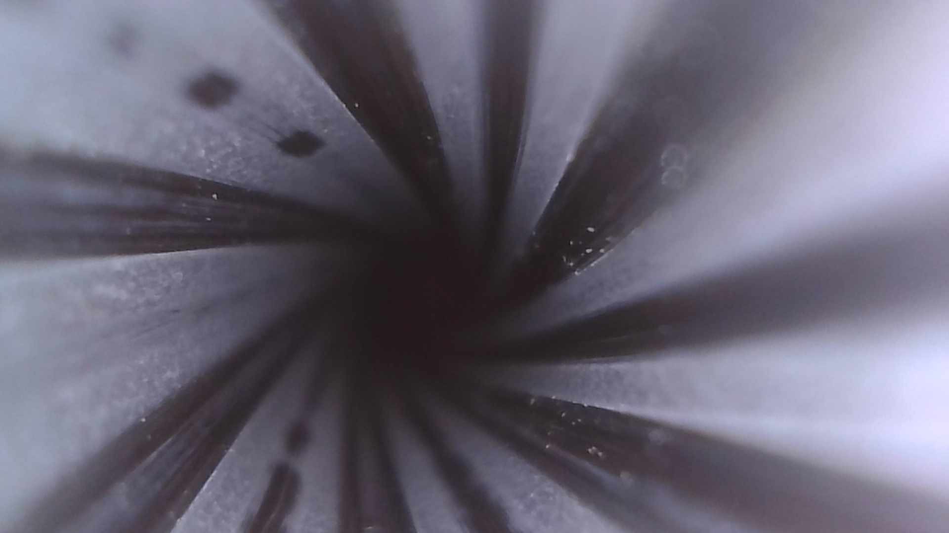

    It would appear I’m not the smartest person and didn’t get photos before I cleaned it all out. I did take some photos tonight of what looks like skipping near the chamber but again I could be and probably am wrong.
    It would appear I’m not the smartest person and didn’t get photos before I cleaned it all out. I did take some photos tonight of what looks like skipping near the chamber but again I could be and probably am wrong. View attachment 8729881View attachment 8729883View attachment 8729882
    I'm not seeing anything alarming but perhaps one of the far more expert gunsmiths/shooters may have some insight.
    If by "skipping" you are referring to those series of what looks like dots in your pic......that's in a groove, right?
